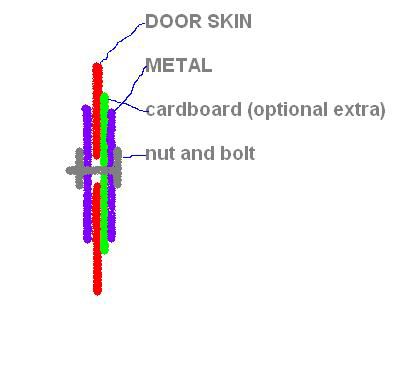

2 square pieces of metal with a hole in the middle and a nut and bolt Wink
cardbord is optonal extra so you dont scratch the paint Wink

Cartoonhead's got a good Idea there if not use filler and just fill it until you can do anything else.,

I'd go with that above quick fix and if you got a round metal like a washer ect it wouldn't look to bad at least it won't have the wires exposed

go with cartoons idea....just make sure you attach the nut from the inside or anyone will be able to undo it. not implying your stupid..did you find any remainder of the barrel??if yo can get a barrel, or face part of a barrel from a breakers you could also silicone that on temp...will look a little less vunerable than metal plate option. hope your travels have been good apart from that incident. let us know what you decided on.

Awesome, thank you guys for getting back to me. Will try cartoons idea and then see if I can order a new barrel to a hostel I'm staying at later in the trip. I'll try and take a photo later of the hole etc itself and also update on how I get it fixed in case anyone ever gets in this situation some point in the future
