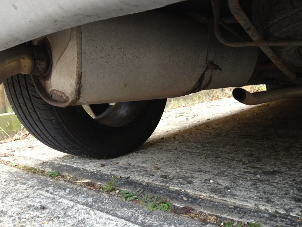

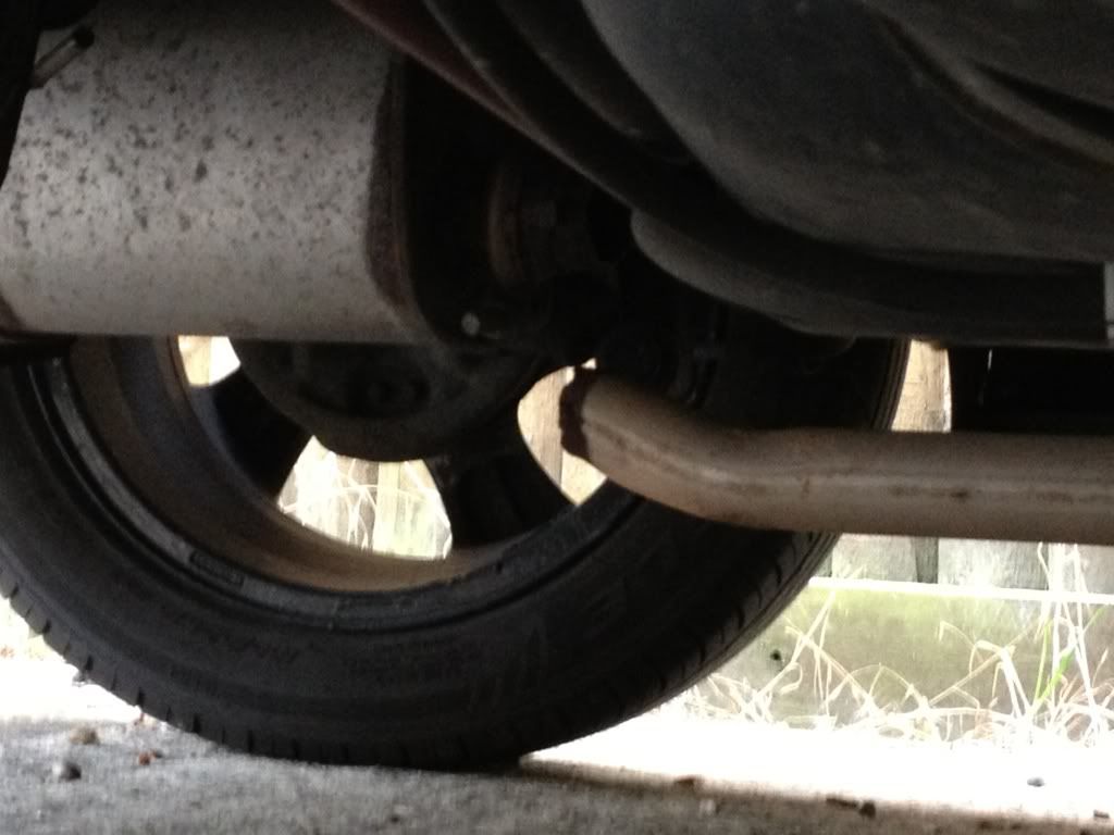

Thought it was weird I couldn't hear the stereo properly...
I assume it's just going to be a new back box?
How unsafe is it to drive till its fixed. Just happened this minute in the drive home.

looks more like you will need the center section the backbox maybe ok
well you could use some wire to hold it all up but personly i would only do that to get me to a garage
on a back road playing

you will use more fuel but if its not scraping the floor i wouldnt worry too much, might get pulled if its too loud but i doubt it.
looks more middle section that will have gone, i would replace the lot tbh

Nah backbox will be fine, just need the middle section seen the exact same happen half a dozen times

poor design on the flanges with the standard exhaust imo

There isnt anything wrong with the design, its the p**s poor material the standard exhaust is made of.

I always thought the back box had the pipe coming out the back attached, so is that bit the middle section.

yes mate the backbox is just the backbox lol the middle section is what go's into said box

Be about £15 for the new pipe and p**s easy to do yourself if you have the right tools.

ah ok, so of these three
www.ebay.co.uk/itm/PEU...257419b1c4
www.ebay.co.uk/itm/PEU...19b3ced0e3
www.ebay.co.uk/itm/PEU...46040899f4
i think its just the £11 one i need but would it be worth replacing the back box too, its pretty rusty!

When you fit a new bit exhaust to old one they never fit right for that long they blow or snap pretty quick. Thats just from my experience tho

bottom one wouldnt fix your problem
go for the top one
