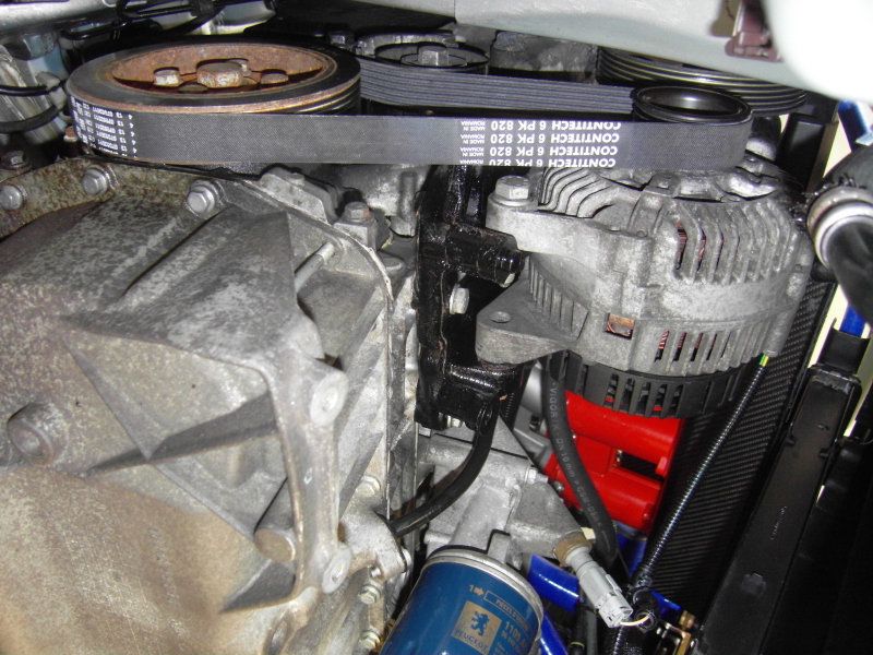

A new shorter alternator belt has been fitted and that means the belt driven PAS pump can be removed. I always intended to replace that rusty looking pulley. I've noticed any engine related bolts on these engines seem to be quite expensive and often come in minimum order quantities.
Also removed the front bumper and the airbox feed into the inner wing because it will never be needed again.

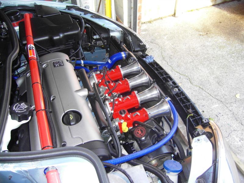

Love the below pic, you'd never think it was from a 2001 206! Plus its helped me understand exactly where and what the torsion bars are Laughing
Edward wrote:
Aegean Blue 1.6 16v Sport

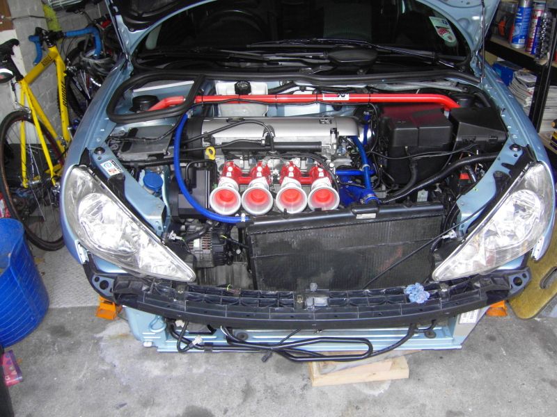

I've also come up with a plan for my radiator. I'm going to cut all the lower part of the radiator fan housing off, just leaving the top 4 inches where it bolts to the car and where the bonnet catch is.
The new radiator can then sit in the mounts that the bottom of the fan housing used to sit in on the cross member. The radiator can stretch right across to the horn and up to the remains of the fan housing. I'll get a fan fitted to the front of the new radiator.

Cool, I got a fan fitted to the back of mine as it gives a cleaner look and there is plenty of room in the bay once you move it all forward.

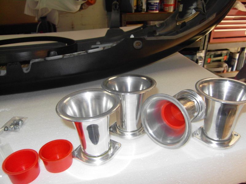

£139.20 for 4 x 42mm x 90mm air horns on order today....would have prefered the 42mm x 100mm carbon air horns but at twice the price it's hard to justify.
If I'm ever desperate for 10mm extra on the inlet, Jenvey sell spacers which of course aren't cheap either!

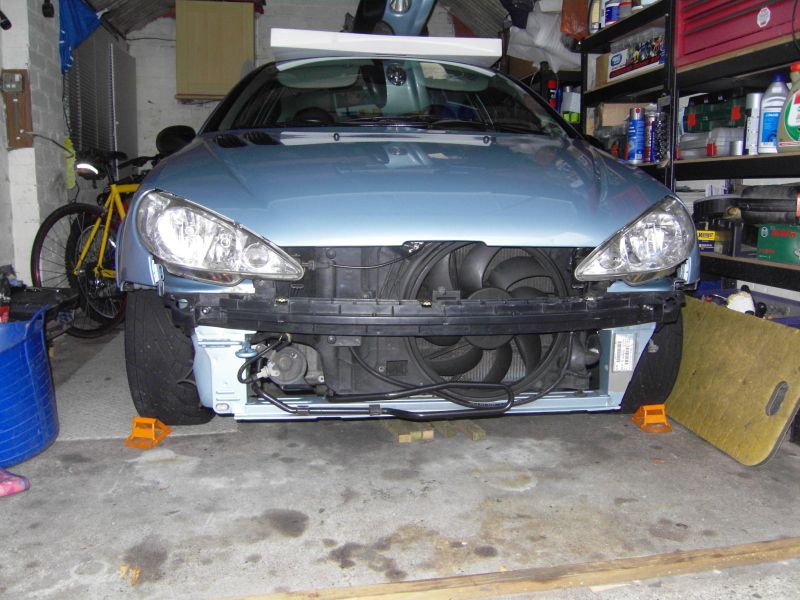

Got my delivery today already! Ordered at lunchtime and it was delivered by mid afternoon the next day!
Might as well remove the fan housing and see how it all fits together. Next purchase is the ITG sausage filter and backplate.
