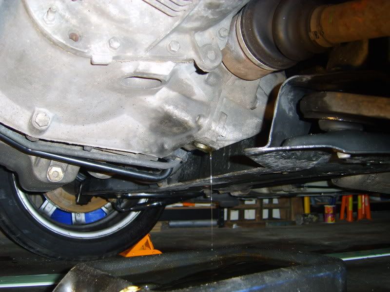

How do u check gearbox oil level and how do I fill gearbox with new oil thanks for any help its much appreciated and anything I can help u with would be happy to help thanks
Use the fill / level plug on the gearbox, that's what it's put there for Wink

Ha ha clever c***t I want to know where it is is it the nut under the battery tray Shocked

Its on the side of the gearbox behind the passenger wheel arch liner, basically fill it through this hole until it starts to run back out. Hope that helps mate
