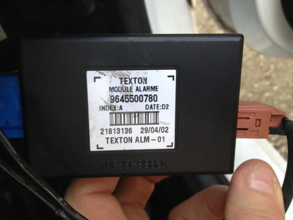

i got told this was the transponder?

so is that NOT the immobiliser transponder???
are the alarm and immobiliser not one in the same box??
Happydays
PostPosted: Sun Dec 23, 2012 2:28 pm Up
The transponder chip is in the key. Tiny black thing about the size of a little finger nail. Very easy to miss. There is an aerial which runs around the ignition barrel which picks up the chip and allows the car to start. You can pick the aerial up from any Peugeot dealer and is easy to fit. (616076 £8.06)
The alarm is a completely separate unit. Some cars left the factory with them, some didn't. Easy way to tell if it's a factory fitted alarm is to see if you have the switch near the handbrake.

There must be more to the immobilizer than that aerial as how many car thieves have the keys???very few but the aerial would be really easy to get around if its on its own...there must be a more active part that issolates cranking or firing of the car or people would just short the aerial out to get it running...
the aerial is obviously a part of the immobilizer but not the gubins of the thing...that will be seperate and possibly in that box and likely part of the alarm aswell...

yeah i see the transponder in the key when i did a key swap, i though the immobiliser would also have a transponder too, and they would link up if ya know what i mean?
no, no switch by the hand brake.
