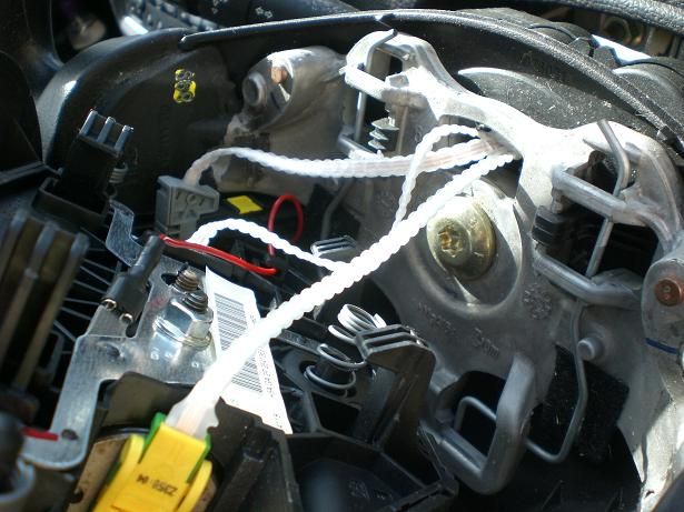

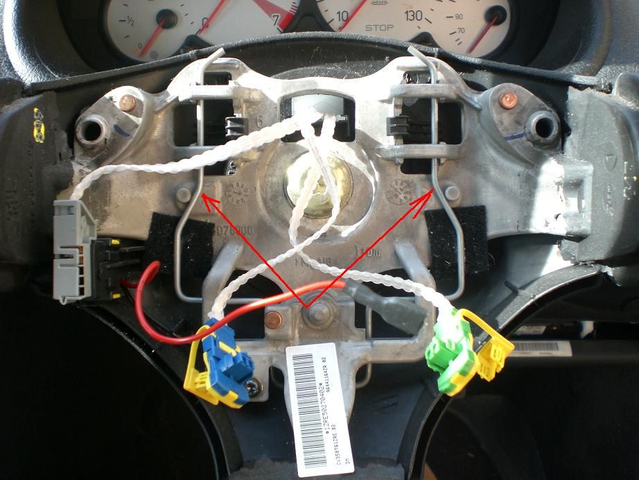

It's quite easy but looks baffling when you've never done it before. The metal "hook" you see is part of a long stiff wire clip. To make it release then you push the metal "hook" up towards the centre of the steering wheel. It'll be quite stiff, I think I used an allen key to get the right angle
You can see the wire clip which when pushed up releases the airbag unit
you can see the two L shaped retaining lower lugs which will be released on the airbag unit here and there are two near the top. The wire clip releases all of them
