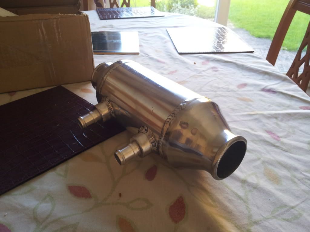

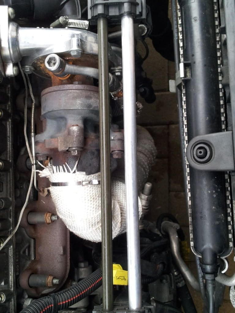

Ordered loads of stuff for the new charge cooler, started insulating the manifold, turbo and down pipe to reduce heat soak as much as possible.

Started insulating the turbo and manifold to reduce heat soak once the cooler is in.

Got a hole bunch of pipe work and fittings ready to put it all together.

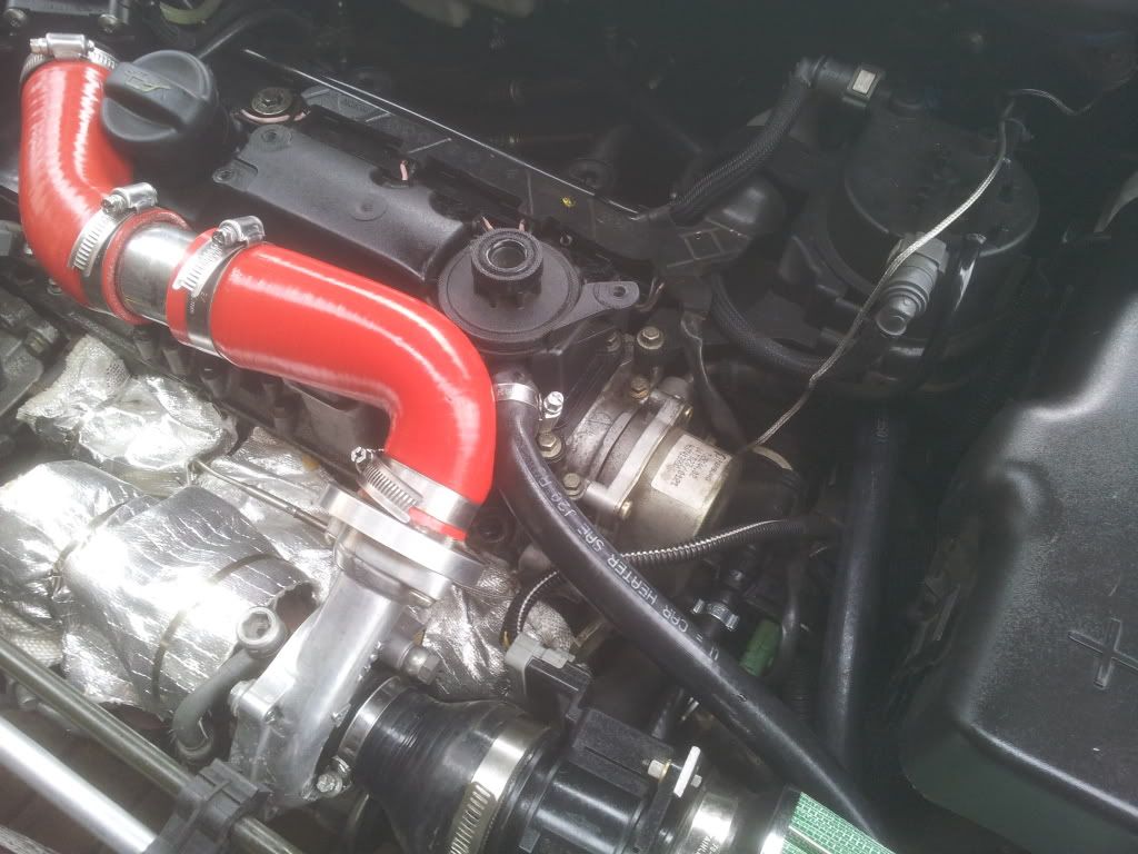

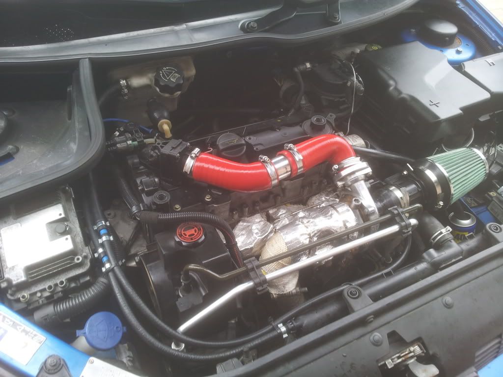

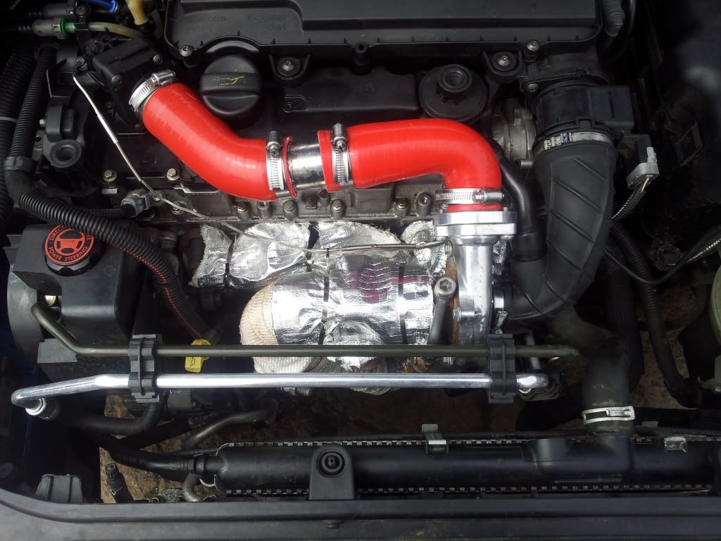

Heat wrapped the down pipe and insulated turbo/manifold

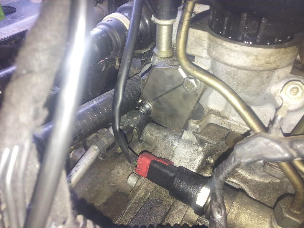

Also completely removed the egr (already removed from ecu). Used a blanking plate from eBay and then made a plug for the inlet manifold.

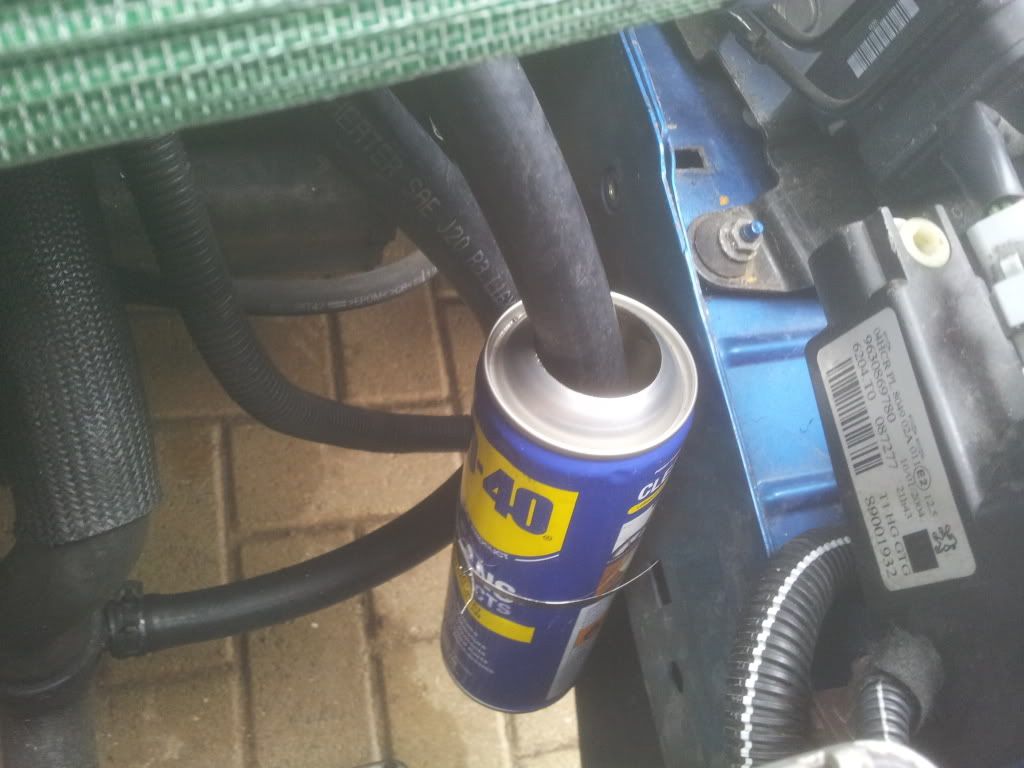

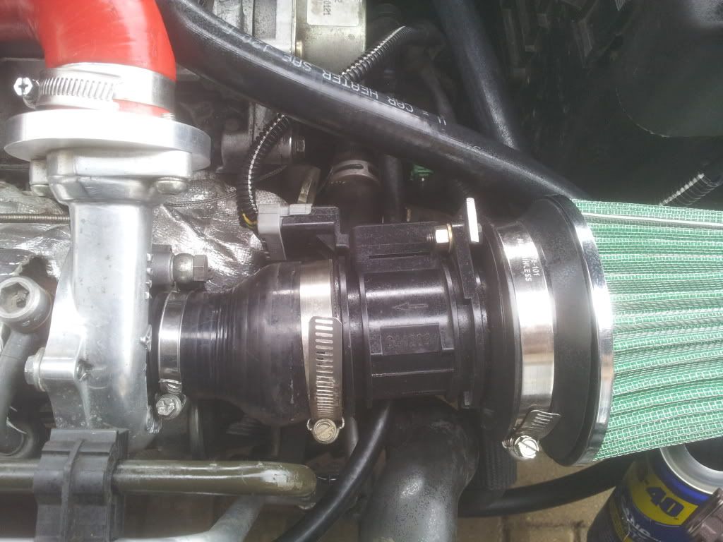

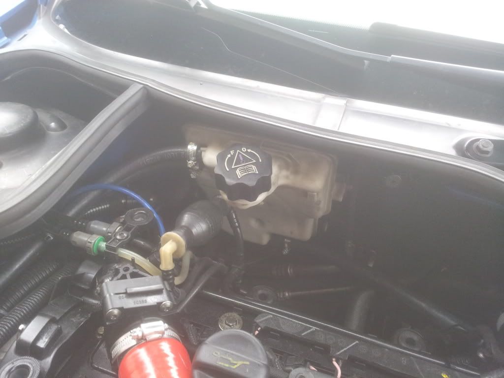

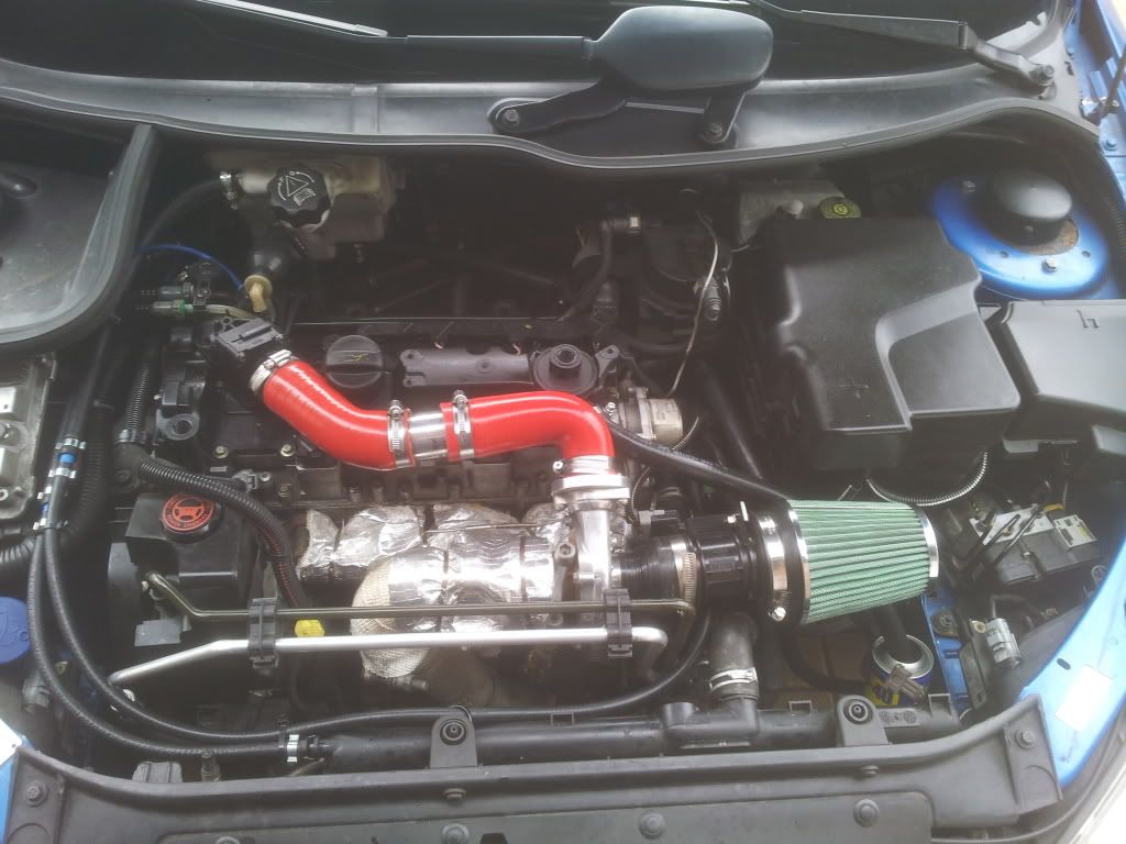

I then wanted to get rid of the air box in preparation for fitting the charge cooler, the only way I could get it out the way was to put a cone filter on. This meant that the header tank would have to be moved. The only option I could think of for moving the header tank was to use the tank from the 2.0 hdi and make up a bit of my own pipe work.
I then found a reducer to take the maf down to the compressor housing and mounted the cone filter with a metal bar going down to the bell housing.

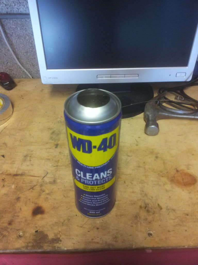

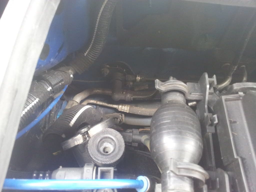

Then needed to sort the oil breather out so made a oil catch tank up and managed to squeeze the pipe in behind the boost pipes.
Thanks for looking, hopefully have more updates soon.

Very cool, how does it sound with the air filter?
307 1.4hdi Smile
14hdi
PostPosted: Fri Aug 09, 2013 4:09 pm Up
Joined: Aug 27, 2012
Posts: 131
Much loader, and lots more whistle to the turbo.
