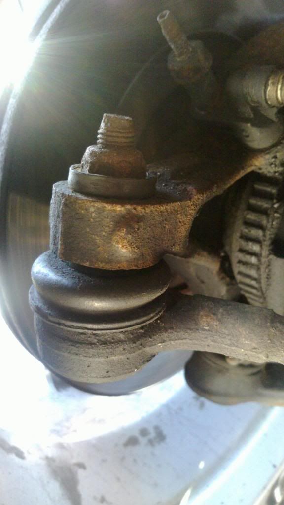

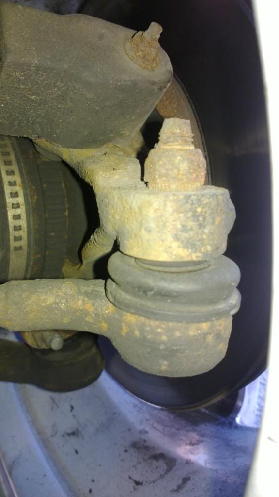

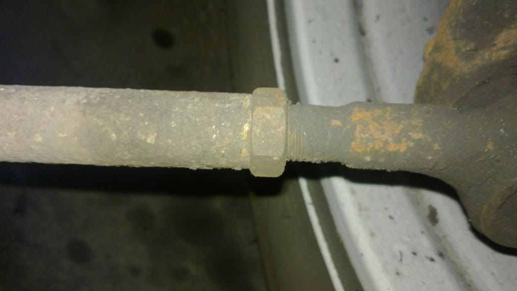

Ok, just tried turning test in the carpark - I couldn't feel the difference. Maybe low speed did not permit to.. (or my brain already compensates the missing bit :))
Track rod ends look as follows (which thread did you have in mind?):
No, will not fiddle with those myself Smile Cheers so far so much!

PostPosted: Tue May 07, 2013 10:11 am Up
Posts: 2949
Location: Athens, Greece
It's not shown on those pics.
It's the one between the locking nut of the track rod arms and the amount of thread showing on the rod-ends as it where. This is just as a matter of interest.
It could be many things contributing to your issue ofcourse, but it will feel and drive a lot nicer if you sort it.

How much thread is visible on each of the track-rod ends (in mm) between the locking nut and where the threads stop?
I will measure that in mm, V9977, but for now here are the images (took them for you yesterday when car was elevated Smile ), I counted about 7 and 7.5 visible thread loops respectivelly:
Driver side:
Passenger side:
