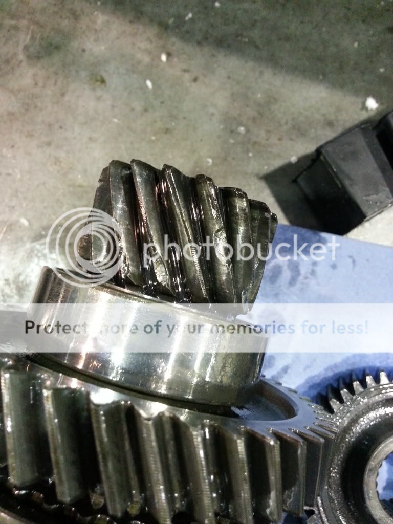

This happens (single gear being final drive/output shaft and sun and planet gears) :
The culprit you ask? Me Laughing
This is the gearbox i recently sold falsely believing it was in good working condition!
How?
Through driving too fast, dumping the clutch and im also having a stab in the dark from the car being excessively lowered causing too much pressure on the gears

Upgraded to a BE4R gearbox which can withstand abuse like this. So im not to worried now! Smile

Yes mate. I would have liked to have thought i drove a car as low as mine slow, but looking at the evidence. I didnt Laughing
If its a BE4, it will fit. But i have a suspicion that it is a completely restyled BE to house the 6th gearbox compared the gti6 which is slapped on the end of the fifth
Why not slap a GTi final drive in it and drop it to a 3.98 as i think the diesels are closer to 4.1
