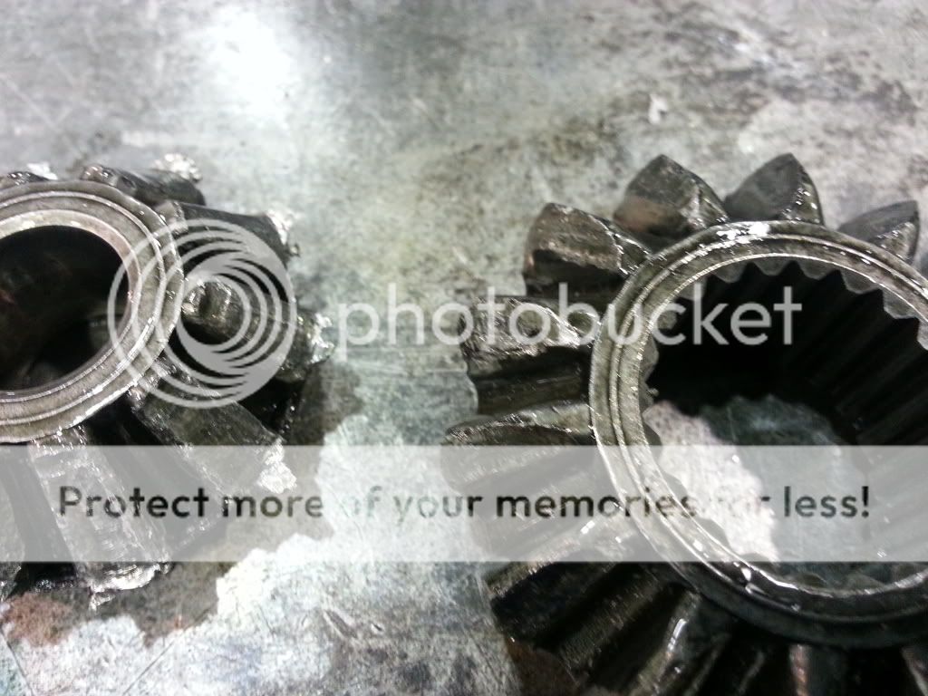

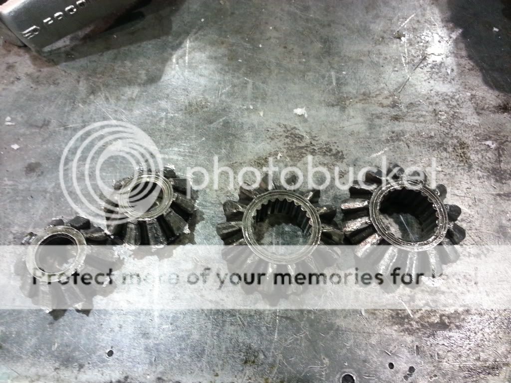

This happens (single gear being final drive/output shaft and sun and planet gears) :
The culprit you ask? Me Laughing
This is the gearbox i recently sold falsely believing it was in good working condition!
How?
Through driving too fast, dumping the clutch and im also having a stab in the dark from the car being excessively lowered causing too much pressure on the gears

Upgraded to a BE4R gearbox which can withstand abuse like this. So im not to worried now! Smile
