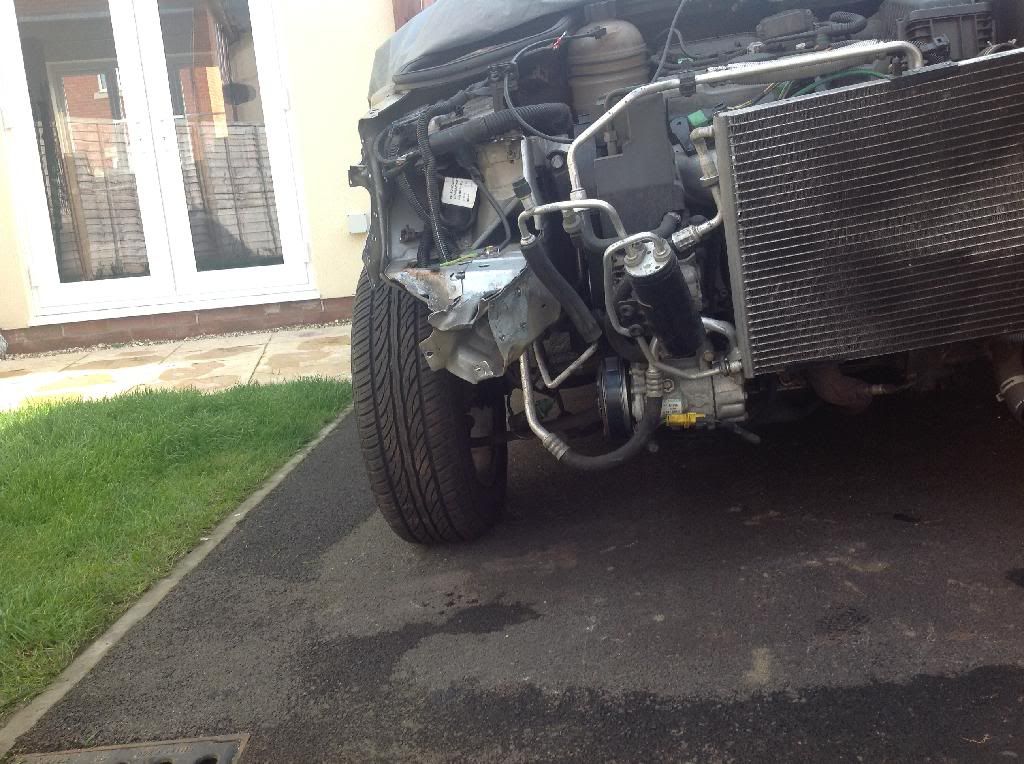

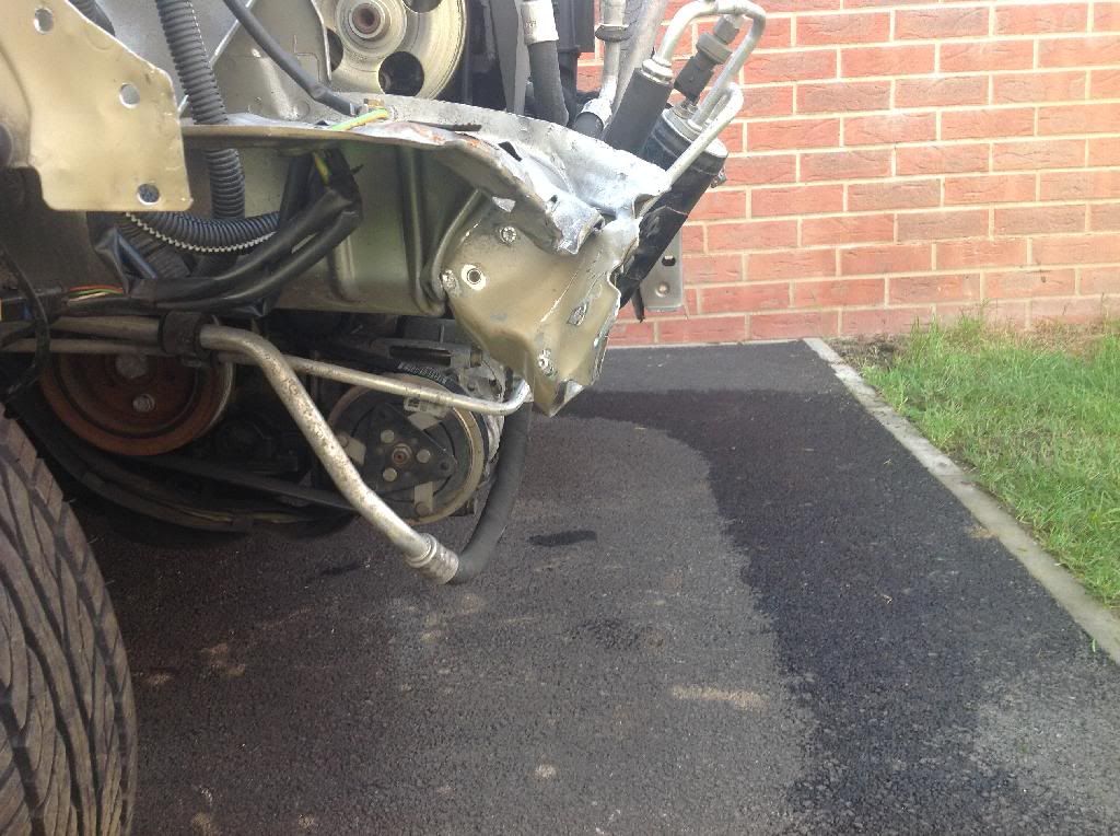

Just a little update on this fix. I've been working in my normal job so progress is leisurely! As you can see, I have now removed headlight housing panel, cross member and the front chassis closing panel ( the one with the towing eye attached to it)
As you can see, the front chassis panel has took a big hit. You will see how it's crumpled. This section is exactly designed to do this. As you can see in the third picture, figure 8. This is the section I am replacing Saturday.
It's spot welded to figure 5 in the picture. So will remove and weld section I've gotten from scrap yard. Obviously the one I've removed has already got the leg and closing panel attached.

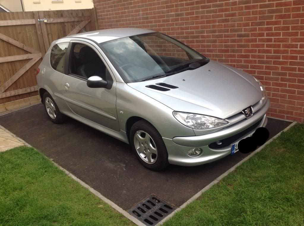

So a update on this thread. I did have other pictures but I kinda lost them. As you can see, the car is nearly finished. Just adding the last touches now. Just need to sort a little dink on the drivers door and wing.
The Bonnet is a state too so I'm looking to replace that.
Been working on her all day today. Removing centre console and other bits of trim so I could clean and remove Dog Hair. In depth Valet nearly complete now. I just need to shampoo the seats and carpet to try and get rid of Dog smell.
She flew through her Mot with no advisories yesterday.
