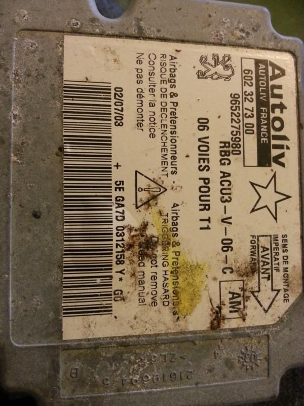

I have a used one out of a 180 that im breaking that i know 100% doesnt have a fault. Would need to know the ecu number though to see if it will fit.

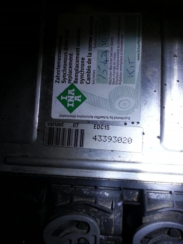

Hi Guys thanks for the responses.
I'm not sure what codes you need but here is a pic of my main ecu and airbag ecu.
Please let me know if you need anything else.
Cheers
