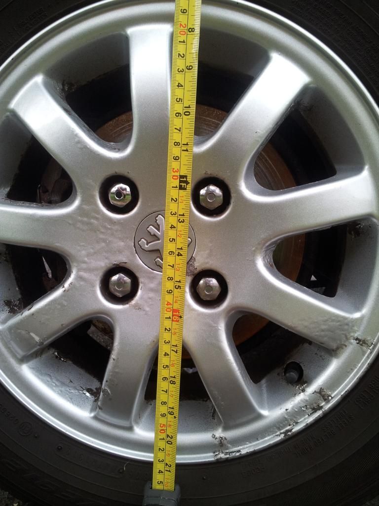

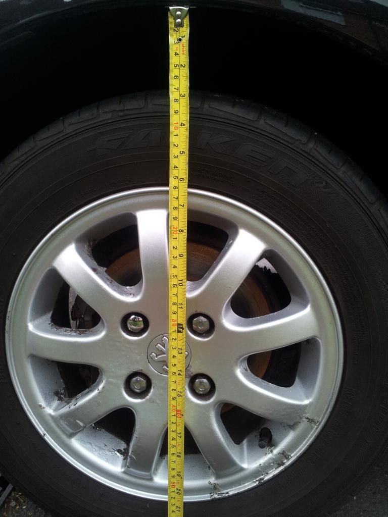

Just measured mine and its the same front and back:
Looks like you too have a wide gap between top of tyre to wheel arch too.
But your tape measure is from wheel arch to centre of wheel. (approx 350mm)
If you zoom out of the picture, so you can see the jacking points. Can you measure the height from the jacking point directly down to the ground?
What do you have?
