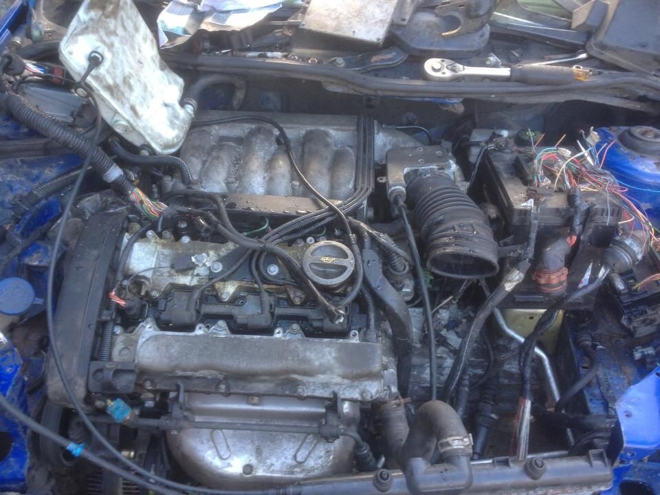

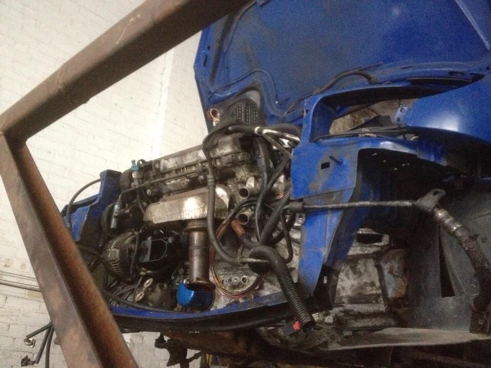

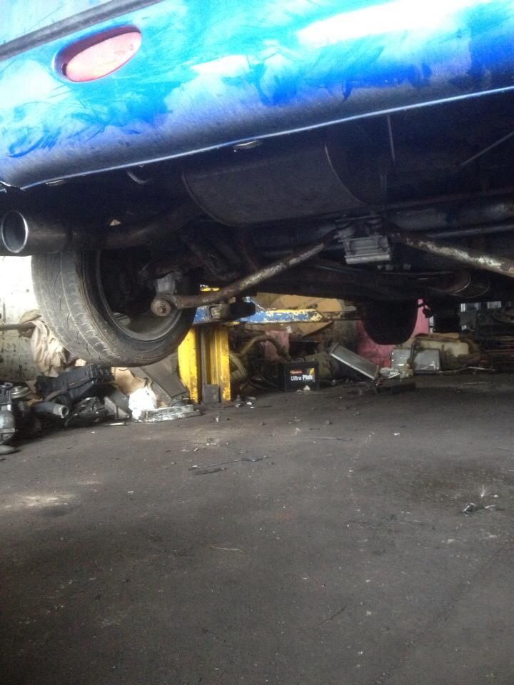

Here is my sw d8 v6 not for handling just noise
Got a bit rushed as we're moving unit not lot pics going to get back in to it this year

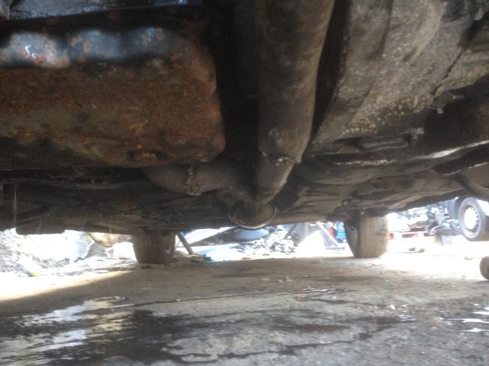

Exhaust need lot work

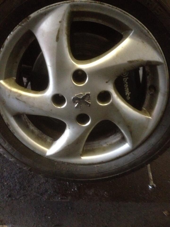

Brembo to get it to stop

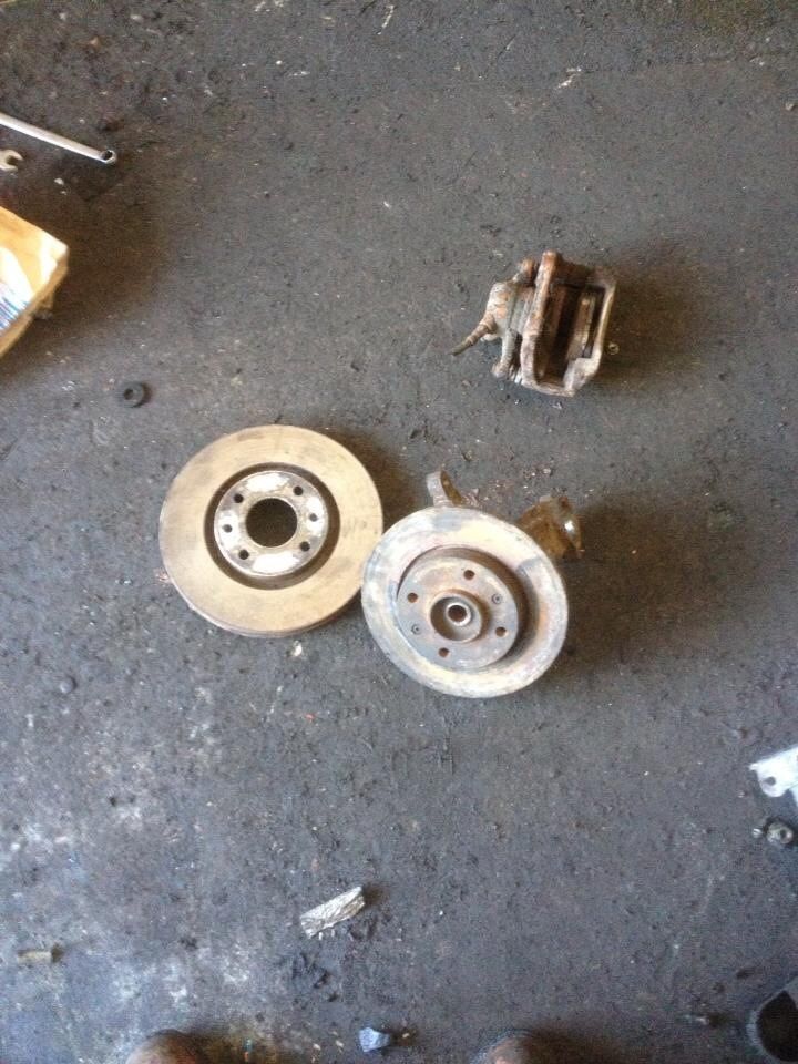

Disk upgrade
Shorting shaft

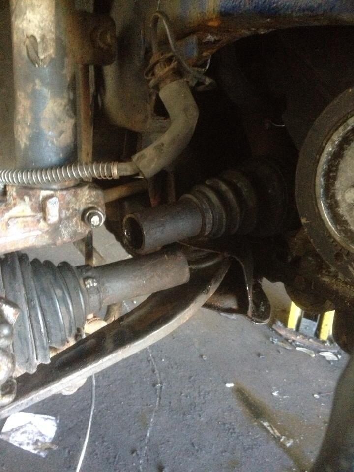

180 stainless and 180 disk axle

I thought it would use standard GTI drive shafts. Isn't the gearbox in the same position as standard?

It not the position of gearbox that's the problem the shaft gearbox side different both needed shortened about 20 to 30mm

Used the 406 coupe ones shortened well twice on driver side as cut it to much lol

No had a pic but can't find it the input shaft to the diff is totally different also back mount in different position. so the long shaft from diff to back mount would be to short

No plus the v6 ones were bulkier better of using them ( I had lot shafts to play with broke lots French cars had a pile at the time )
The way I cut and welded them will be fine some burn outs tests were done lol

Personally i would have used the inner sections of the joint, so they go into the box okay and dont leak then use the 206 outer sections

Would still need cut tried it and 3 litre shafts are stronger as i said I had pile of shafts to play with
