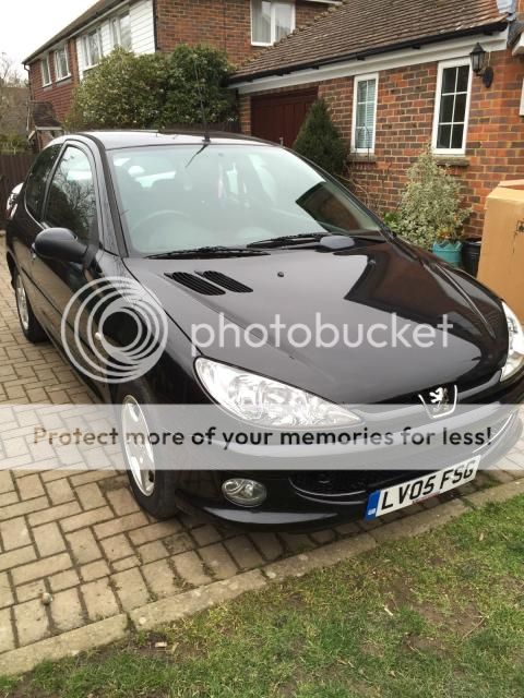

Right just to bring this up again...
am I right in thiknkng that 'sport bumpers' are fitted to gtis/xsi?
what about the little 1.1 sports or cc's? they have a larger grille fitted but the wings don't appear to be flared like the 'sport' wings?
This is the type I mean:
PostPosted: Sun Feb 22, 2015 3:34 pm Up
The front arch liners are what you need when putting a sports bumper on. This is unrelated to what wings the car has. (ie. It doesnt matter if the car had flared wings or not)
