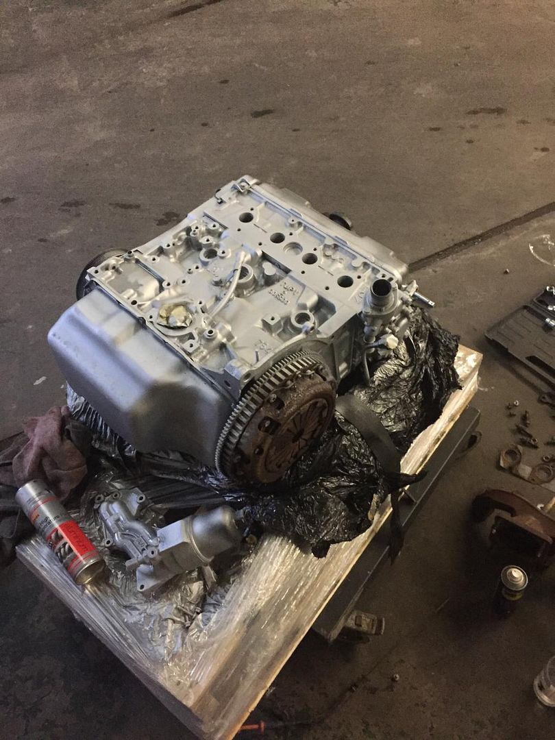

After the headgasket failed last year I had the head sent off to be skimmed. All was fine until a couple of weeks ago when I found that the engine was leaking oil and using water. After taking it to my mechanic friend to see what was up, he put the exhaust emissions probe in the coolant bottle to find that I unburned fuel in there, so coolant has been migrating to the cylinders through the gasket.
Not feeling like sending it off again, I decided to just get a new block. Moral of the story, an engine that has blown it's head will never be the same again. Oh well, at least it is good chance to give the new one a good clean and paint Smile
Any plastics that have been over sprayed will be replaced with the ones from my existing engine

Thimking about it the block may have warped, as they are only aluminium casting on the tu3 and below. Or a liner may have shifted

More than likely mate, so it was best to get rid and replace with one that hadn't been cracked open Smile

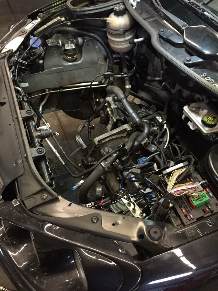

The car is now all back together and back with me Smile
The engine bay now with Cometic head gasket

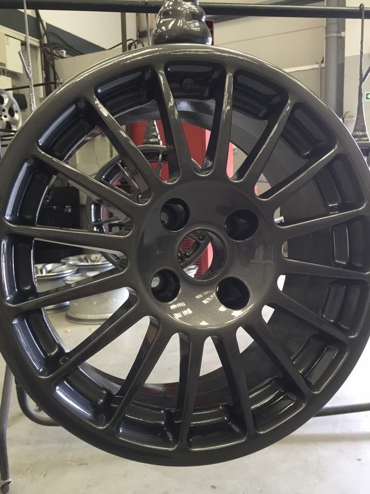

The wheels have been redone recently and I quite like how they have turned out
The car has a dodgy thrust bearing that wants addressing soon, and sometimes it will "hunt" and be unresponsive on throttle at low revs so you have to restart the car.
