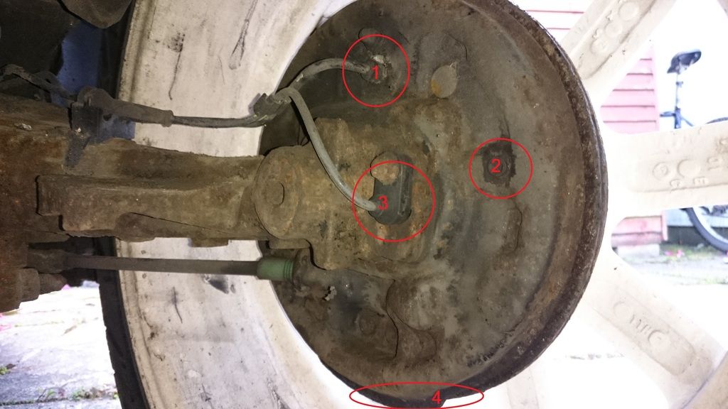

My rear drums need replacing as the fluid has started to leak from where the line meet the drum and two other places.
Can anyone tell me if these Drum Brakes will fit my car.
I own a 1.4 petrol, 54 with ABS
Thank you

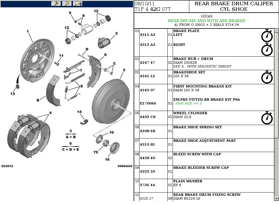

Best to check exact dimensions and the types of drums on this website
You won't go wrong with rear as much as it's difficult to match front pads and disks (e.g. Lucas vs Bosch etc), but better safe than sorry (note red warning the banner on that website, for your vehicle)
If it's leaking through in-between the drum and back plate, replacing those parts won't address the cause of leak (your eurocarparts link is showing only hub+drum - the rotary part, where I doubt anything else fits but the bearing - so I guess that itself wouldn't cause leaks) Check what leaks precisely:

PostPosted: Sun Aug 23, 2015 1:16 pm Up
Posts: 632
Trade Rating: +16
Location: South Coast
Hi.
Thanks for this info, the exploded view has defiantly given me an idea of what else has gone in this drum.
I've taken a pic of the inside of the drum to show where the fluid is coming from.
I've numbered them for easy reference.
Number four is where the fluid is coming out of the bottom between the two parts of the drum.
I think im going to need a whole new unit and not just the shoes and cylinder.
