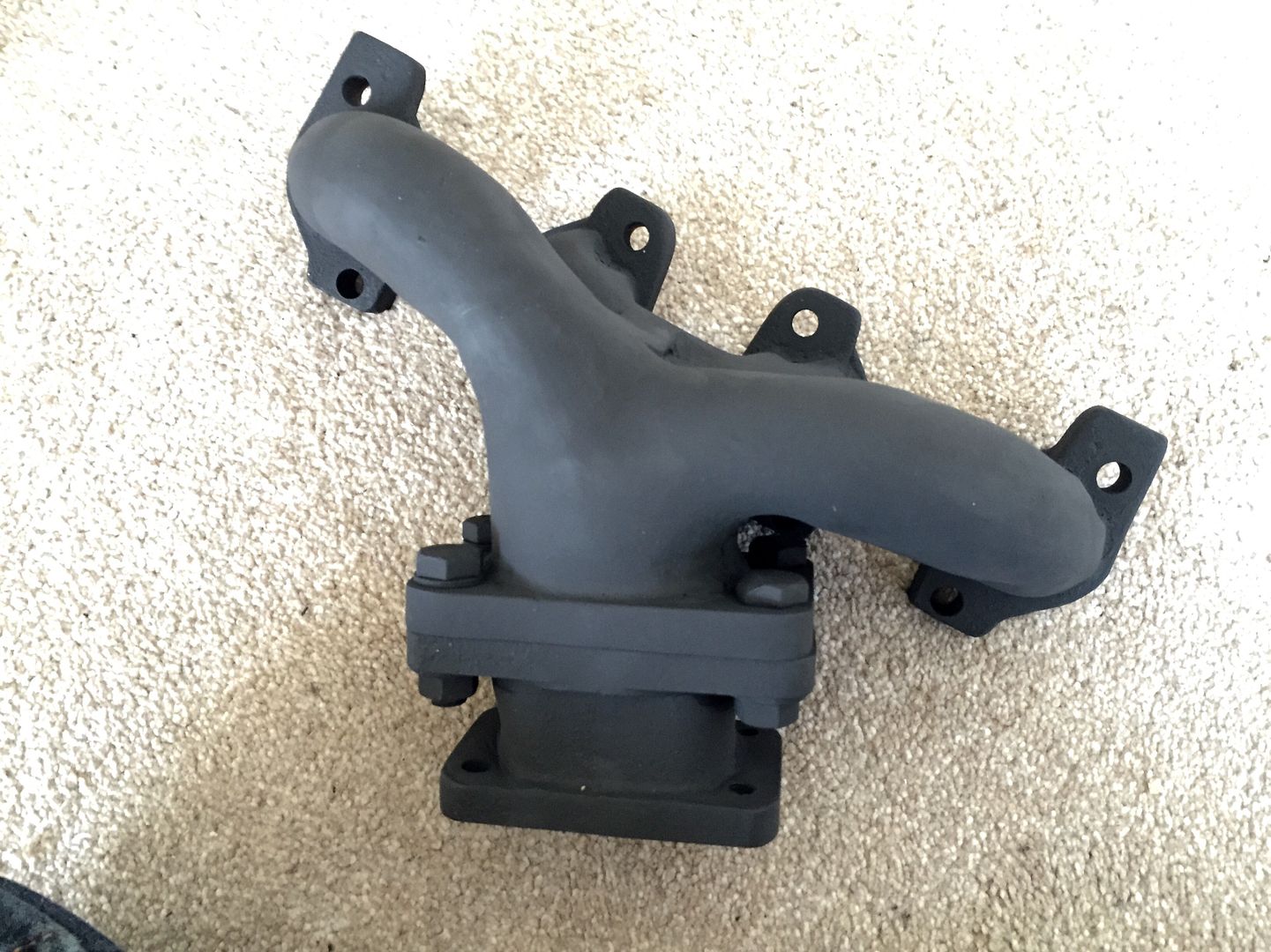

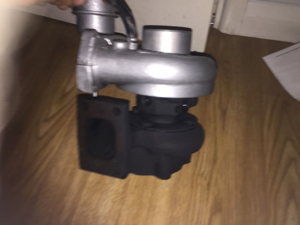

Now I have a standard manifold with T2 adaptor. However I have had to send off for a 1 and 1/4 inch thick spacer plate to bring the manifold forward as the turbo would be touching the block.
My main concern right now is fuelling. Currently the car runs at 15:1 AFR which is too lean. So I must search for an increase pressure FPR and better injectors. But to start, I do not know if my car has a fuel pressure regulator as so little is known about the TU3A KWF system

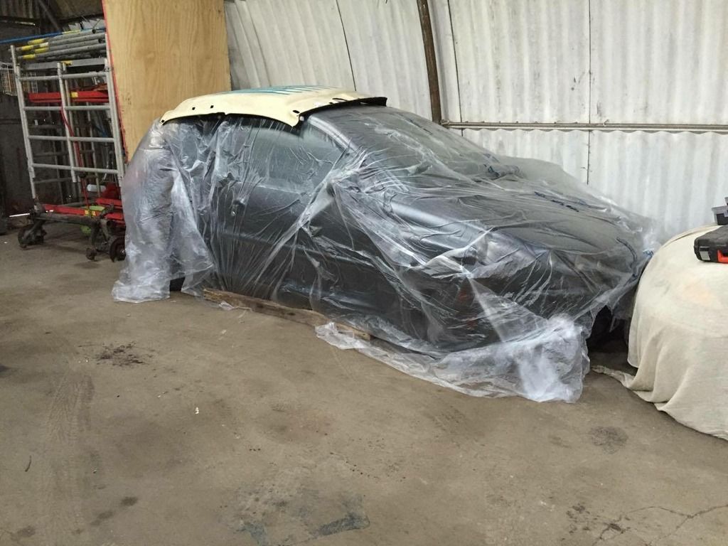

Okay so another update.
The car is now SORN and in storage for the work to begin!
Wrapped up and waiting for my next visit

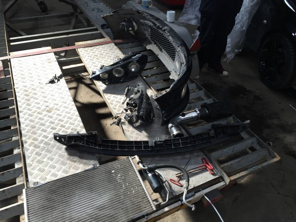

Didn't take long for me to come back and start stripping the front end down.

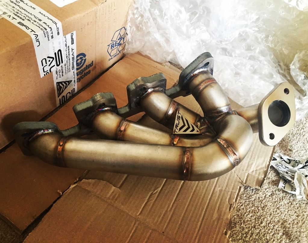

A tubular exhaust manifold to mount the turbo has been ordered.

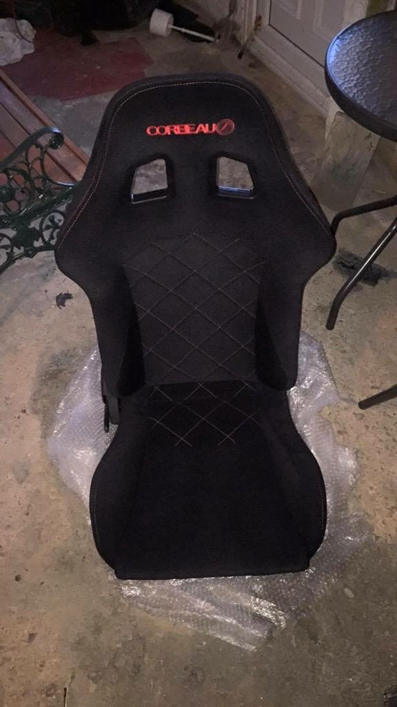

And today my custom order Corbeau seats arrived.

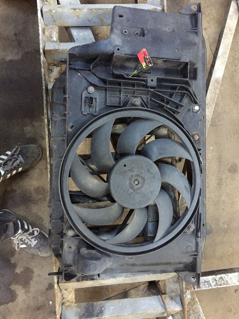

I am thinking of completely doing away with the entire fan housing and using a slim line fan with a thicker core radiator. It's possible for me to have a front crossmember piece fabricated to attach the standard bonnet release system to, and mount the top of the radiator. This is all done to create space for the turbo charger, intercooler and oil cooler system.

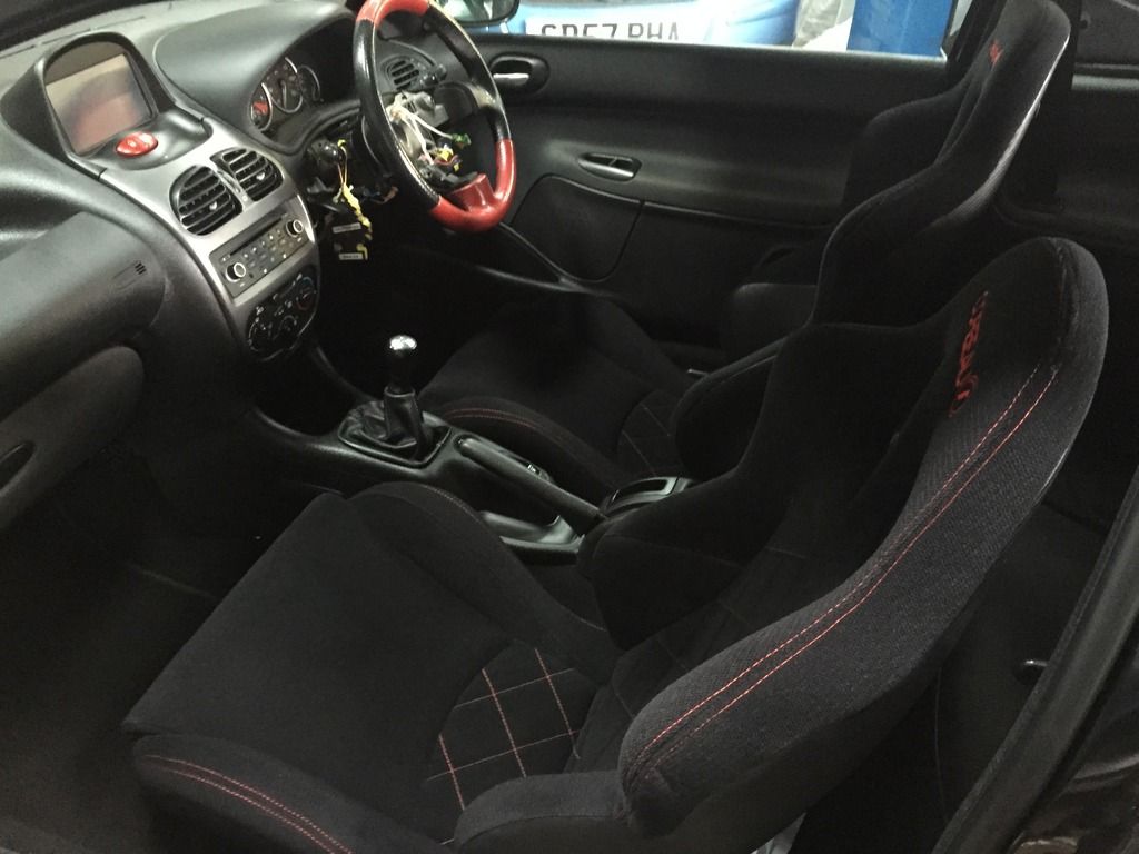

The Corbeau seats are now in the car. They are comfy as f**k!

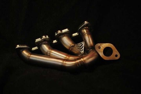

And my SAS/Trust Tubular Manifold is now here. Next up on the shopping list is a turbo rebuild kit and billet compressor wheel - when funds allow!
