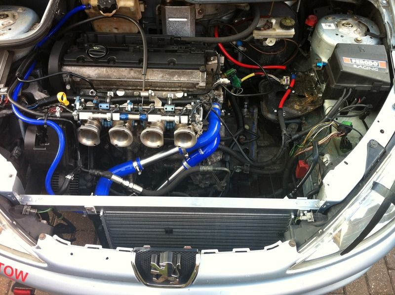

The new radiator setup. Golf GTi rad, shorter height than the original so we can try to get some cold air into the throttle bodies. Had no problems with cooling at Snetterton testing last week or at Rockingham, showing around 90 deg during track sessions.

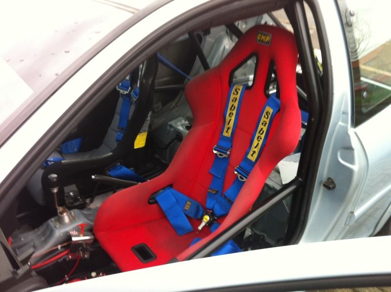

New race battery, smaller and lighter than the original and means I can now fit a passenger seat for trackdays. Also cut some weigh out of the bonnet and tailgate and scraped off some more matting from inside the doors, weight should be around 915 KG.

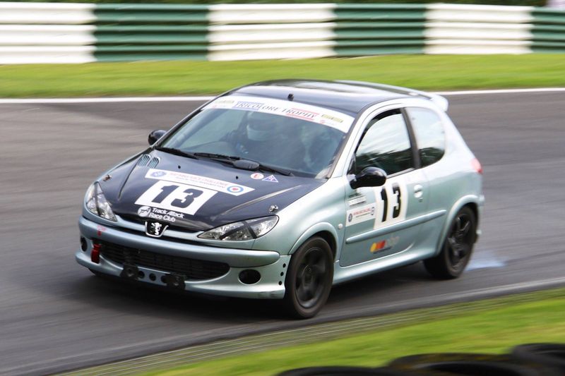

Beautiful weather in Lincolnshire for my first visit to Cadwell Park since 2009. Qually was eventful, I suffered brake problems resulting in running straight on at Mansfield, and a spin at the Old Hairpin. Pretty happy with 8th on the grid (5th and last in class), with a 1:48.65, considering the problems.
Race 1
Got a good start, side by side with a Clio around the first three corners, with me eventually pulling in front. Broke away a little bit and ended up in a fairly lonely 6th place (4th in class) after another car withdrew. Didn’t push too hard as I still had concerns about the ability of the brakes to go the whole race distance without boiling the fluid. Fastest lap 1:47.14

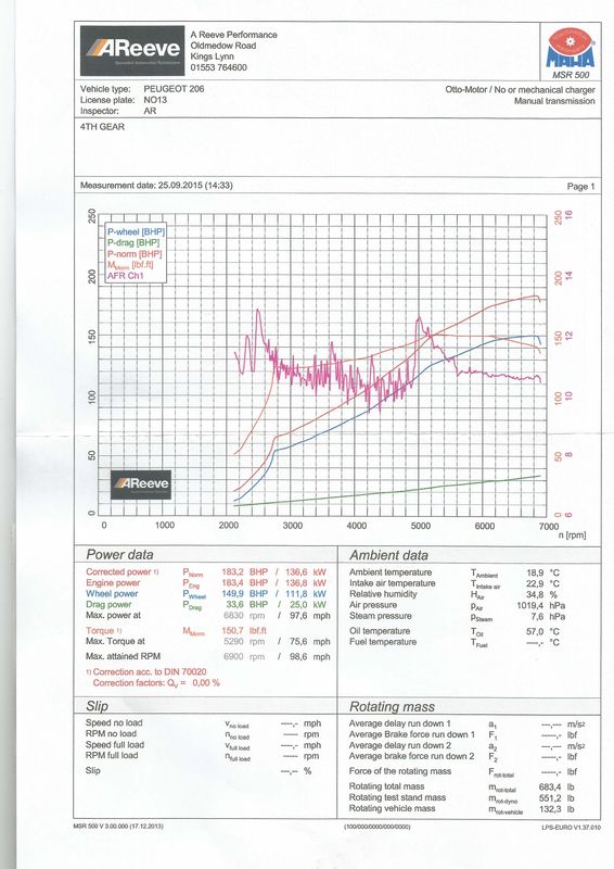

Had the car on the dyno for a power run yesterday at A Reeve Performance in Kings Lynn. I was told it was around 175bhp when I bought it, so it was a nice surprise to find it over that, with dodgy fuelling and an engine that's down on compression (100psi v 125psi back in April). It was still making power when it hit the limiter at 6800rpm. Better fuelling and a stronger engine with a few more revs should see 195-200bhp. Really need to find out what profile the Newman "Custom" cams are though. Thinking of putting the 138 head onto a 180 bottom end, does anyone know the CR would be?
