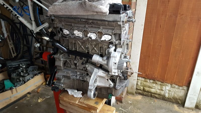

img42.com/Cm43h
The marked one, seems to be a rubber hose that the hoses going to the heater matrix come off. The only similar one that pug could find is a metal replacement. Baffled.

PostPosted: Fri Nov 25, 2016 5:32 pm Up
Posts: 7047
Picture doesn't work.
Dave82517

Location: Barry, South Wales
s11.postimg.org/h1jypr...508160.png
Try this. Stupid image hosting.

PostPosted: Fri Nov 25, 2016 6:37 pm Up
Posts: 7047
That pipe you've put the line on is metal. It's the black one across the back of the engine below.

PostPosted: Tue Nov 29, 2016 8:15 am Up
Joined: Apr 12, 2010
Posts: 116
So it was a metal pipe was just so badly degraded it was pretty muj soft to the touch. Managed to get by with just removing the battery and box. Cheers for the help.
