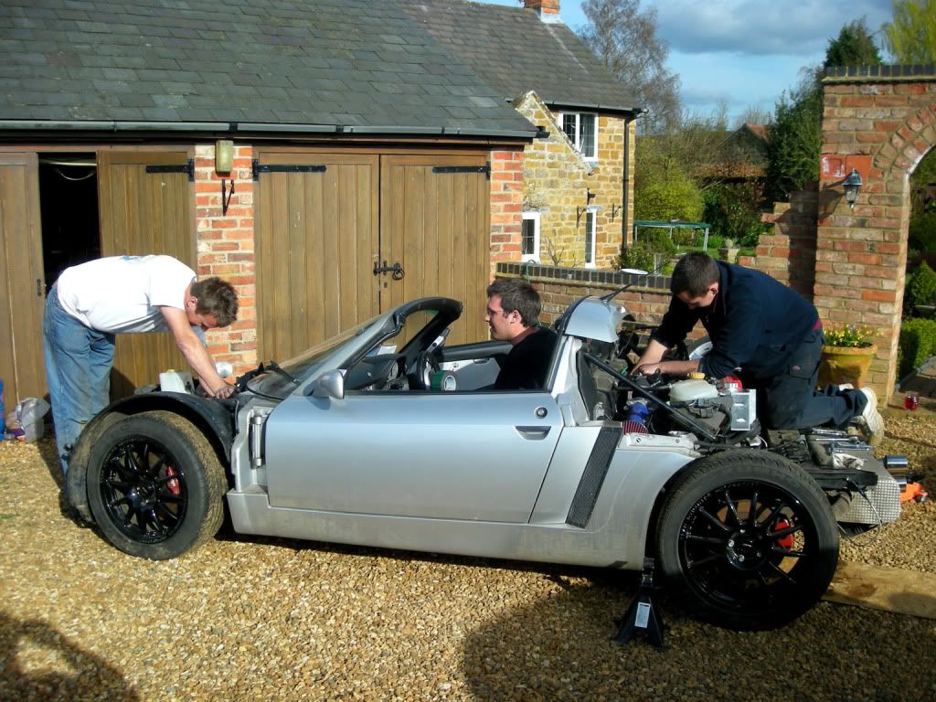

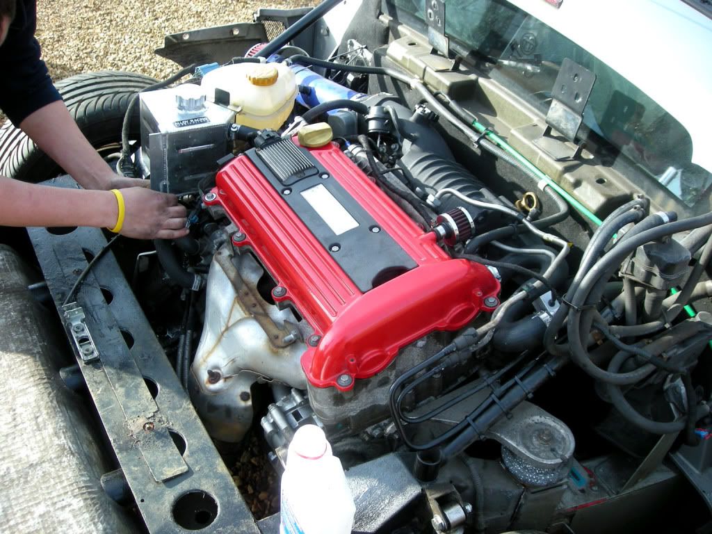

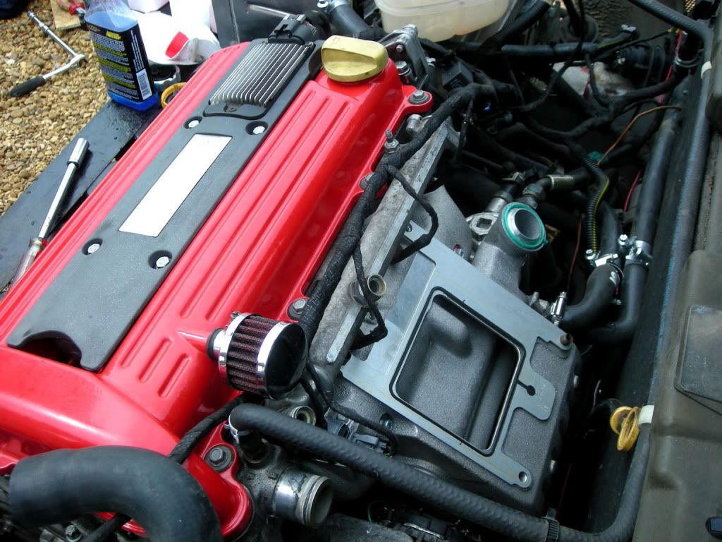

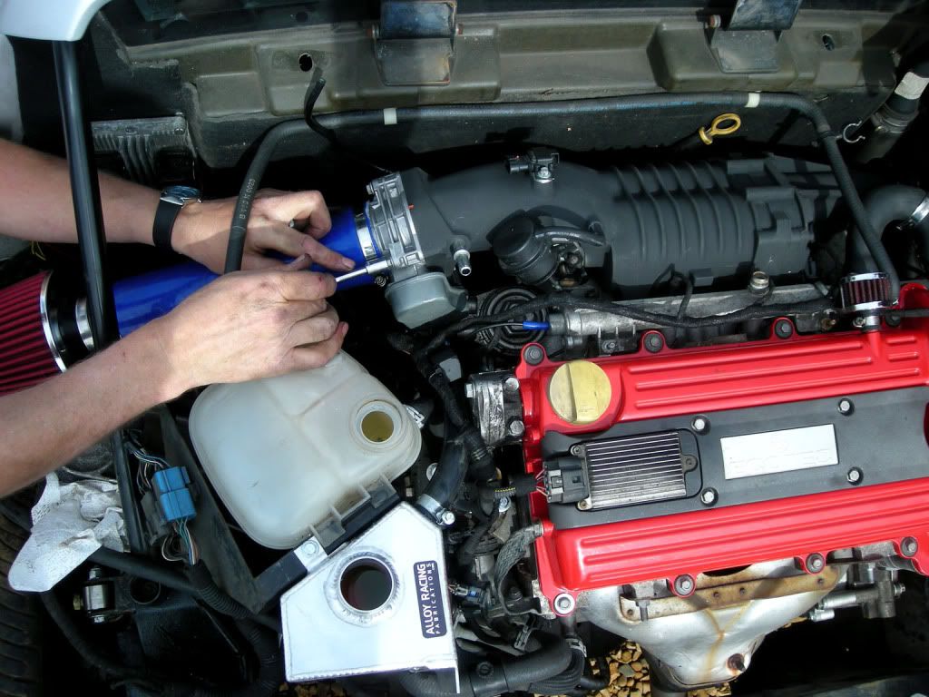

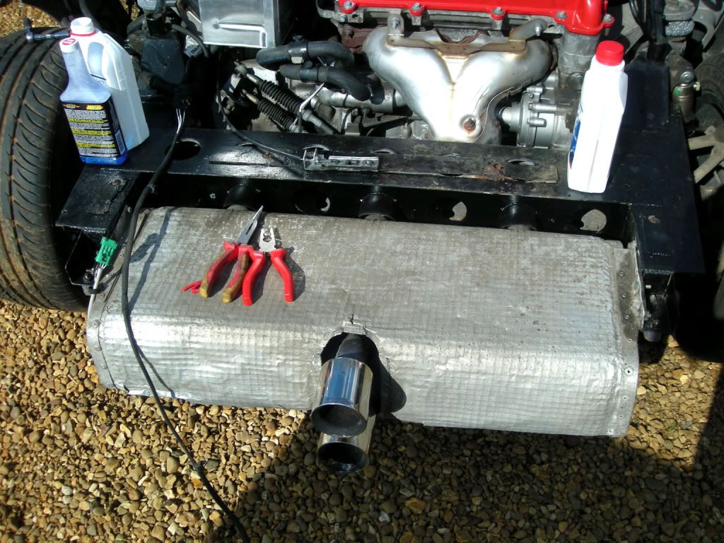

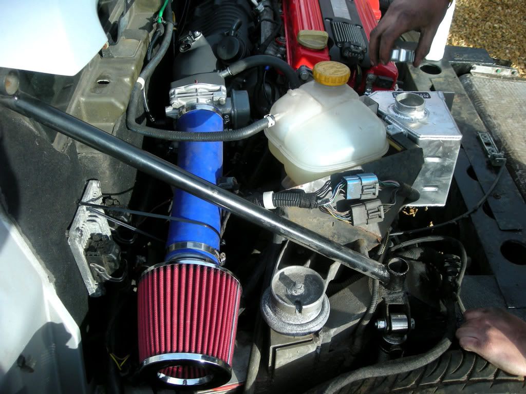

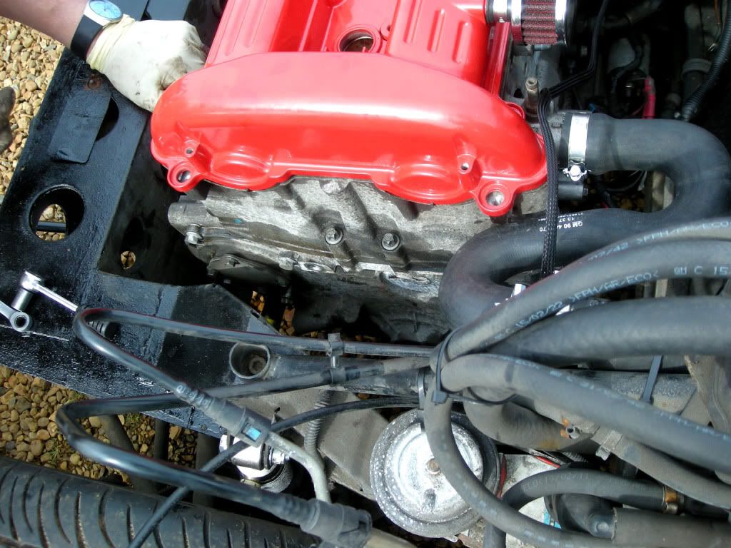

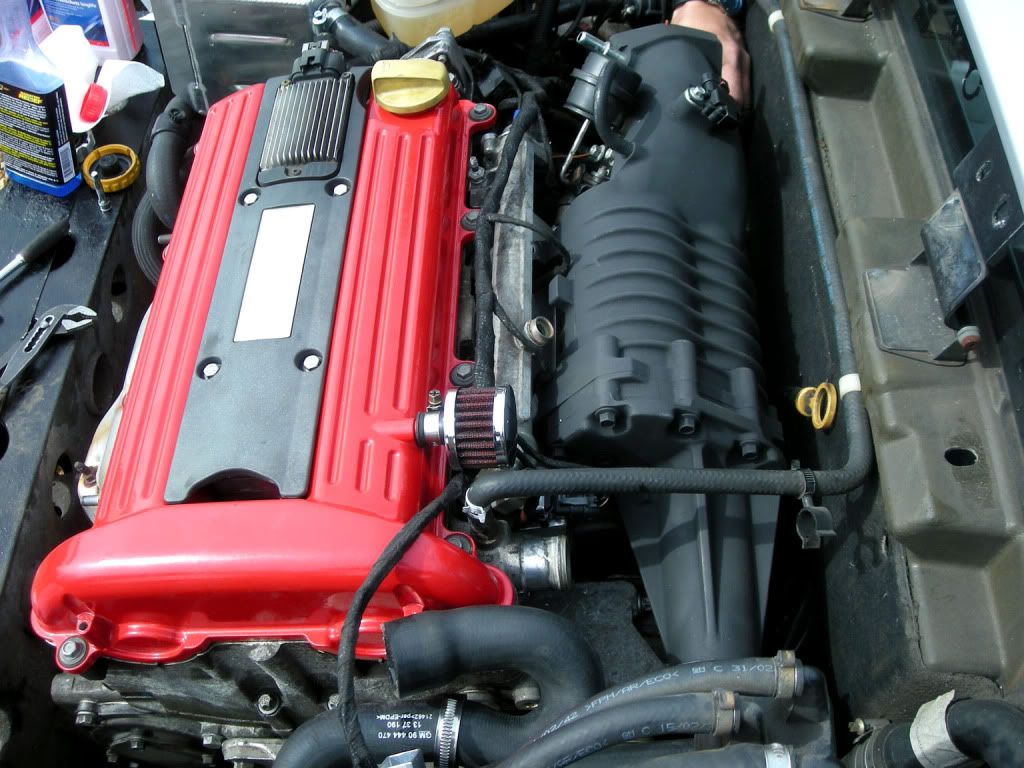

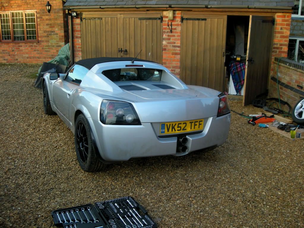

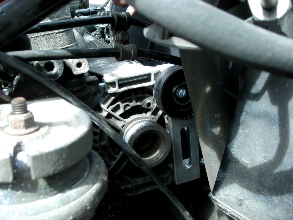

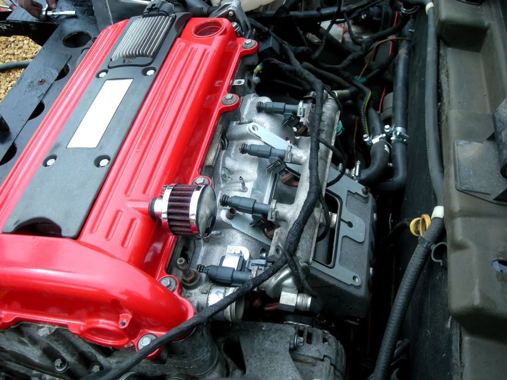

So unbelievably tired now, but an update all the same:

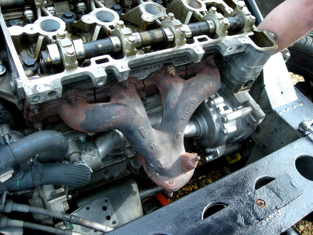

First job was to pop on another exhaust manifold as mine had a slight crack in it due to them fitting a small 'precat' after the manifold which causes it to warp shortly after cold starts.
Timing chain on and rocker on properly:

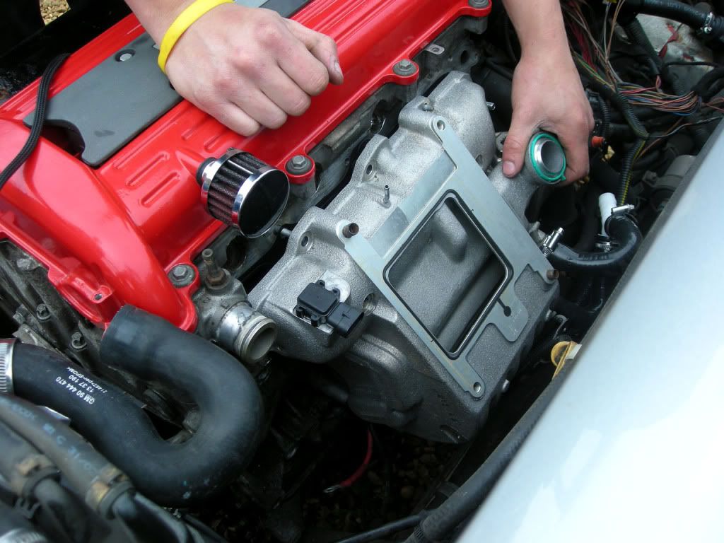

Inlet on:
Alternator and custom made idler for the charger belt:

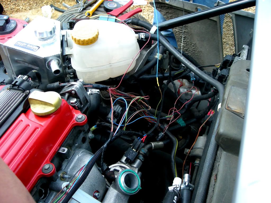

Wiring to be sorted:
Sorted!Injectors & fuel rail on. Tried to keep as much of the 'factory' look as possible:
Into the block:
Chargecooler pipework:
Charger on:
Filling up the coolant systems and attaching the throttle body:
Milltek and heat shield on:
Bleeding the systems:
All of us three working hard:

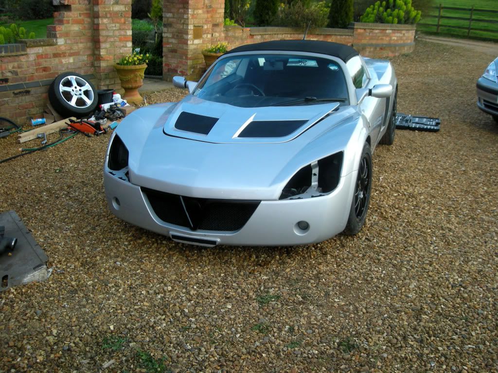

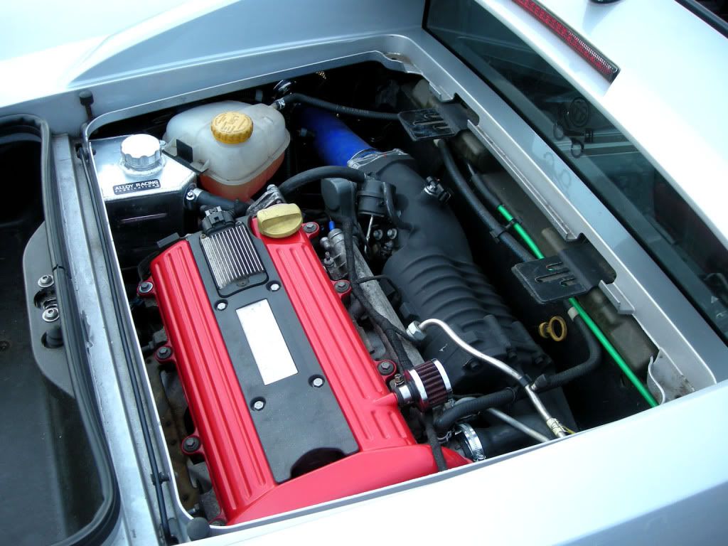

Most things back together:
Rear clam back on:
Lights in:
Tomorrow I'll finish the rest off, fitting the front clam, the interior back in, and setting the coilover ride heights.
