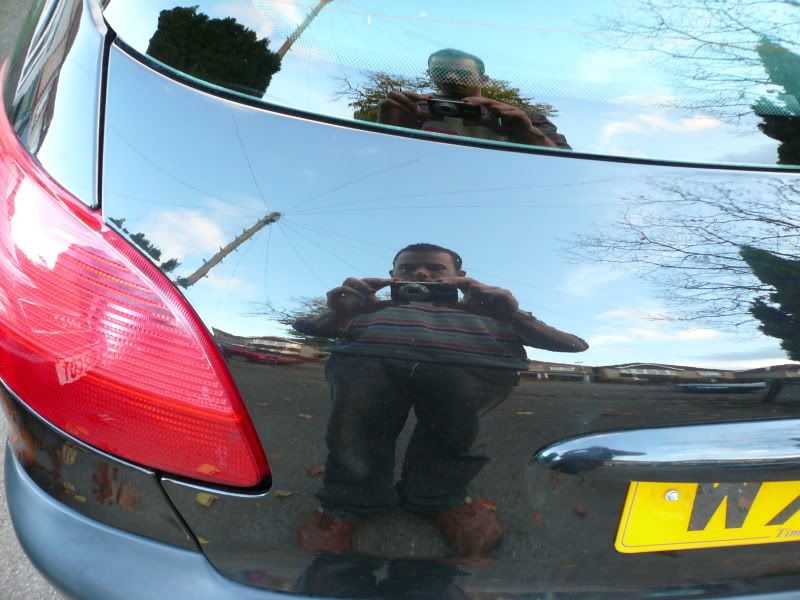

The rear quarter panel and bootlid had been re-sprayed:
