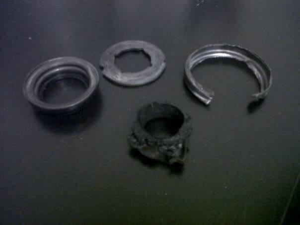

chunkielad
PostPosted: Mon Jan 17, 2011 5:38 am Up
Joined: Jan 02, 2011
Posts: 286
Location: Leigh
At least this isn't inside my clutch anymore...
It had worn though half the springs on the pressure plate and was about to go through the last few.
