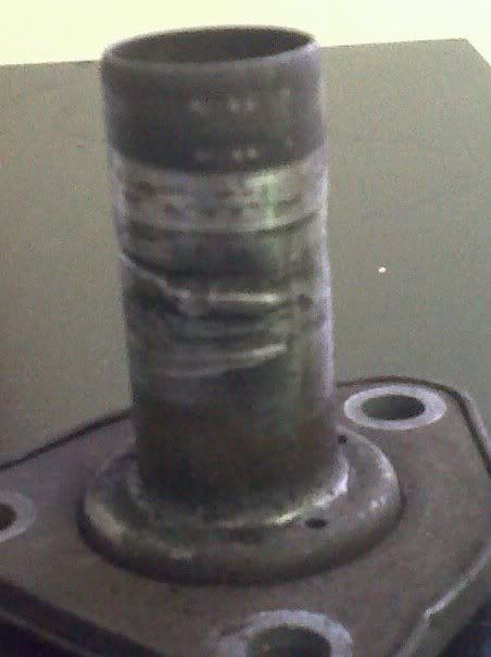

My bearing failed in a spectacular fashion. Squeeled once then next time I started the car it was fine until this....
and it took the trumpet out for the grear box input shaft too....
Do yourself a favour and get it swapped out - do the clutch as a 3piece kit as it's a pain in the ass to do so better to get it all done while in there. My bearing had also eaten into the pressure plate springs so had to replace it all anyway.
