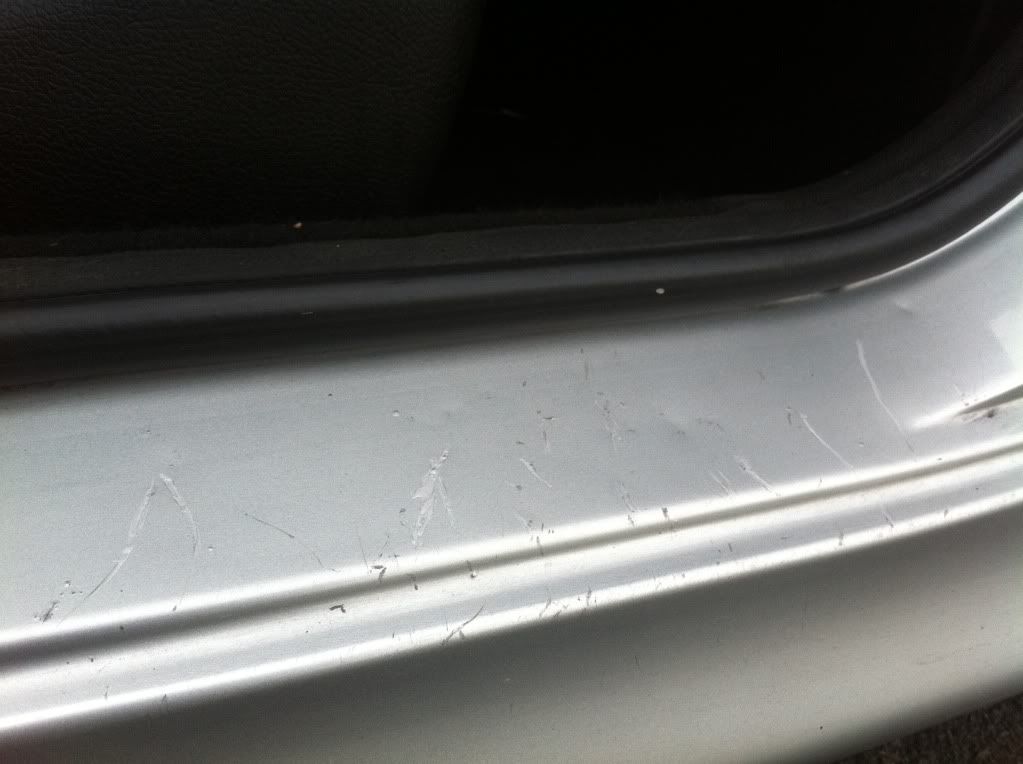

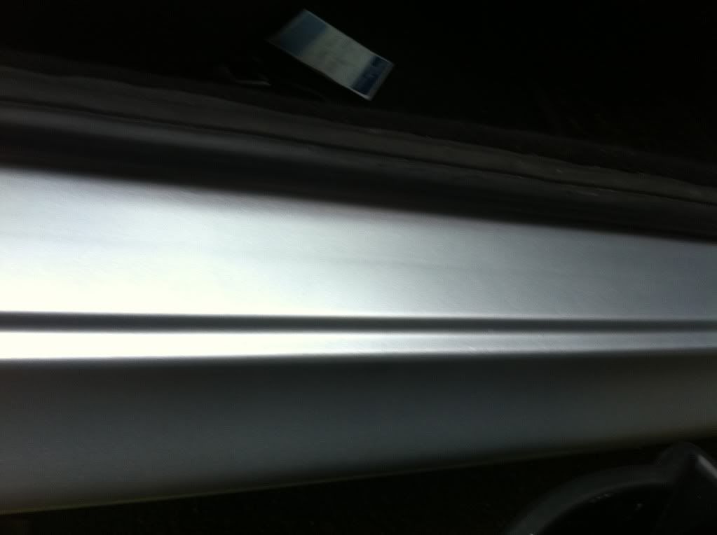

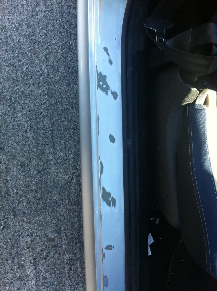

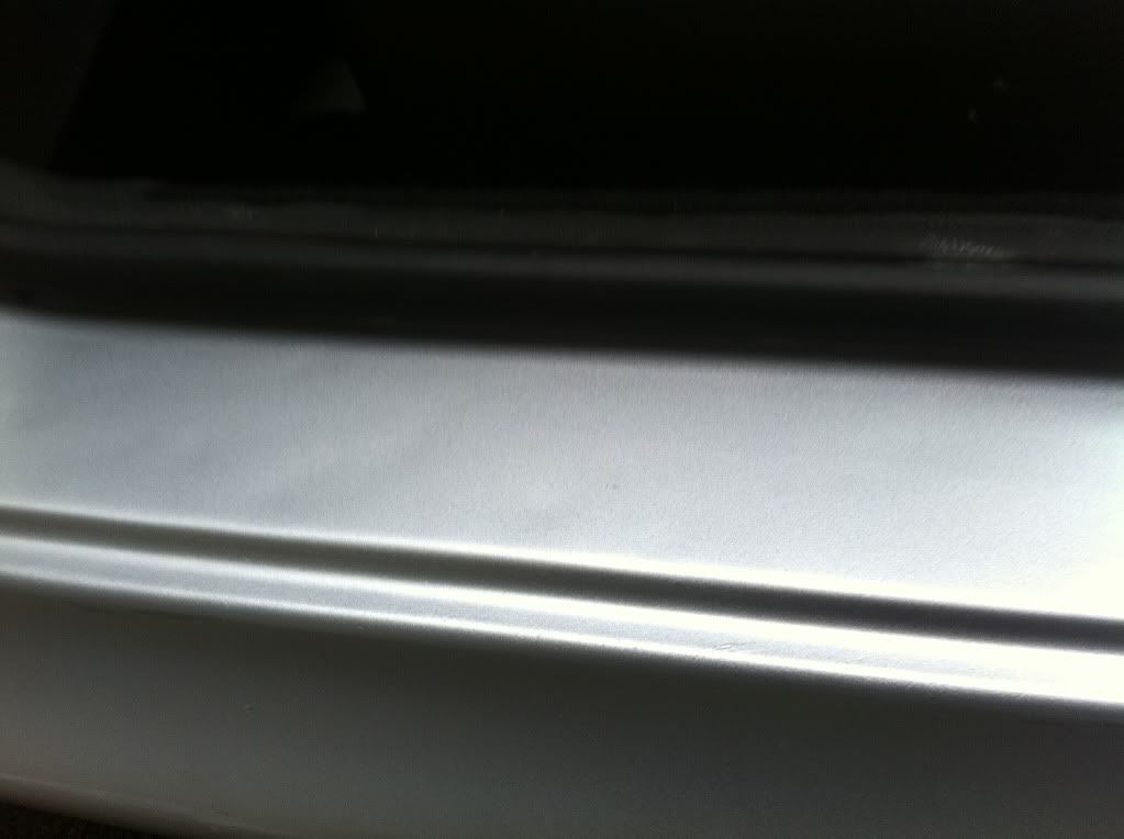

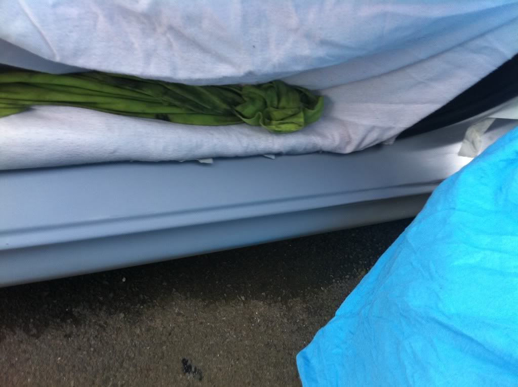

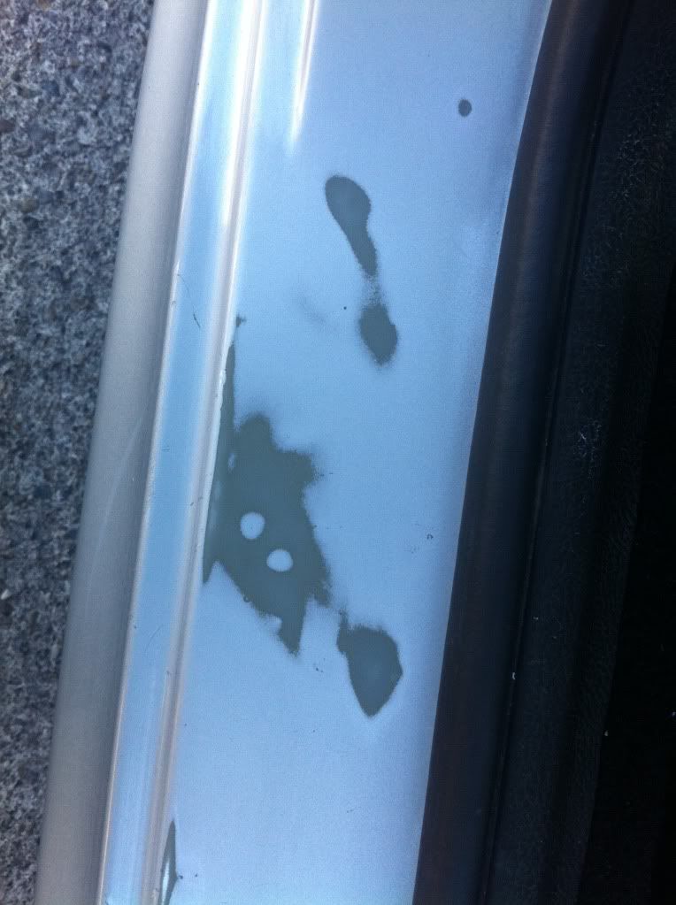

Posting Pictures of the first spray job ever on my car! Decided to start with the door sills incase it went wrong! looking pretty good, and no stupid scuff marks !! Very Happy very happy!

haha, i cant take the glory, my boyfriend did it, first time spraying on the actual car though! He was showing me how to do it, so im doing the other side at the weekend!... not bad for about £10!!

haha last owner mustve dug her heels in they're so bad, its easily caught but it looks untidy!

it took little over an hour and a half! should probably have left it longer to dry thoroughly but its still looking good!

loos like a very good job how he do it then?

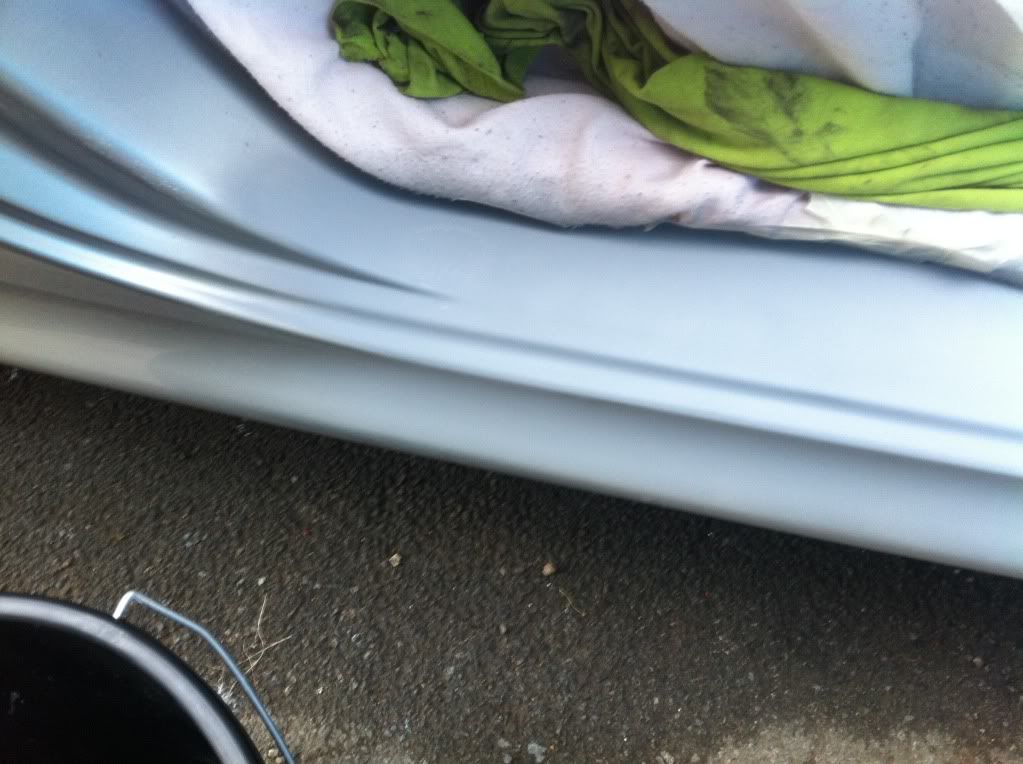

quick sand down with some wet and dry till it was back down to what it looks like in pic4, spray with primer, let it dry, sanded down a few of the rough bits, spray with matching colour paint (a couple of coats), let that dry then a couple of coats of clear lacquer!

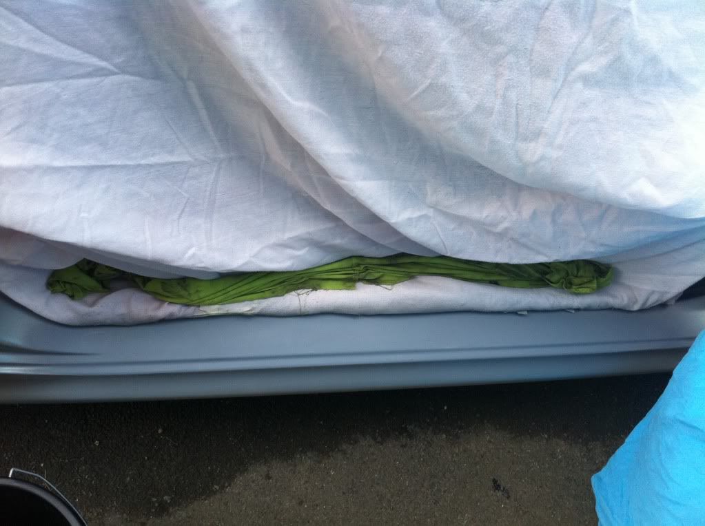

easy as! Smile would reccomend masking off beneath the door aswell though, quick lesson learnt! haha
