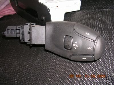

Could be either. Which radio control stalk do you have?

this one Smile :

Mrs_Howey
PostPosted: Wed Sep 14, 2011 10:46 am Up
Posts: 2800
Location: Worthing
Sounds like you need a new com unit to me Smile
02 is multi plex first year off them, i doubt it will have the pre plex unit at all tbh
