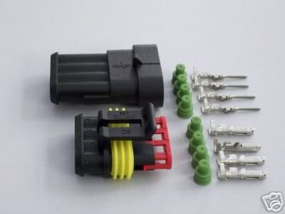

PostPosted: Sat Sep 24, 2011 3:52 am Up
Those two pegs on the side of the plug are probably used for a locking mechanism, the same type as the relay under the ECU and on the ABS pump.
You can always get rid of the standard plug and add a superseal type. A lot of automotive plugs use them.
Those two terminals looks like they will slot straight into one. They are about £5 from EBay or try Polevolt or AutoElectricalsupplies.
