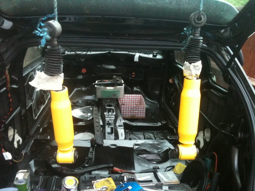

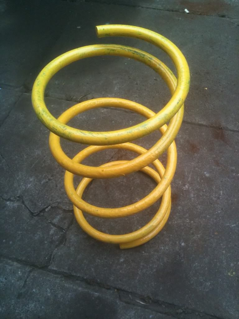

Spax adjustable shocks with Koni -40mm springs upfront and the rear beam lowered to match.

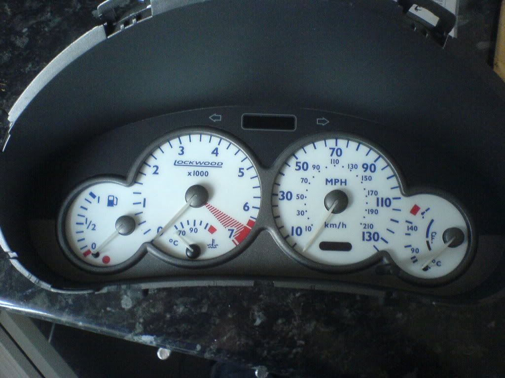

Lockwood white dials

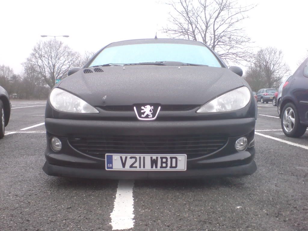

And so, the last time she saw the road, she looked not a million miles from this

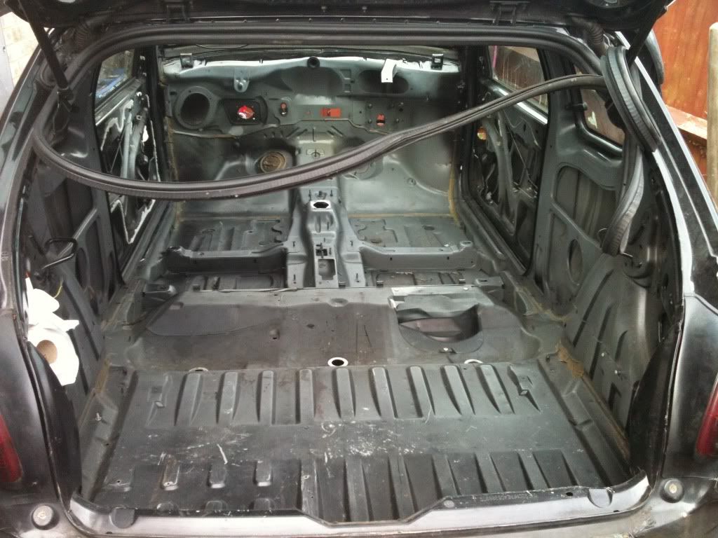

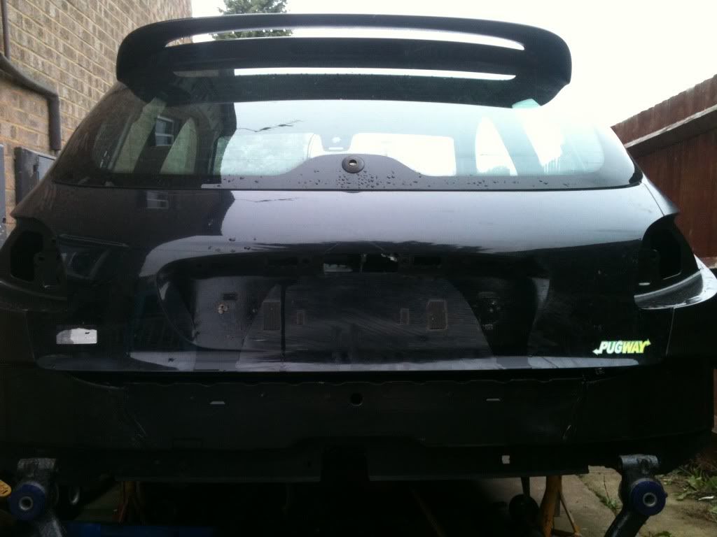

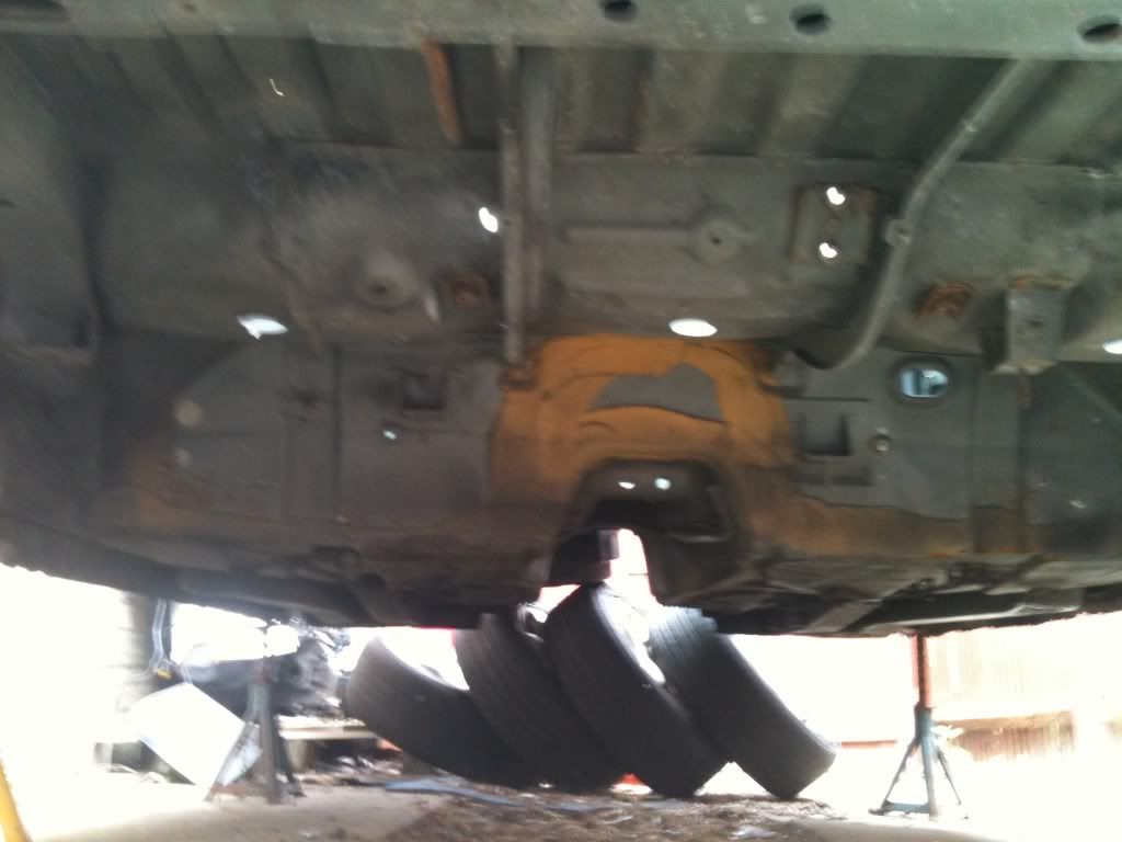

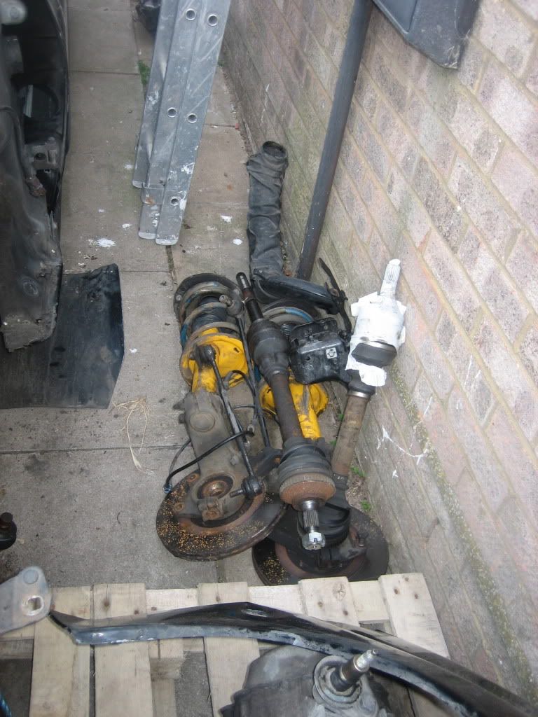

ok, so as of June 2010 i had her SORN'd. then proceeded to do this
thats how she stayed for the winter. and when things started to warm up a little, me and a mate (who is now sharing the driving responsiblilties! lol )got to work.
Little while later i had a few days off work for the purpose of
and got it to this stage...
to be continued....

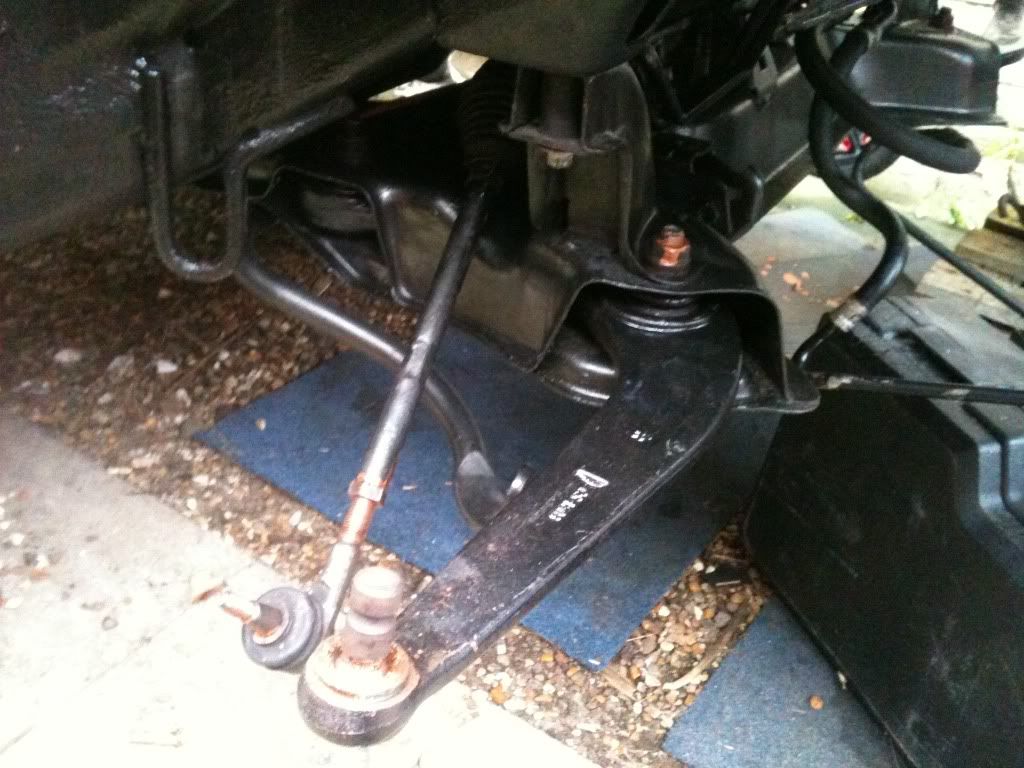

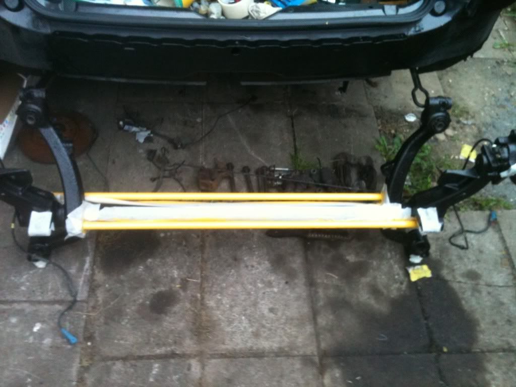

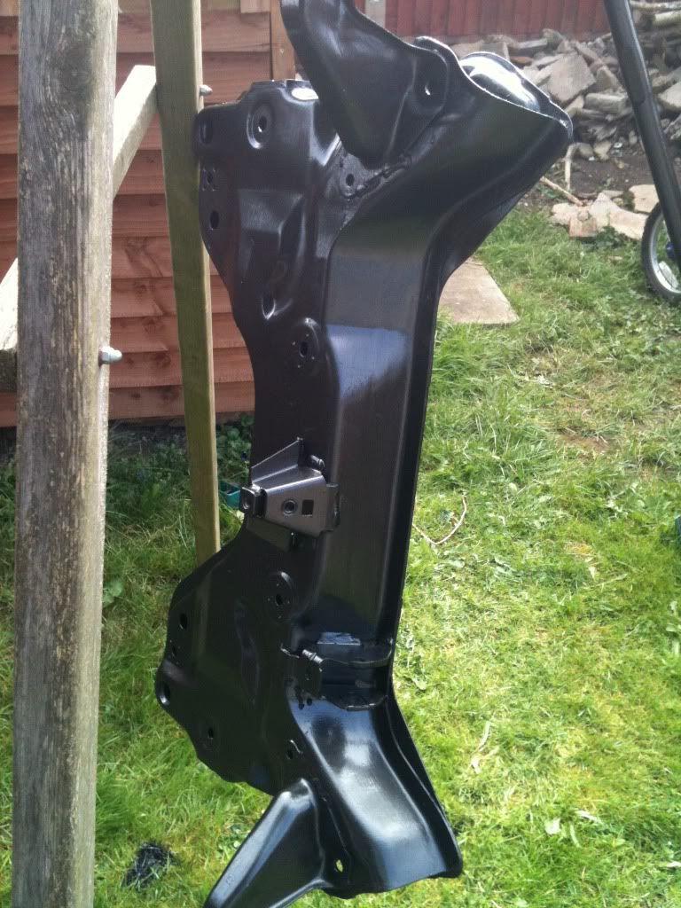

After the shenanigans of painting and undersealing, we set about replacing the old crappy rubber suspension bushes with some nice tight poly bushes.
This proved a tad more difficult than we first thought. We had a nightmare finding someone that did all the ones we needed (ironically Superflex and Powerflex both do kits now!)
Anyway, we ran with SuperPro. We have there lower arm (single offset) bushes, front Anti Roll Bar bushes and rear lateral beam supplement washers which stiffen up the OE mount bushes.
no problems with the ARB and lower arm bushes. and i know my mate (from here on known as Oggy) had fun with the press! lol
So we rebuilt the front end, withthe already painted subframe, ARB, lower arms and a nice clean steering rack!

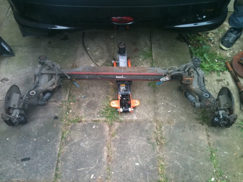

Rear beam however is a different story!
we did manage to get it like this
Before having to take it apart after stupidly trying to remove the OE bushes ourselves!. so that getting the arms off, removing the torsion bars, which was a pig as we sheered a torx headed bolt! (opps). Once it was apart we found knackered needle roller bearings which still need to be replaced. Also when replaced it was found that the old OE mount bushes had pretty much rusted away inside with a big hole in one of them. That said, Oggy had more fun with the press and it looks like this now.
we still need to refit the arms and bars etc but as far as bushes go its sorted! lol
To be continued....

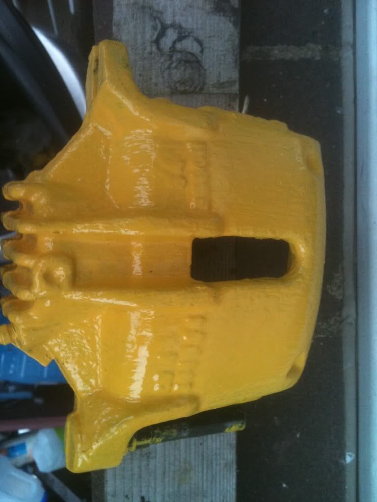

I painted up a plethora of other parts
the calipers are going in to be sand/bead blasted as there is too much previous paint on them and the paint job looks like s**t because of it

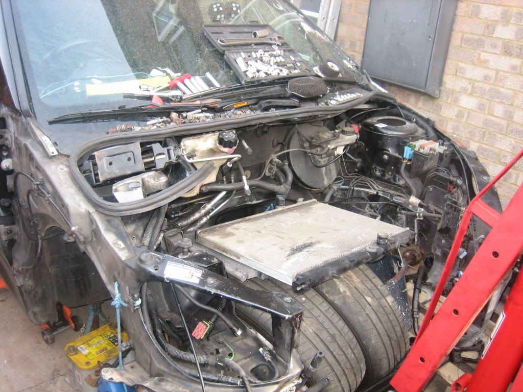

I got bored waiting for parts and generally wanted something to do so...
to this

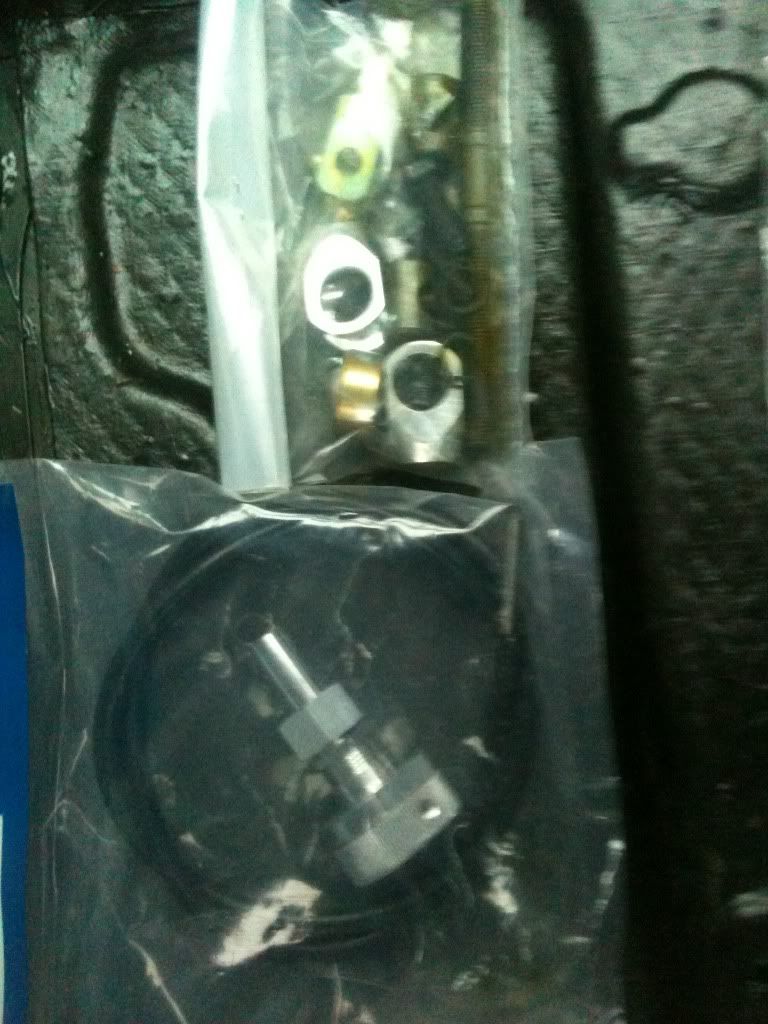

And to bring the project upto date...

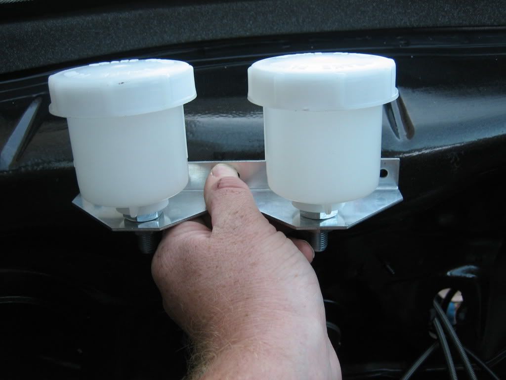

after getting the parts i was waiting for
two wilwood master cyclinders. one .625 and the other .700
remote bias adjuster

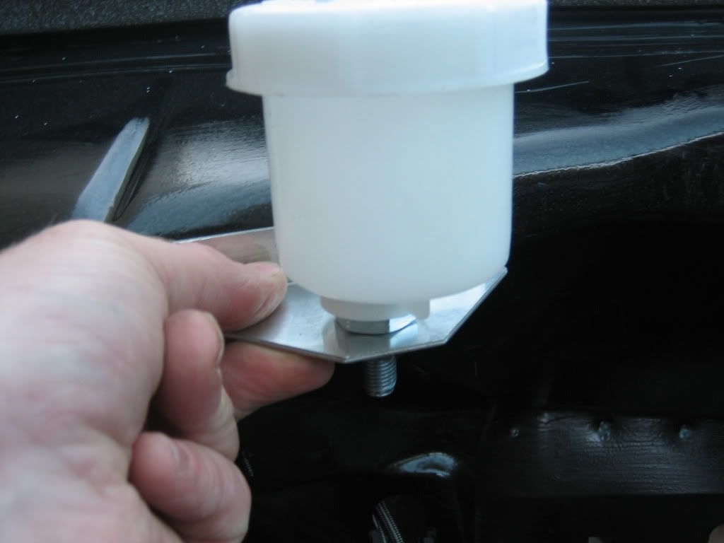

seperate fluid resevoirs (I did get mounting brackets, a double for the brake cyclinders and a single for the clutch)
three of these resevoir to cylinder drop pipe kits
Copper brake pipe, new unions and T-pieces (not pictured)

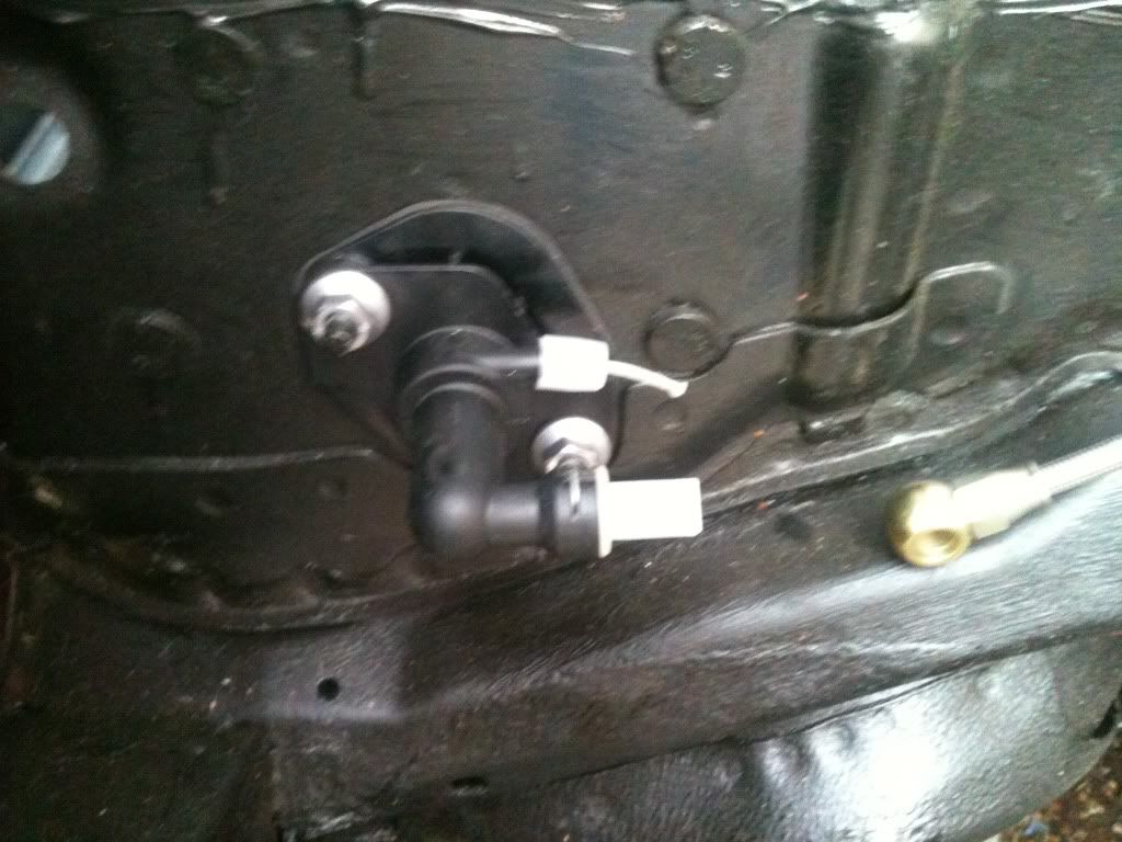

so, having spent an age putting together and setting up the bias box we went to fit it and work out where the pipes etc would be run.
trial fitted the remote adjuster. its a trick little touch for those 'on track' brake adjustments! lol.
spent a bit of time on the placement of the resevoir pots too! lol.
also fitted the new clutch cylinder (well, i say new, i've had it for two years!)
and lastly, both mine and Oggys fave part!
350mm Black suede Rally steering wheel with 3" dish Smile (excuse the clingfilm)
thats pretty much where it stands atm. we've got a few small bits to do before we run the brake lines and clip them down, but, its moving at a steady pace!

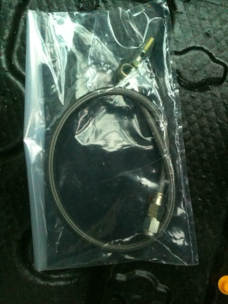

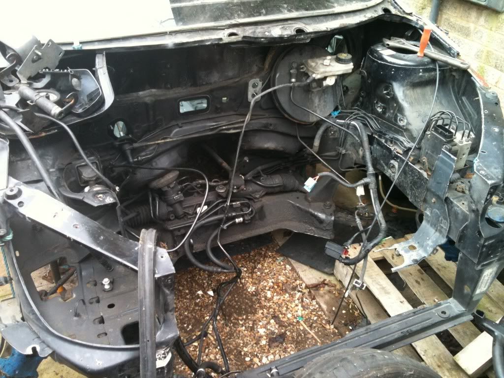

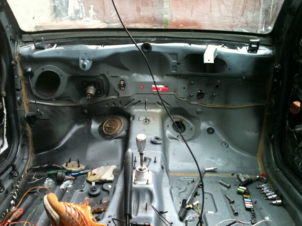

WOOP!! pipe clips arrived this morning, so we can get to work on the brakelines. still need some braided hoses for the rears tho.
To waste time whilst the funds recover, we're gonna get the loom/electrics sorted. chop out the unwanted crap and rewrap it, bind it all in.
More pics as it happens.

I ran cupro-nickel pipe inside the car to the rear, "T" piece under the floor and solid to each side and used flexi brake pipe to the calipers. Bearing in mind I have hydraulic handbrake. I assume with the bias pedal box you will run one pipe to rear Wink via the handbrake cylinder (if used). It also means you can get on without waiting for the hose to come Laughing
Electrics are fun on the 206 as the French earth everything a thousand times when one common earth would do. I did what you are doing and split the original loom and junked all the rubbish. Are you going to use standard ECU?
Mr_Cellexe
PostPosted: Mon Sep 26, 2011 2:52 pm Up
Posts: 960
Location: Hertfordshire
Yep standard ecu and funny enough exactly that with the brakes! Just minus the hydraulic handbrake (keeping the costs down as a normal
Handbrake will be sufficient ATM).
I'm yet to believe the 'fun' part of the loom (even if I am
An electrician by trade! Lol). We shall see what goes
On but I'm sure it'll have plenty cut out as alot of other stuff is out too, like abs and aircon Smile
