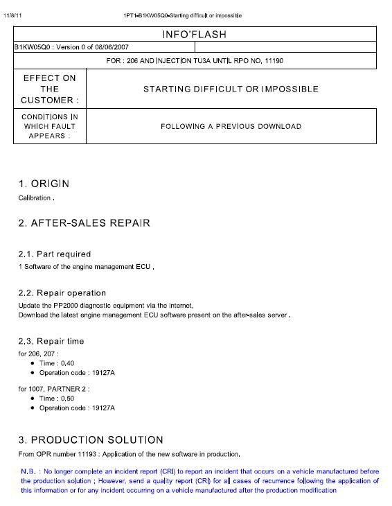

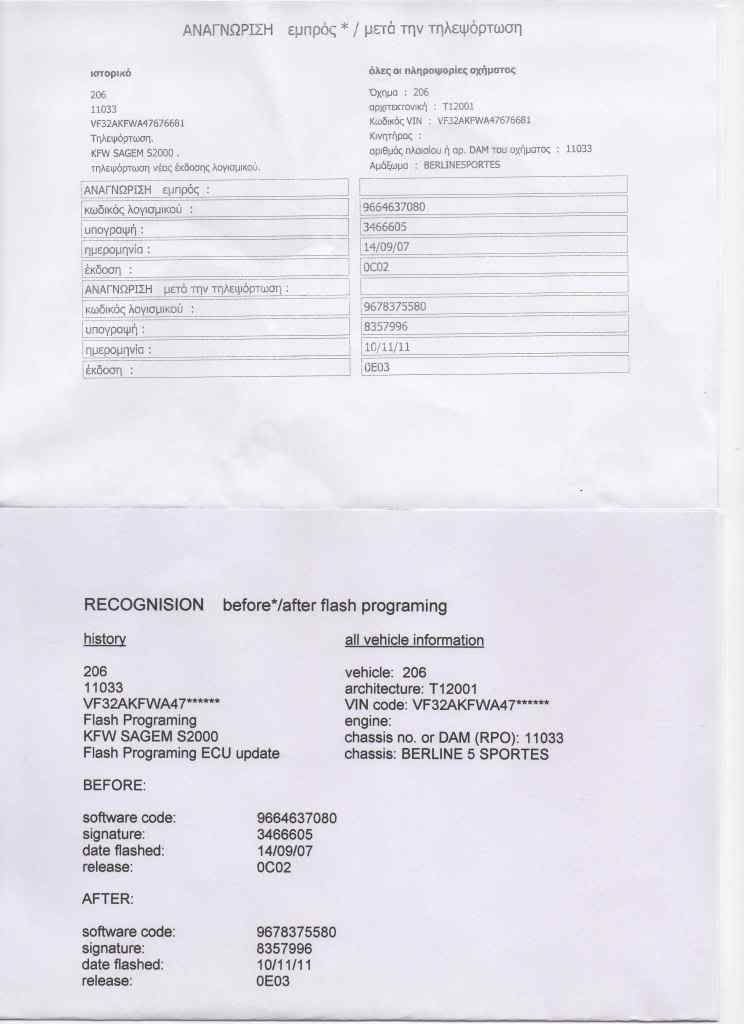

- SOLVED -
ECU update to the latest version needed due to bad software version from a previous update on 14/9/2007.
For reference this is before:
(note sometimes it would not fire-up at all when completely cold and needed 2-3 goes).

Thank you Lee for coming up with this:
The chap on PP2000 at Peugeot dealership also gave me this:
Which I translated btw.
