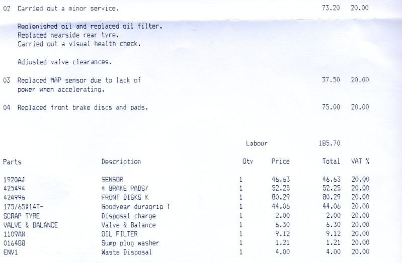

Well thanks for all the help everyone! The issue is now resolved and as per earlier advice, adjusting the valve clearances has solved the tapping noise.
In addition replacing the MAP sensor appears to have solved the acceleration problem as well.
With a oil service to round it off the 206 is back to normality.
Read out of the service sheet as follows:
img.photobucket.com/al...46crop.jpg
So for anyone experiencing tapping like in the video shown previously these are the things that got me going :).
Thanks for everyone pointing out what I needed to get done, very helpful Smile

Glad you got it sorted, but £205 to change the disc's and pads and a further £37 to fit a map sensor.... Ouch Smile

deanparkr: nice to have it running and sounding right. Don't worry about people suggesting pads and discs at £205 is expensive. It is only expensive if you could do the work yourself and then you could have saved £130 - £140. If you could do it yourself you could have saved all the labour charges and paid less for the components.
The oil and filter change is a 10,000 mile task and should have been done when they did the head gasket, if they did it again then it was unnecessary though I do note that they have charged you for a filter but have not charged for oil! They may argue that there was still some water in the engine from the head failure so they needed to change the oil again. It is unlikely but now it's done you can't prove it.
Doesn't that evening class now start to look affordable when you could have done this yourself and saved £250 on this bill alone?
Doing the head gasket would probably take more than an evening class can give but this basic service is easy, even the pads and discs, once you have the basic skills and some confidence.

Yeah its great to have it running normally. The oil change was done as I was approaching the annual change and just thought might as well do it at the same time.
I'm happy with the pricing, after all I couldnt do it myself and would much prefer the expertise of a garage, espcially with things like brakes.
