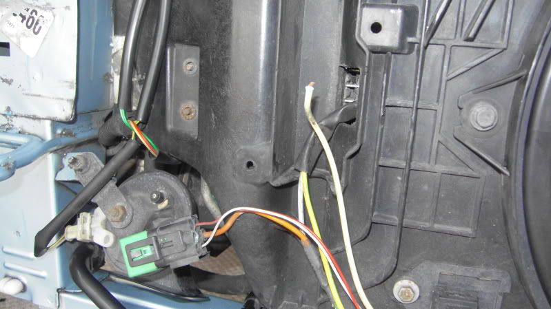

Short of people coming to fix your car all the advice you need will on the forum topics. Just take the relays out, clean the terminals and make sure the wiring is still connected to the terminals in the relay. If you have a multimeter it can help.
It looks like this below so it's down to you.
