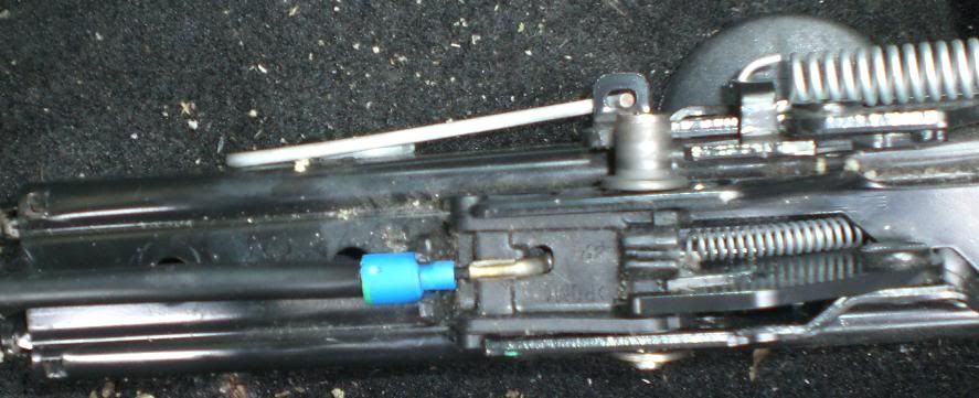

So you're saying the seat slide adjusts ok with the manual bar at the front of the seat but doesn't slide when you tilt the seat back forwards?
[img]
[/img]
The mechanism should like this. The manual bar at the front of the seat takes the spring load off and releases the seat from that top hat looking pin. The pin connects the seat to the small slider in the rails. The cable shown here should do the same thing and release the spring load which frees the seat to move. It sounds like maybe the cable end shown here is detached or broken?

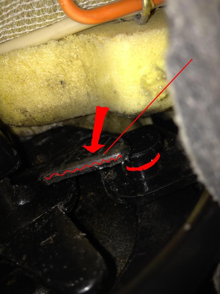

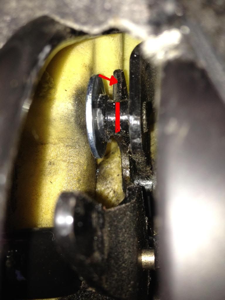

this was my little fix before and after
in this 1st pic you can see the lever arm that is missing the pin to pull the wire
in the second pic you can see the washer glued on the end. 1 day i will try and get it welded on. ( just dont want the seat to go up, lol)

Good stuff! Thanks for pics, makes it clearer to see the problem
