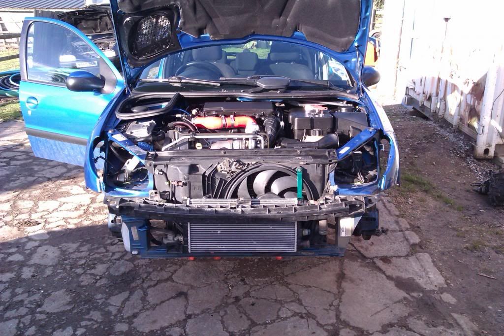

Hi guys been on the forum for a while but don't really post much up. Iv got a 1.4 HDI i brought in august with 74k with plans of tuning and charge cooling. Loads of pictures to follow hope you like it....

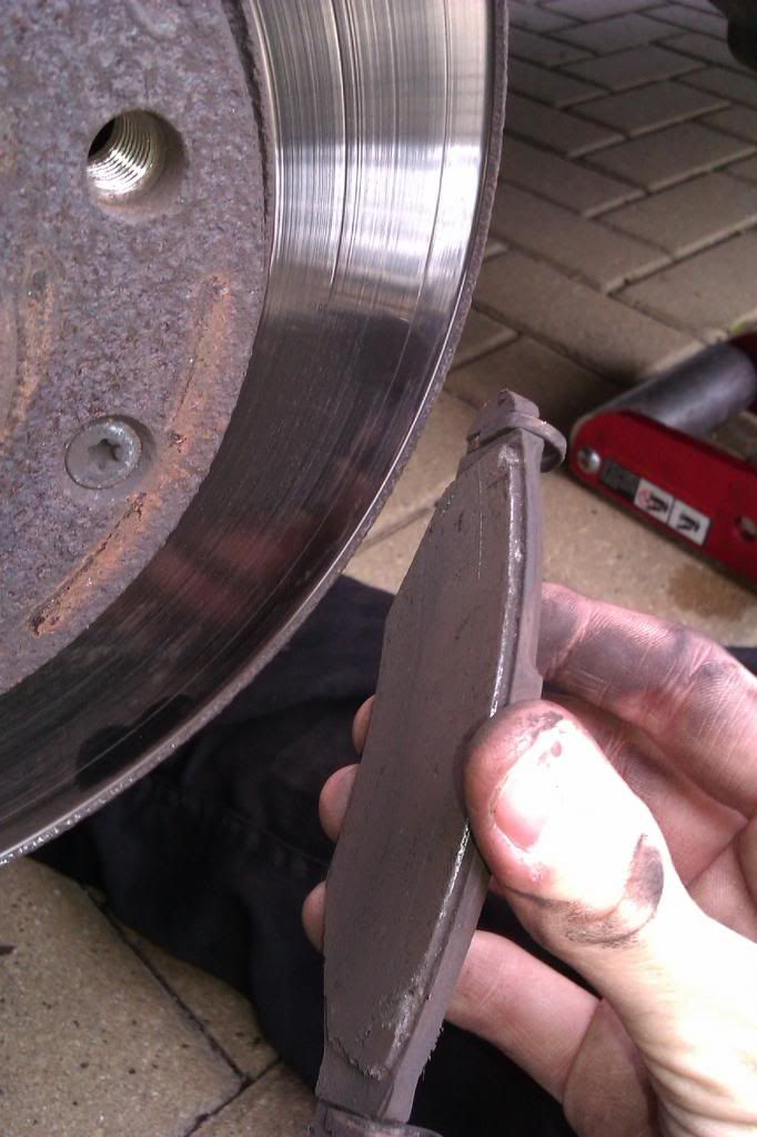

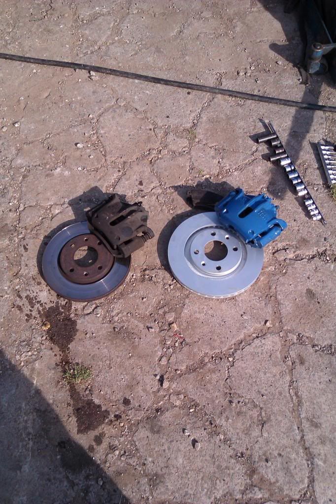

Took the brakes of for a clean and saw they where pretty thin so thought id treat my self to GTI brakes and beam

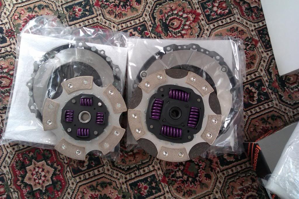

Clutch seemed like it was on its way out then started slipping when i had a full car, so with the future in mind got a paddle clutch(left ones for the 1.4HDI the right ones for my mates 2.0HDI)

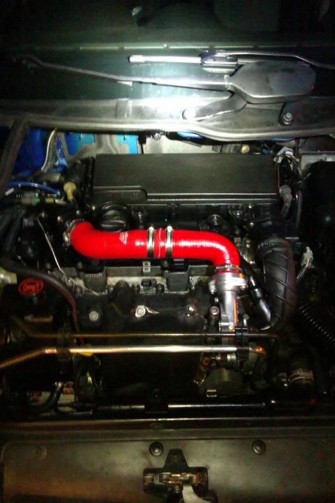

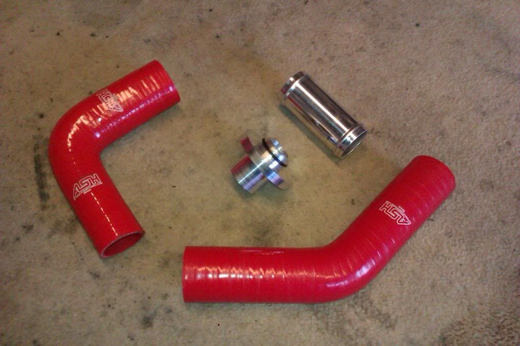

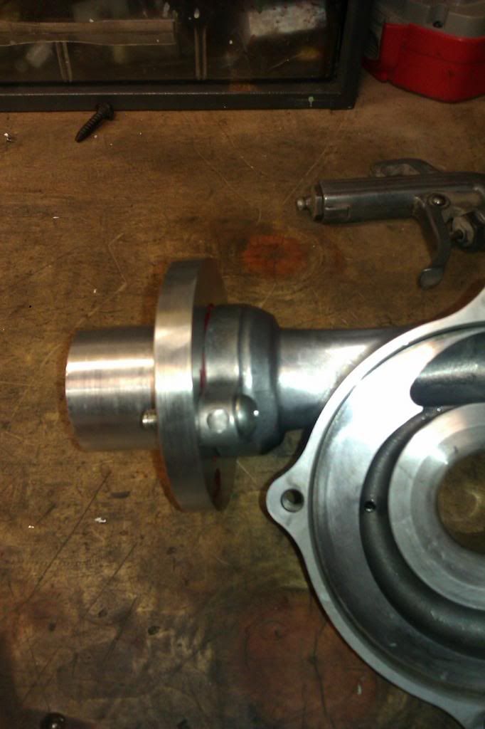

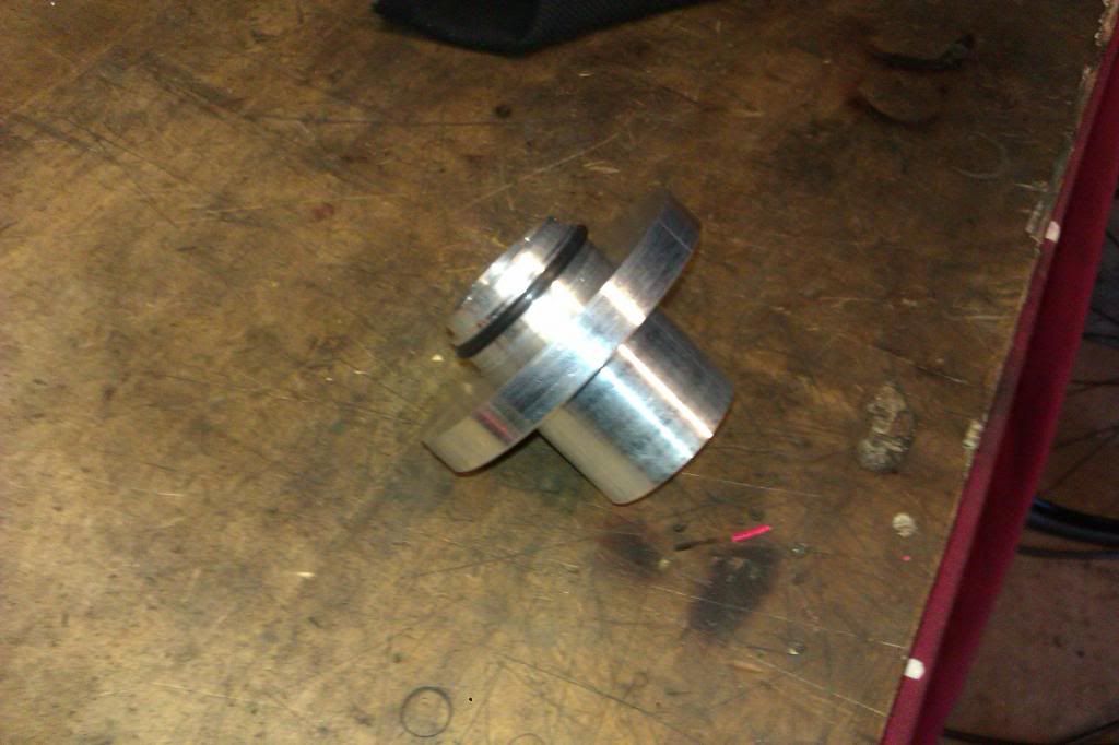

Wanted to get rid of the standard turbo box as it just looked boring plus the plans of the charge cooler to come so i brought a few pipes and reducers and lathed a 3" bar of alloy down to make the turbo flange. Fitted it and it looks good, don't think there is any performance difference maybe a little less lag as the box has a baffle plate but nothing special.

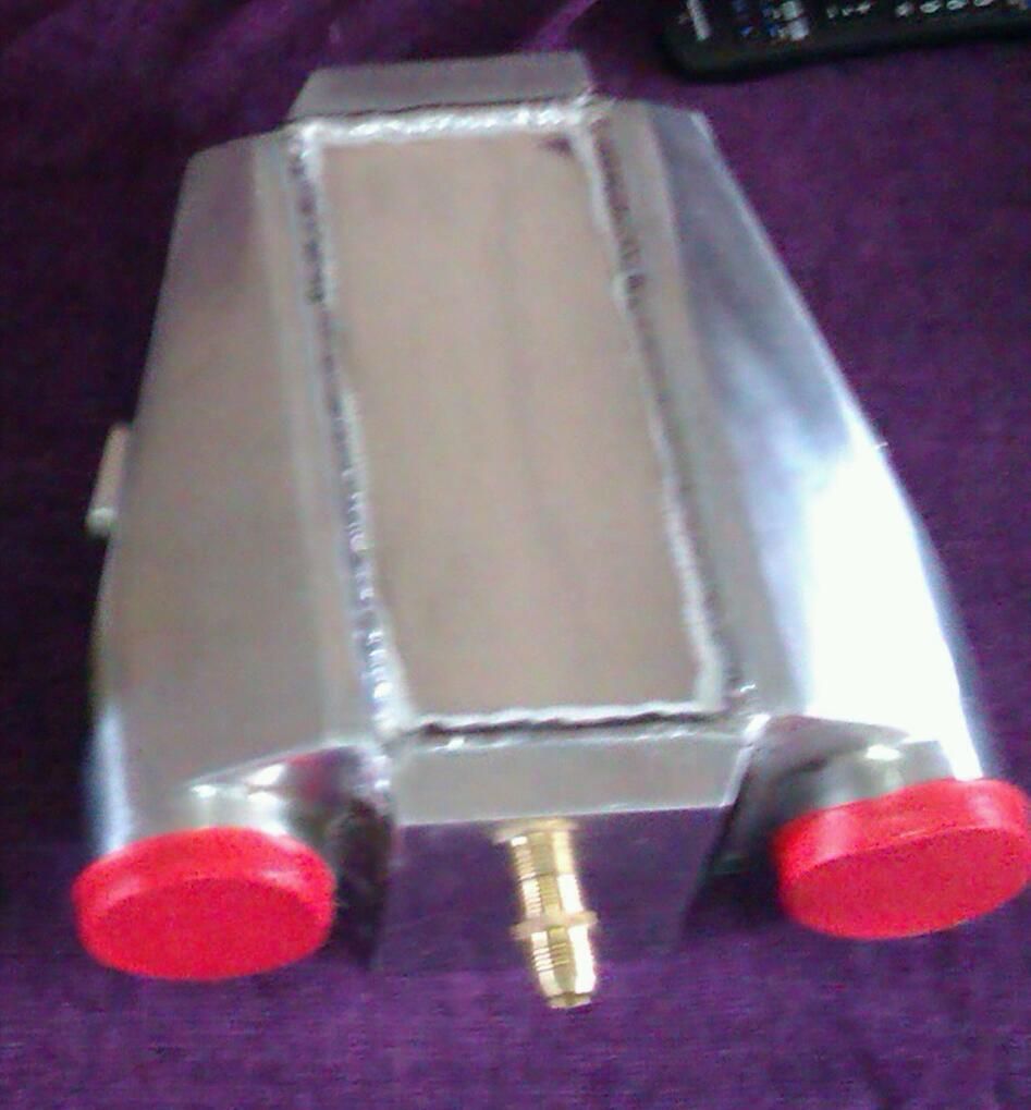

Brought a charge cooler, radiator and the Bosch water pump, this will be my next project to plumb it and go stage 2.

whats make is the paddle clutch and whats it like to drive round on?

I think its a panther but ill have to double check. Is good once you've got going but wouldn't recommend it unless your going to be tuning it. Took a while to bed in as it ceramic but its getting better/im getting used to it.

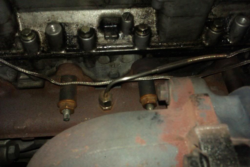

Iv also fitted EGT and Inlet temperature probes. Plus boost gauge. Will put some pictures up one day.

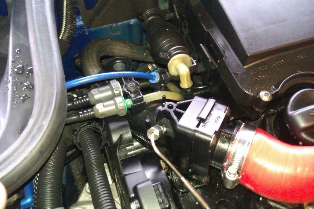

Got some pictures of the temperature probes, just drilled and tapped them in to the exhaust and inlet. I have the gauges in the glove box which can be linked to the computer to record it thought a drive.

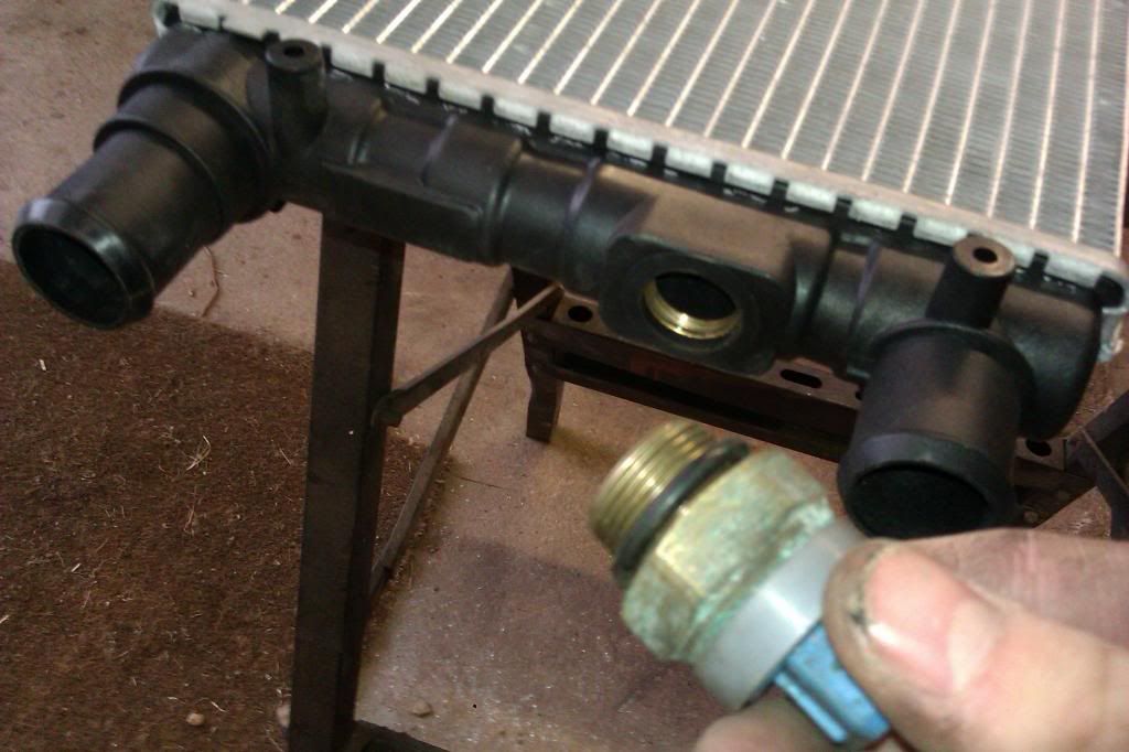

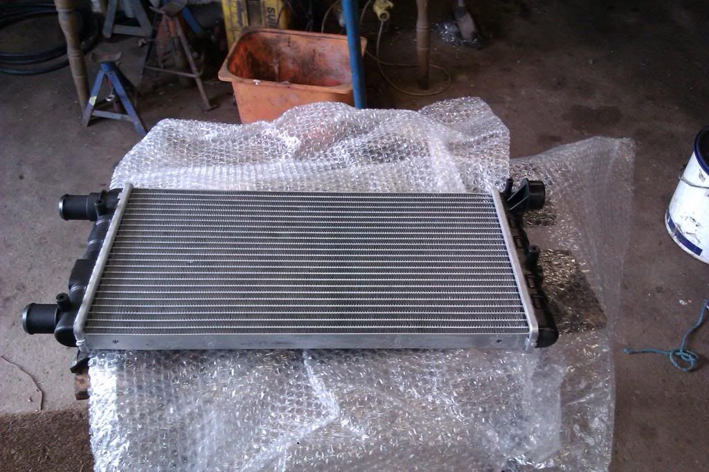

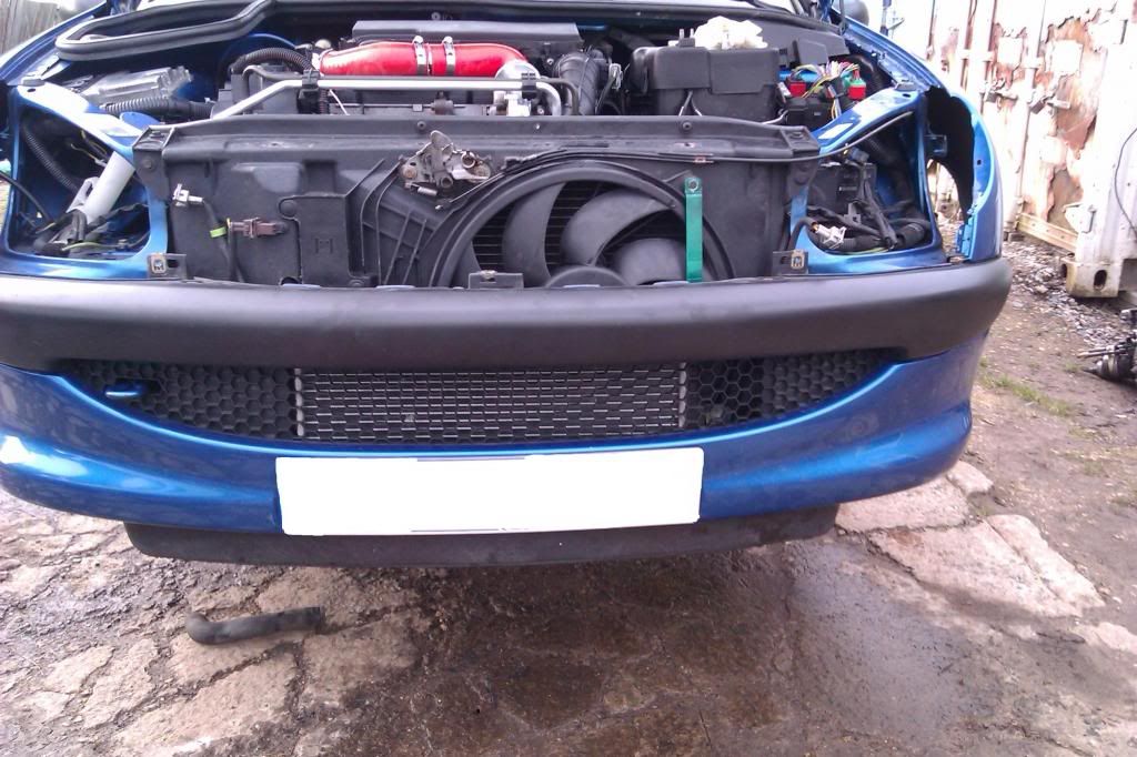

Fitted the pre rad for the charge cooler today, think im going to need a smaller charge cooler as there is no way of it fitting without a bonnet scoop.
The rad as it comes, it has a hole for the thermostat and some random lump of plastic on it.
Plugged the thermostat hole with a thermostat out of an old car.

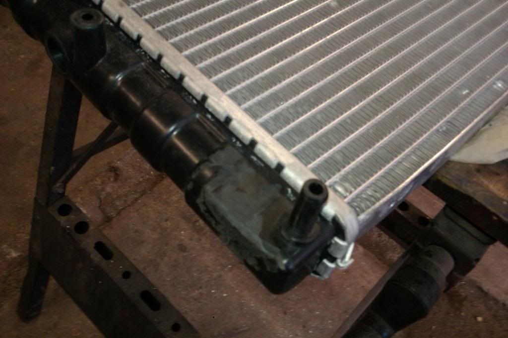

Got the Dremel out and cut the lump off the side to make it thinner.

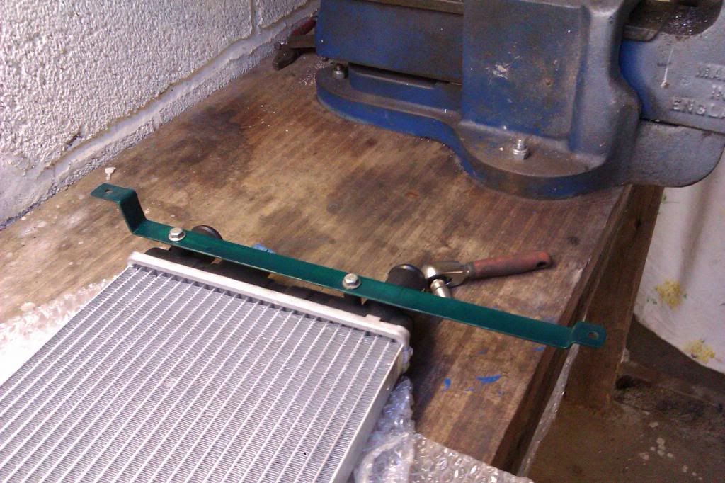

After alot of trial and error i made a bracket up (is green because that was the only paint i had to hand and you cant see it anyway)
Mounted on the other end by screwing straight into the plastic front and drilled a massive hole to fit the bleed pipe through into the engine bay.
Looks pretty good with the bumper on just need to find another smaller charge cooler.
