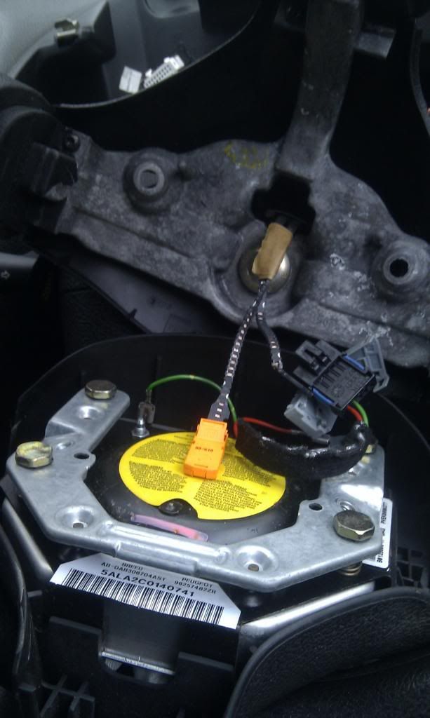

simple question, see pic. do i just pull out the orange plug to remove airbag or will i end up with a sore nose? if so then what do i do?
been stood there holding it about to pull it out but kept scaring myself and pussied out Very Happy
battery is properly disconnected following BSI shut down thingy.

If the battery is off surely it can't go off? No power! No bang?

Set your phone to record and pull the plug. If it goes off, you make £250 from Harry Hill and give us all a laugh, if it doesn't then that's just boring. Laughing
After disconnecting the battery, all the power to the airbags should have dissipated after about 20 minutes, making them safe to work on.
It's the sudden power surge the airbags get when you re-connect the battery that you have to worry about Wink

It's OK.
(famous last words)
No it's OK as long as the batt is disconnected and you leave it alone for a while as macca says.

Pull it!

You just pull it (i'd have battery off), well i say pull but i popped it off with a flathead. Either way unless you somehow short it it won't go off.

manned up and popped it off with a very long flathead from a distance whilst looking the other way! safe to say i am still allive Smile next problem is i've lent out my T30 to icannotrememberwho, so all a bit pointless for the time being Very Happy
