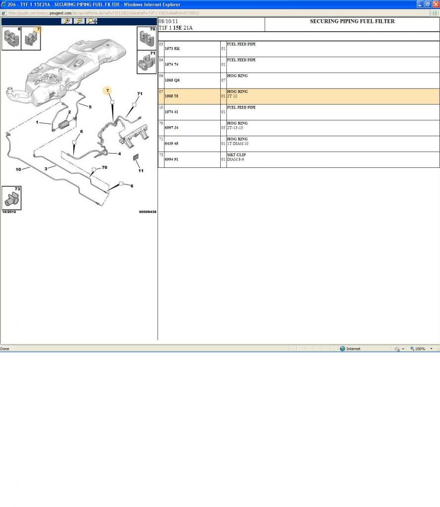

Number 2 (external filter)isn't listed as being fitted to your model
My guess is that it is part of number 2 of this one

Just checked, yours is also integral with the fuel pump and there is no sepperate filter canister that you need to replace.
In the following diagram you can see that part number 2 (canister) is not listed on the right which means it's not fitted.
