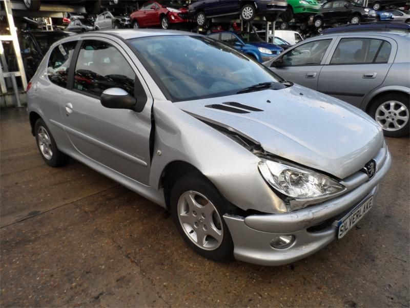

Hi there folks. So I've bought another 206 Verve on a cat D.
It's a 2006 plate with 45000 miles on the clock. I managed to get this one for £620. It's a really nice tidy car. I have one or two questions though concerning the bonnet and bumper.
Can I put the Cc/ Gti bumper and bonnet on this verve? Obviously on the verve the bumper is colour coded. I cannot find a standard colour coded bumper yet in silver. They've all got the Black bumper protector strips.
I know the wings are different on the cc and gti. Basically I need the whole front end for this car. Is anything to stop me from putting gti/ cc wings, bonnet and bumper on?

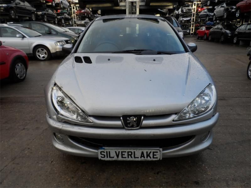

Online car salvage auctions. Silverlake, Asm and MotorHog are all good. People bid just like a EBay lot.
Another question. What bumper is on the verve? Is it colour coded standard, gti or a sport bumper? I've tried to work it out by looking at pictures on EBay but I'm still not entirely sure.
The verve front bumper looks like a Gti bumper to me. Another thing, if I put the gti wings on this car, the 14 inch verve alloys will look lost me thinks.

its a sports bumper ie gti bumper. I would upgrade the wheels.

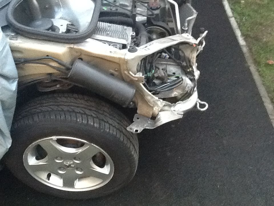

Hi mate. Yes I will put gti wings on as there is a Cc being broken near me. I'd like to get the complete front end of the same car so all the panels match up.
I removed the front end yesterday of the car. The drivers side inner wing is ok but the headlight housing is pretty beat up. I'm going to try and knock back into shape first. If that fails, another section will have to be welded in.
To my complete amazement, the airbag light isn't even being shown displayed on the dash. The first 206 I did , I had to remove the airbag ecu and send it away for diagnostics.

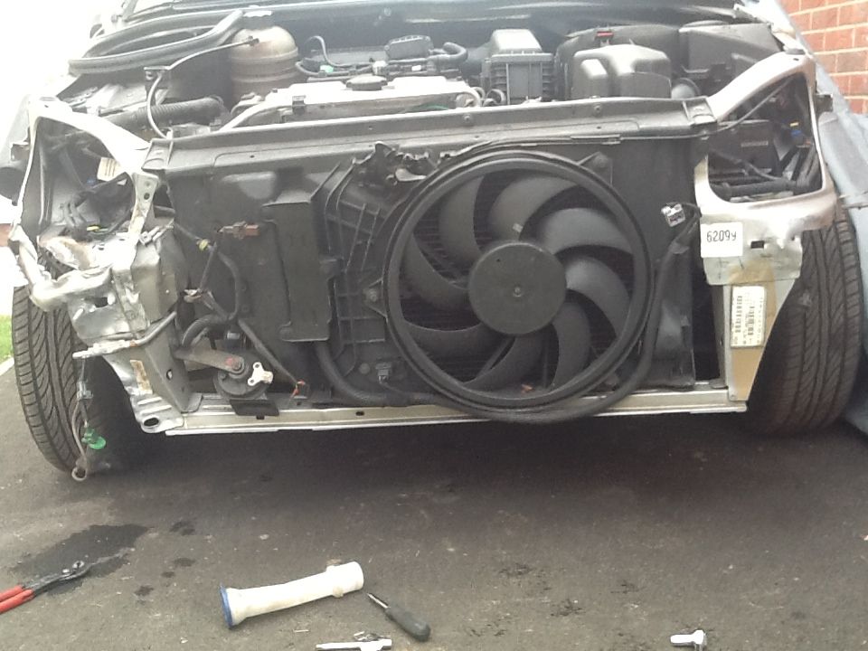

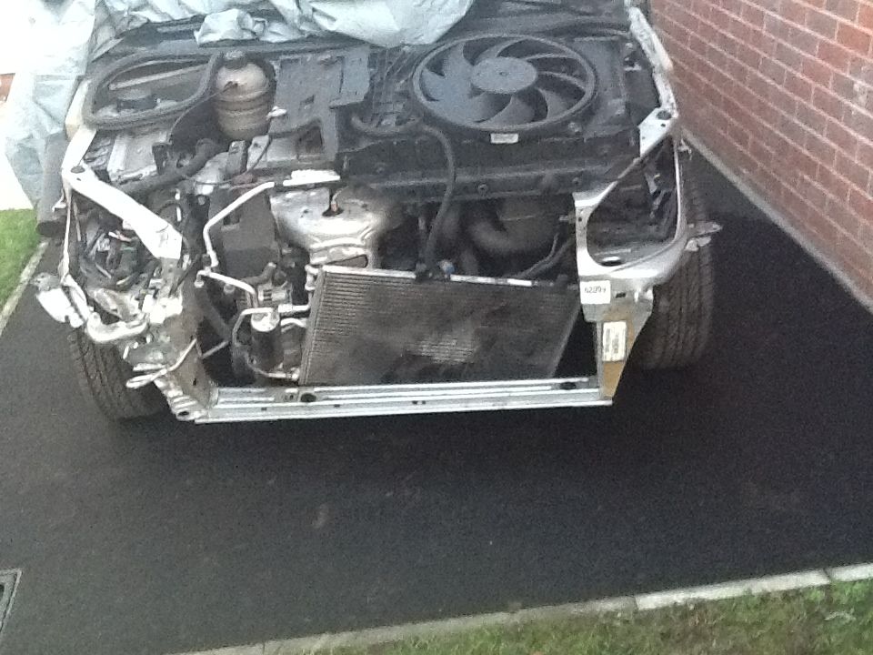

Hi mate. So yesterday I removed wings, inner wings ,bonnet ,bumper, crash beam behind the bumper( not sure what that is called) and lights. Didn't salvage much. The inner wings are good to use and I kept the spot lights. Everything else is scrap.
So today removed what was left of the screen wash bottle, horn, radiator and fan. Removed the whole of the front end. As you can see, there is quite a bit of damage to the headlight housing and front chasis.
Obviously I ain't banging that lot out! Off to the breakers to cut the front end of a peugeot 206 hdi I was ragging today. Will get inner wing, headlight housing and lower beam welded in.
Quite surprised by the amount of damage to the inner chasis. I knew there was damage though as I viewed the car.

Hi mate. Is it the same colour? I've been to Center Parcs the last week. I got back yesterday so I haven't done anything else. This got delivered though.
Everything I need to replace the damage on my car. So next step is to remove the damaged chassis leg, inner headlight housing and bottom cross member. These inner panels are all held together by spot weld.
I will need to drill out the spot weld and then use a panel seam splitter to remove damaged bits from the car. Then the same to the o/s front corner I've bought.
Just waiting for my spot weld drill bits to arrive in the post now.
