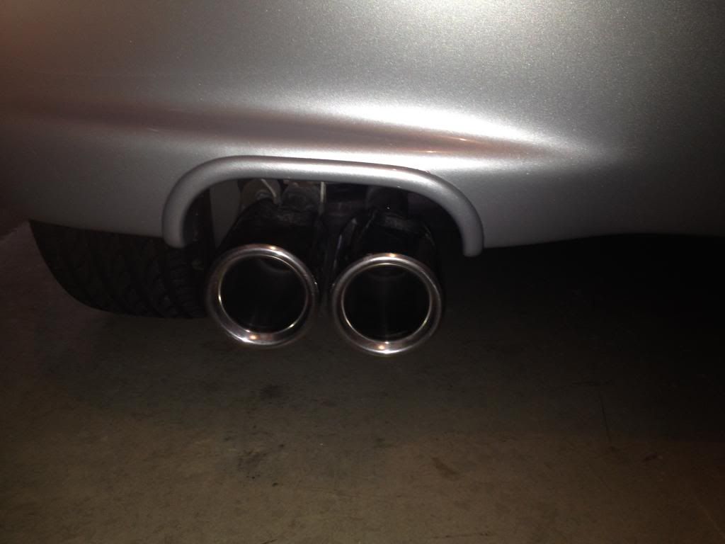

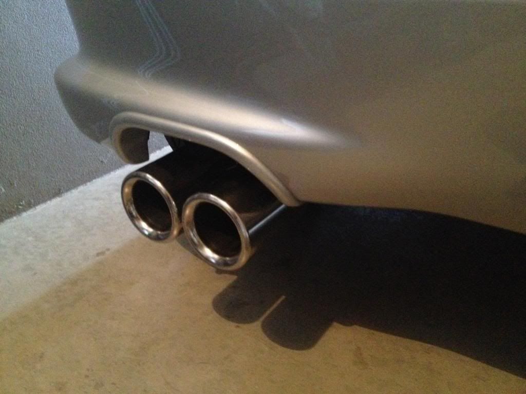

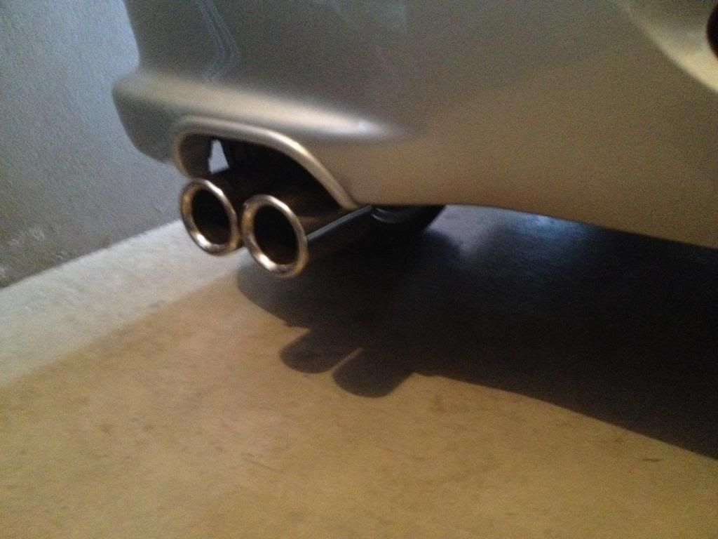

Hi all,
After a quick repair on my exhaust the twin tailpipes seem to be sitting a little further downward than normal.
It looks like they are pointing slightly downward and there is too much gap between the twin tailpipes and rear bumper.
I do remember there was always a slight gap but now when I look at it my hand can reach to the rear of the chrome tailpipes and can see the muffler mounting brackets.
Prior to the exhaust fix, this was not the case.
Here are a couple of pics.
Would appreciated your thoughts and feedback Smile
PostPosted: Sun May 25, 2014 5:25 am Up
is there much movement in it (shaking around etc) ?

PostPosted: Sun May 25, 2014 6:58 am Up
Joined: Jun 04, 2010
Posts: 1691
Location: northallerton
could also be the cat or middle box flange being different if they have been changed

cheekyage
PostPosted: Sun May 25, 2014 7:50 pm Up
Joined: Jan 22, 2013
Posts: 94
Location: Australia
No shaking or movement at all. All has been mounted firmly and correctly.
cheekyage
PostPosted: Sun May 25, 2014 7:56 pm Up
Posts: 94
Location: Australia
The centre pipe was replaced with a brand new and genuine Peugeot one (part number 1717S9)
All has been fitted to original spec with the original mountings and brackets in located in the same place.
usher
PostPosted: Mon May 26, 2014 2:16 am Up
Posts: 1691
strange then its usually when bits get changed for non genuine, try the rubbers or cable tie the hangers up without the standard rubbers to see if it will work
