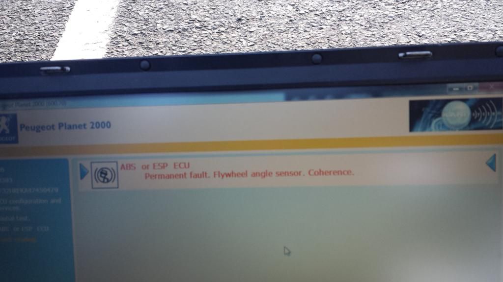

esp is not working but abs is working fine, have this code come up on peugeot planet........
have tried changing flywheel sensor as advised by someone but has made no difference.
has anyone else seen same fault before?
could a BSI reset/reboot help in anyway?
thanks ben Very Happy

Could be a faulty ABS sensor, I don't believe it wouldn't necessarily throw an ABS fault up either despite the ESP being faulty.
I would be inclined to just check the condition of each sensor and make sure the connections are solid if you haven't already.

Did the crank sensor not fix it? Let me as a master tech for any relevant info on the matter mate
PostPosted: Sun Jan 25, 2015 6:14 pm Up
Nar didn't make any difference tbh. Nice one thanks Smile

Is your steering wheel straight?
Work in Progress
PostPosted: Mon Jan 26, 2015 7:11 am Up
Yer seems straight. Weekend i had to change the ns shock as had gone and car was leaning to oneside.
But drove to work this morning with fault still, popped out to screwfix and had parked full lock, when i left i started up and pulled off straight away. And all the way back to work it was fine and working. (Put foot down to test too.) Will find out later when i pop out again see if its still ok.
