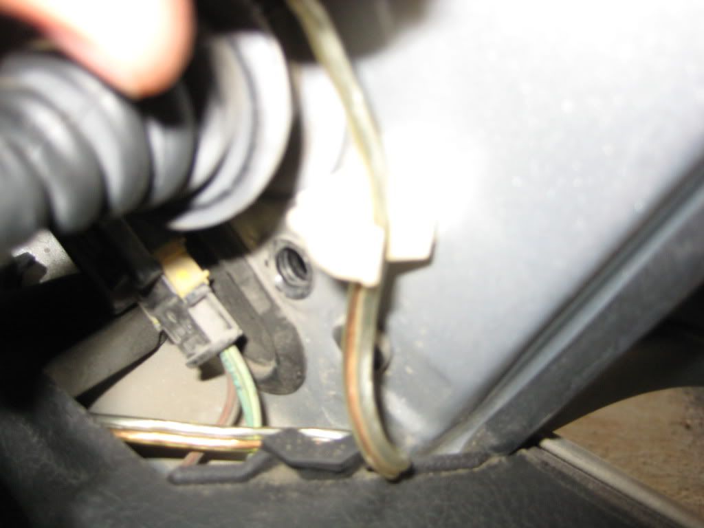

Well the fiddly part you mentioned,is done,sensor is place inside the mirror,and wires are ready to be connected,I have a plug with three wires connected to it only,2 green wires,and one brown,I have tried connecting the 2 black wires from outside temp. sensor,but not joy,so as you can in the pic,that is the wires I got,can I use them to have the outside temp. sensor work or not? and if not what should I do to get this work.

Digging through the diagrams in the How-To section, diagram 6 for multiplexed says the sensor normally goes to pin 3 & 4 in the socket of the mirror (at least for motorized mirrors), using wires B433 and B434 to run to pins 18 and 8 on a white 40 pin connector on the BSI.
If the wires you connected it carried +12V and ground, you might have fried the sensor (no idea what it can tolerate), going by the diagram it connects to 'electronics' in the BSI.
Not sure what your car has / hasn't got in the shape of unused wires in the harnesses...
HTH

Mtempsch-Thank you so much for you second reply :),I have seen that diagram,and I read it...the wires is not B433-B434 ,it's 6433 and 6434 according to the diagram.
I have not checked the plugs in the BSI or if there is voltage in the the plug in door harness.well see how things goes,and update here.

PostPosted: Mon Apr 24, 2017 10:04 am Up
Well Jeagle,glad that you got things working,as things didn't work for me,so can you post pics for the wiring,and where did you find it,in the door,or the BSI,pics would be helpful for me and others in the future Smile
