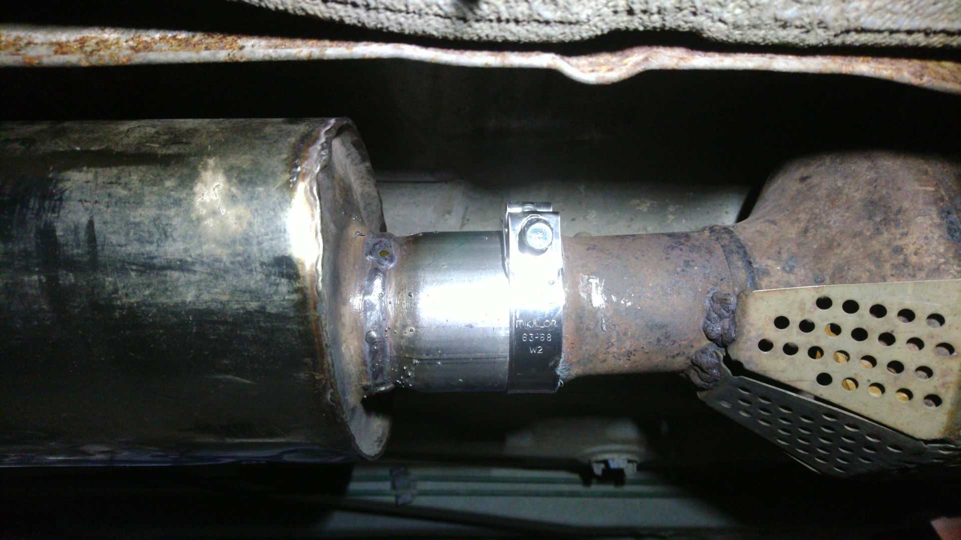

☑ sort out Scorpion <-> cat coupler, so it stops rasp-blowing through and through [update: sleeve reworked, but some rasp is still audible. Jun '19]

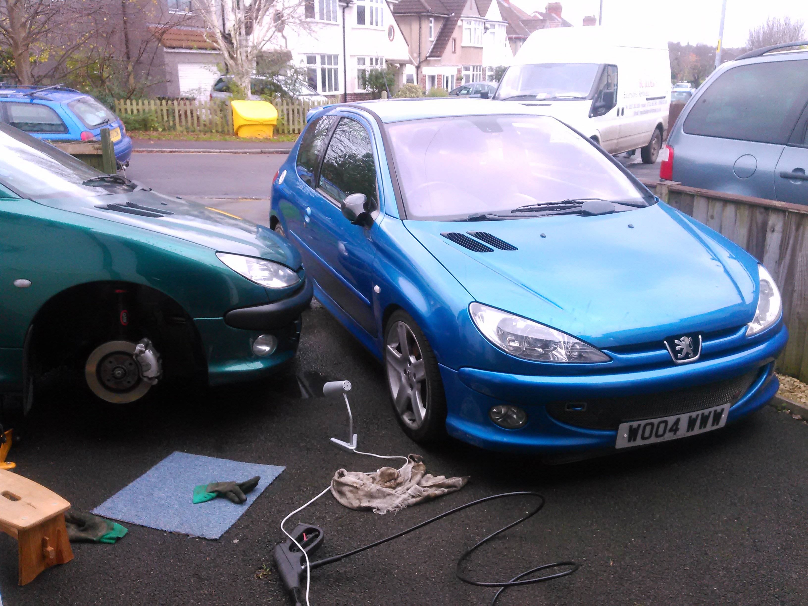

On a crammed driveway replacing Jude's wishbones Very Happy dreaming about the day of having a sizeable workshop

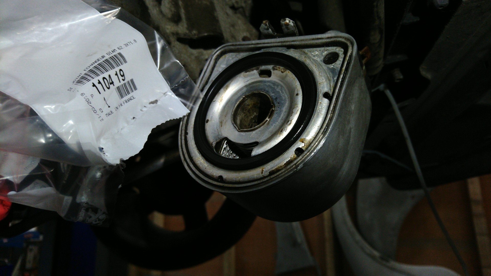

Jude was due for her MOT: passenger airbag light, rattling rear axle, and clutch on its way out -- quickly fixing any of these wasn't an option. Combined with desire to put Jay on road took the better of me, and so the works started.
Firstly there was no power arriving to the horn itself via connector -- taking it apart showed green-oxidised terminals. Contact spray and some scrub sorted that, but it still wouldn't honk when pressing on the airbag. Read on Smile

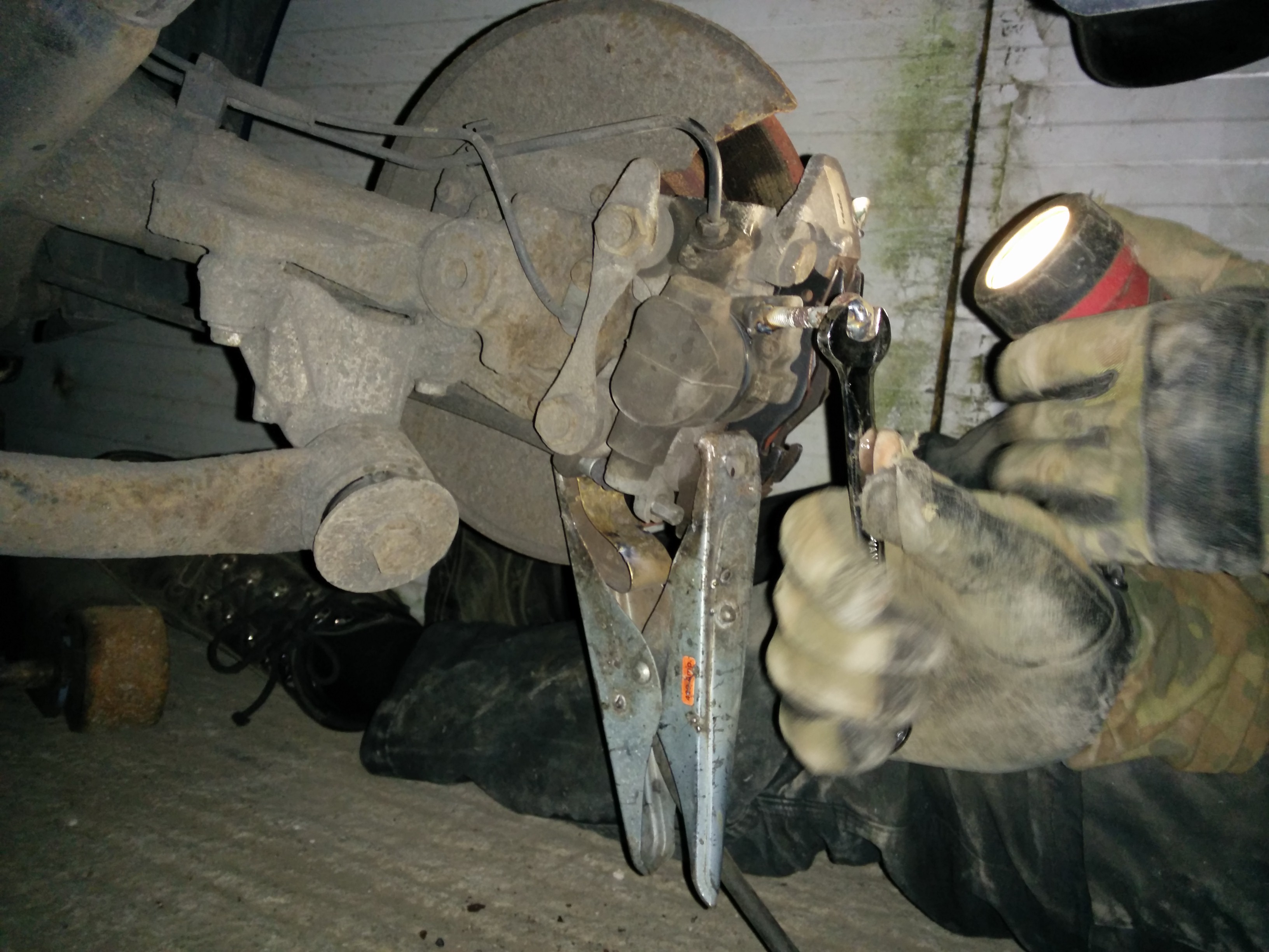

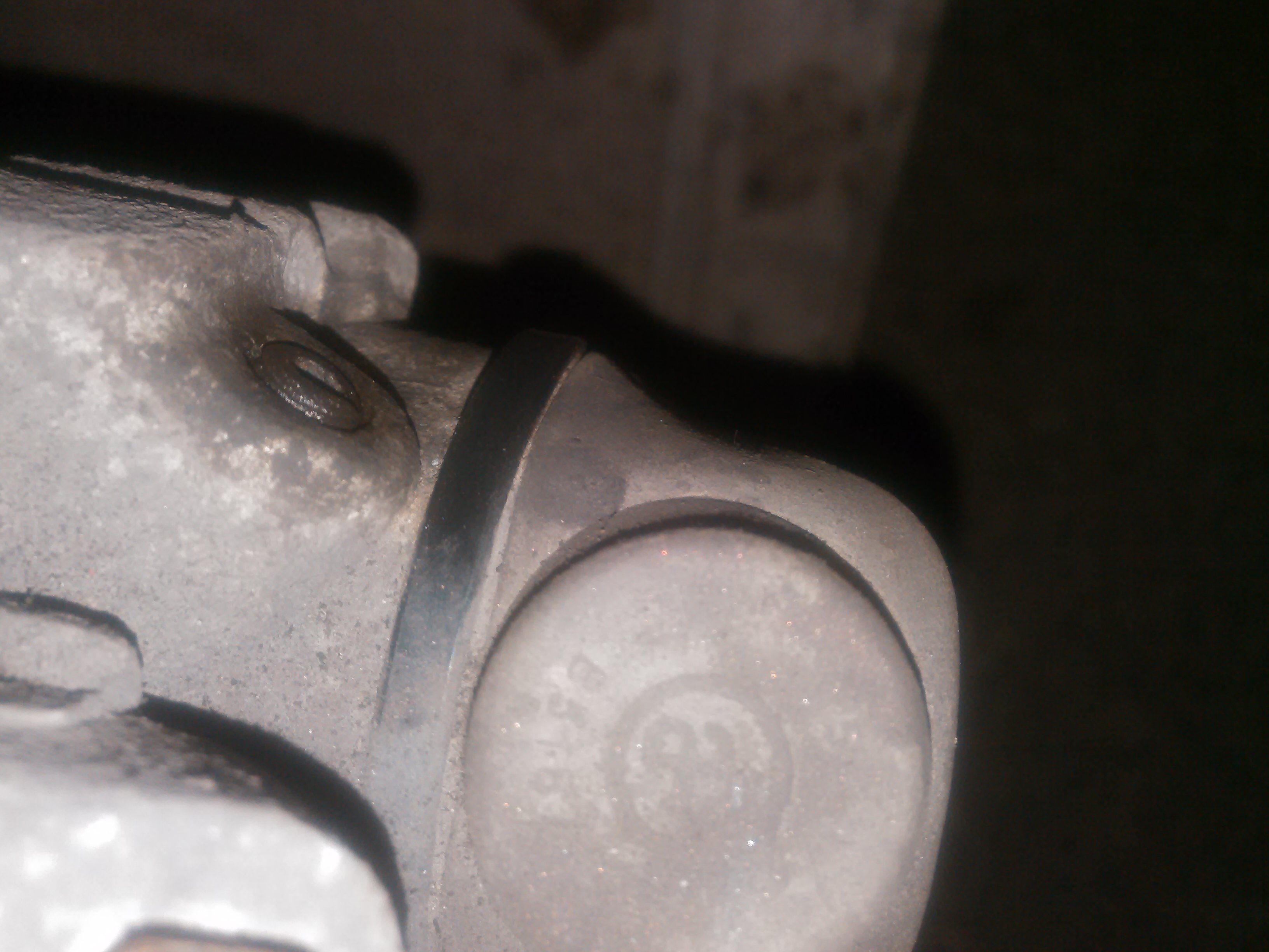

Brake pedal would spongily travel all the way to the floor (efficiency though mildly affected), no wonder why
Quickfix attempt to weld a nut, kept eating more and more of that seemingly cross-threaded bleeding nipple
Sourced the whole caliper from the land of sporty Pugs, will go in at a better day, and the naughty old one will get some boring.
MFD kept coming up with "Airbag fault" and "ESP/ASR not functioning" since the day I got the car, relevant faults read with PP2000 back in October were as follows:

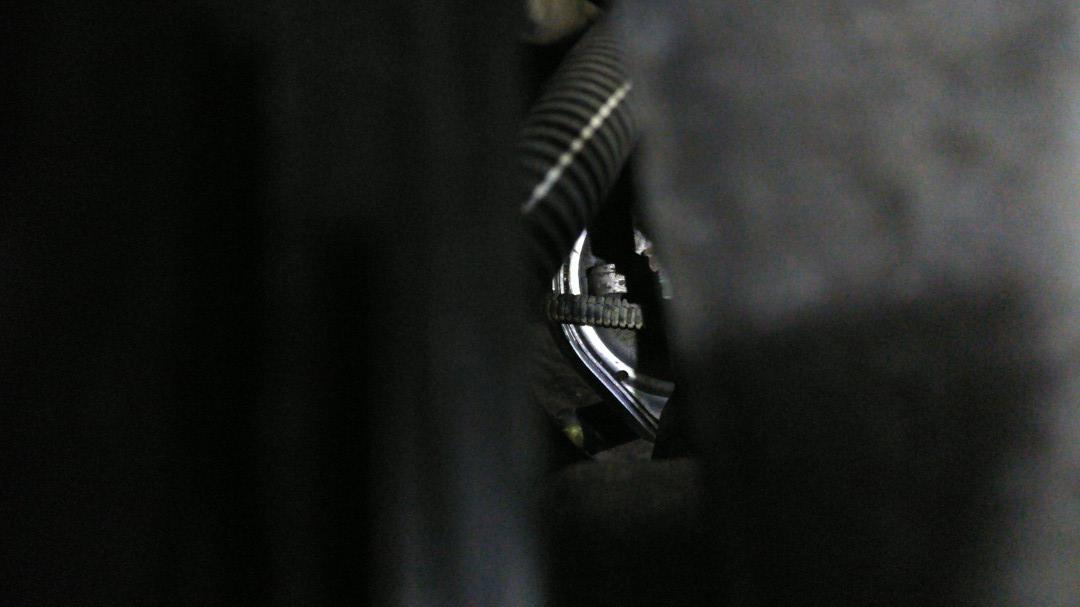

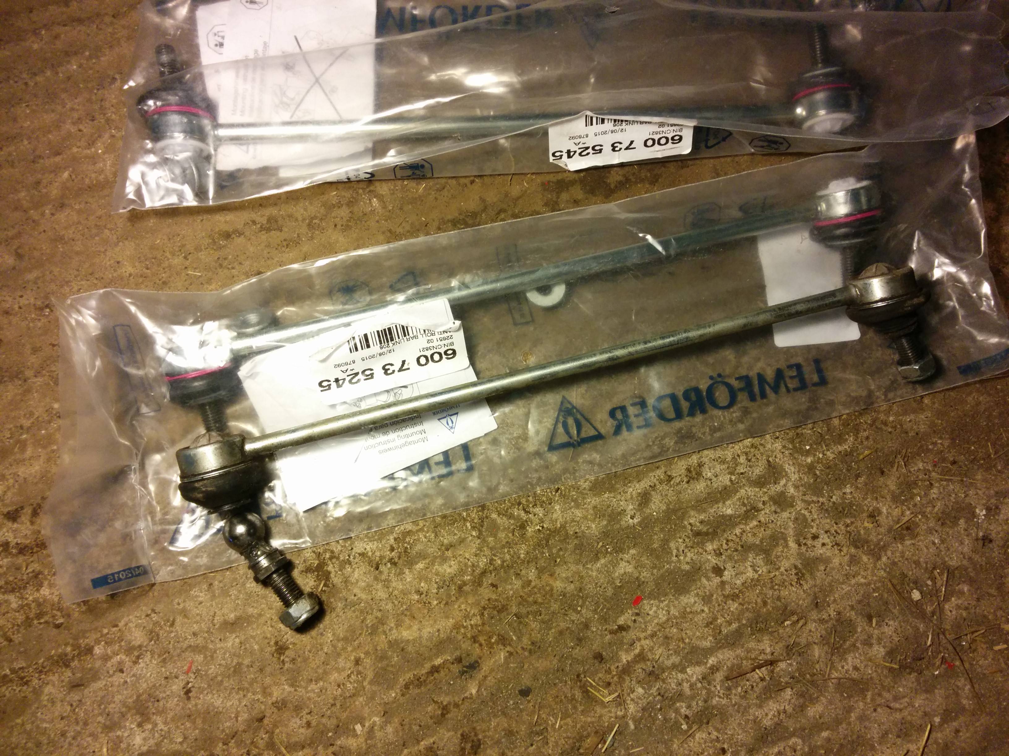

Unsure by what forces of nature this had popped out of its socket in the car's previous life
Could be closely related to the fact that the front drop was adjusted so low, even tyres would shred them plastic arch linings on full lock, and previous keepers wouldn't do anything about that Sad
I've adjusted the front suspension to a reasonable ride height, got healthy wide arch liners from the same pugperformancemotorsport (hard-ish to come about otherwise), and yet it was still a pig of a job to put new droplinks, without fiddling in various ways to jack suspension parts

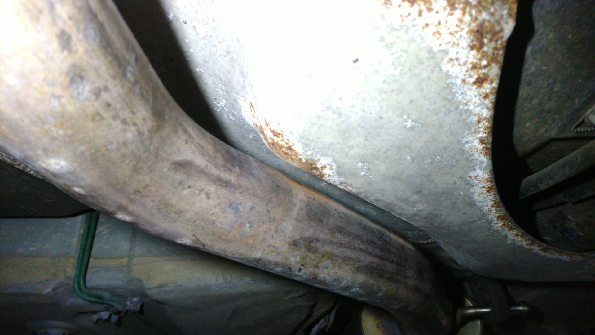

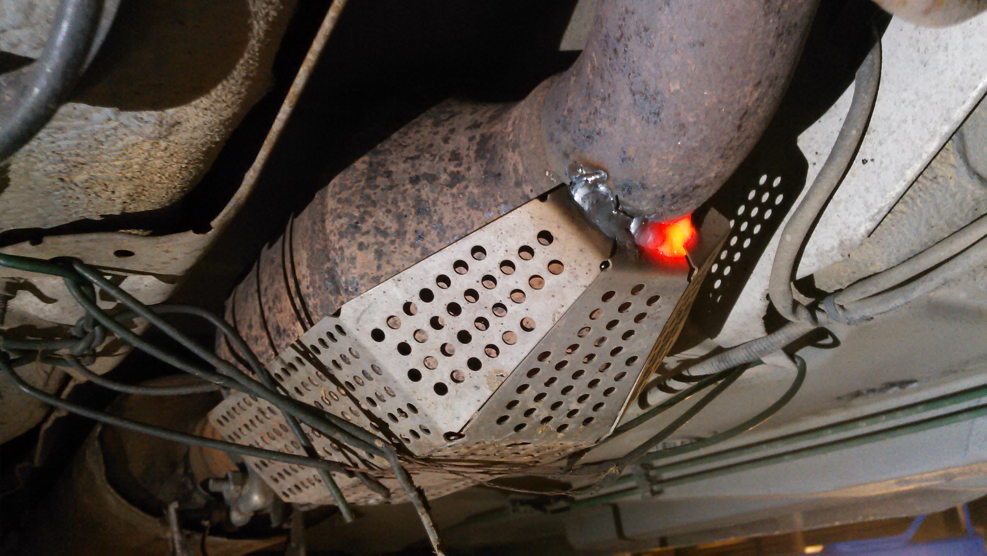

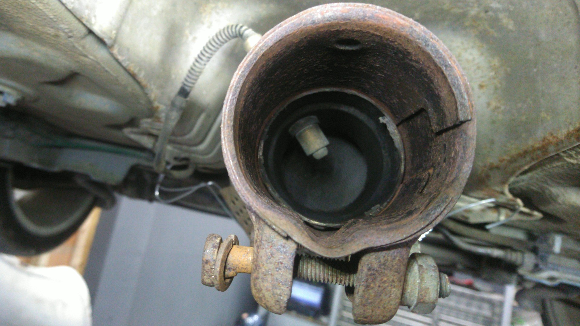

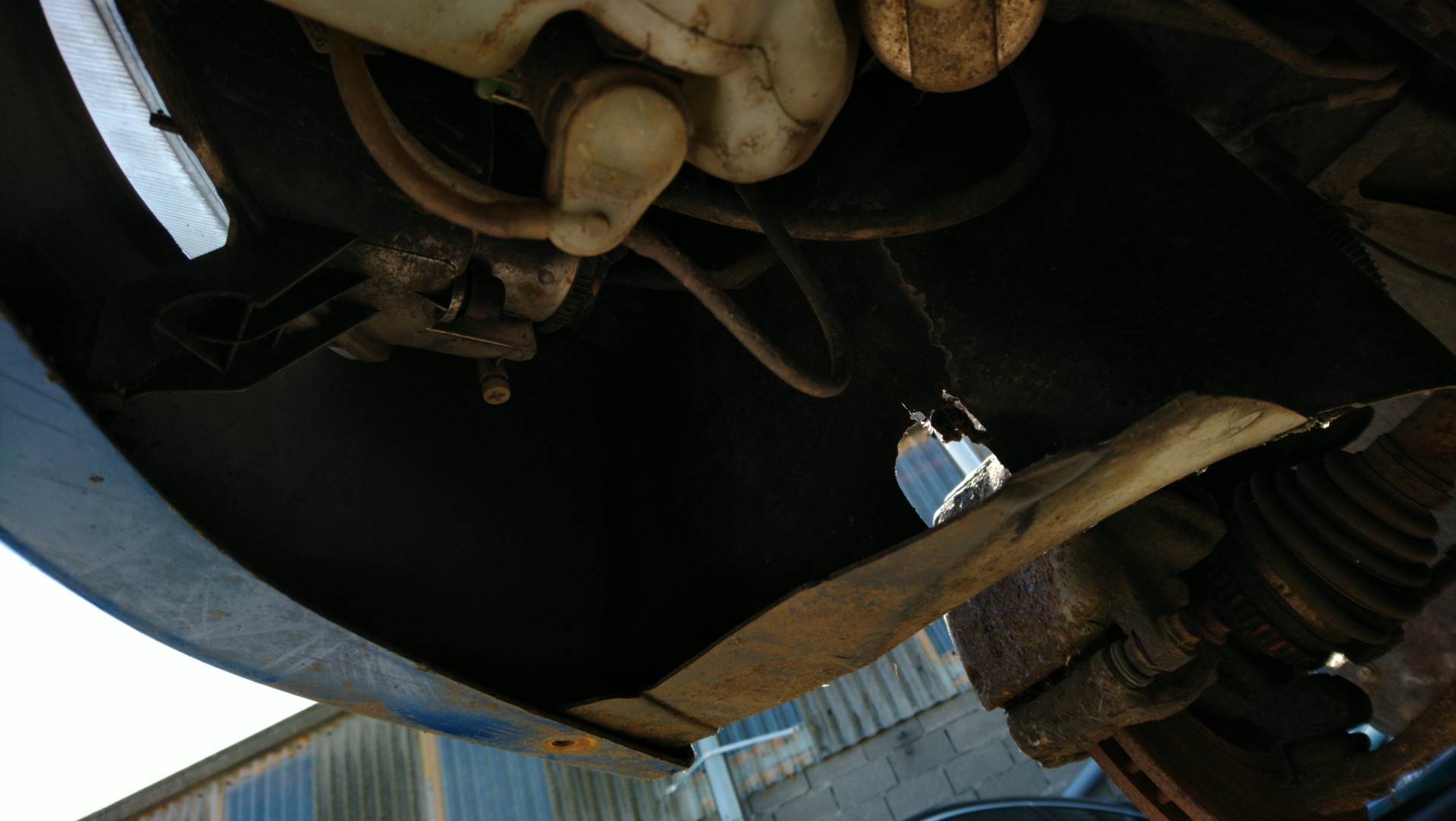

Never nice to find a snapped off cat heatshield, held by cables.. But better than hanging by a thread [sic] I guess
No wonder it snapped -- an oversized cat back coupler pipe had been fitted some time ago, warping from the heat, leaving a cavity for the exhaust to blow through up against sink welds and Scorp's resonator (imagine that horrid rasp exhaust sound too, the first thing to cross of the list once I'm properly at it)
Even stock cat's downpipe bulge-deformed from all that pressure...

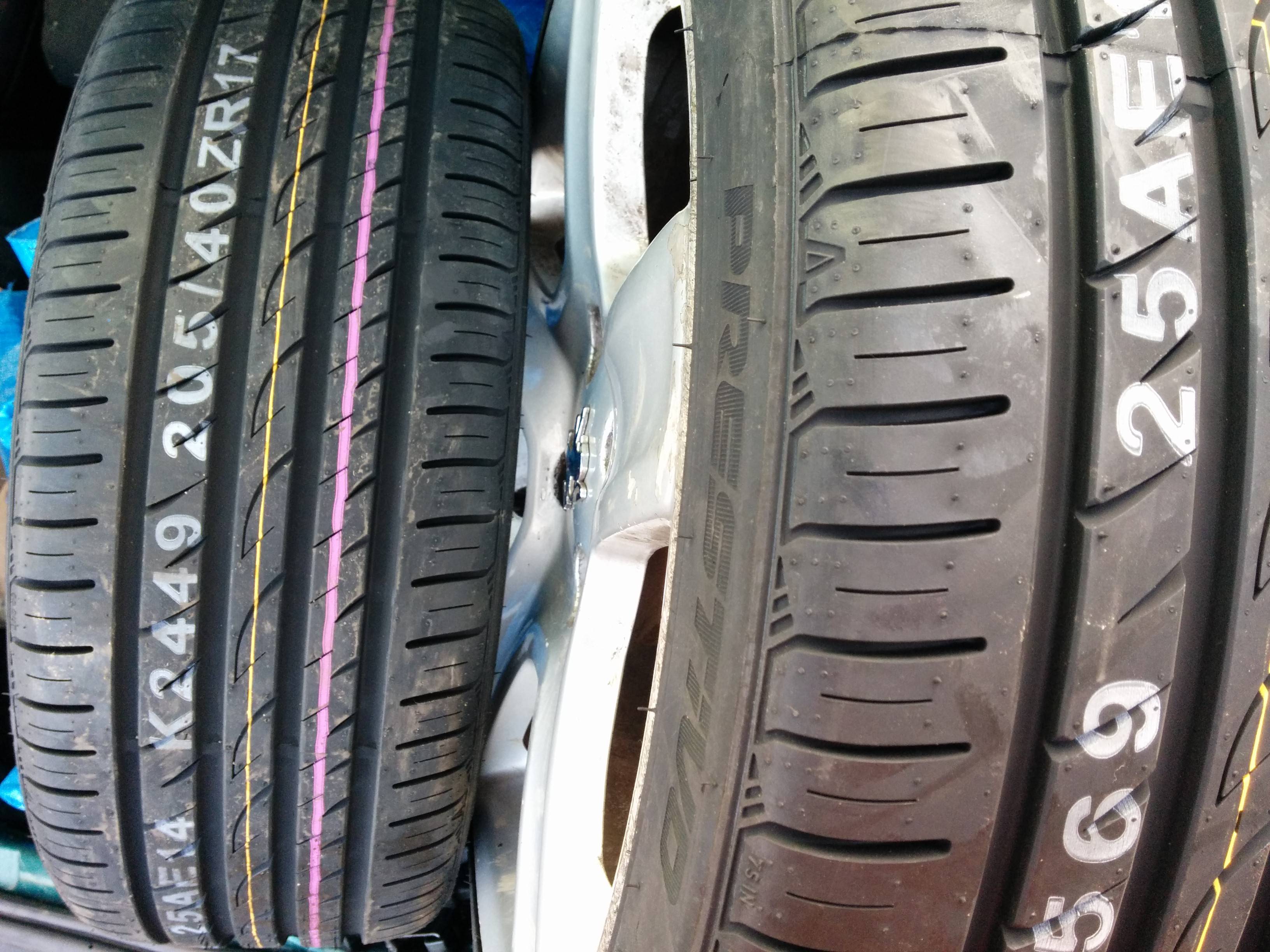

New pair-a-shoes at the rear! (replacing cord-exposed oldies, this car seemingly had a lot of handbrake-turned fun)

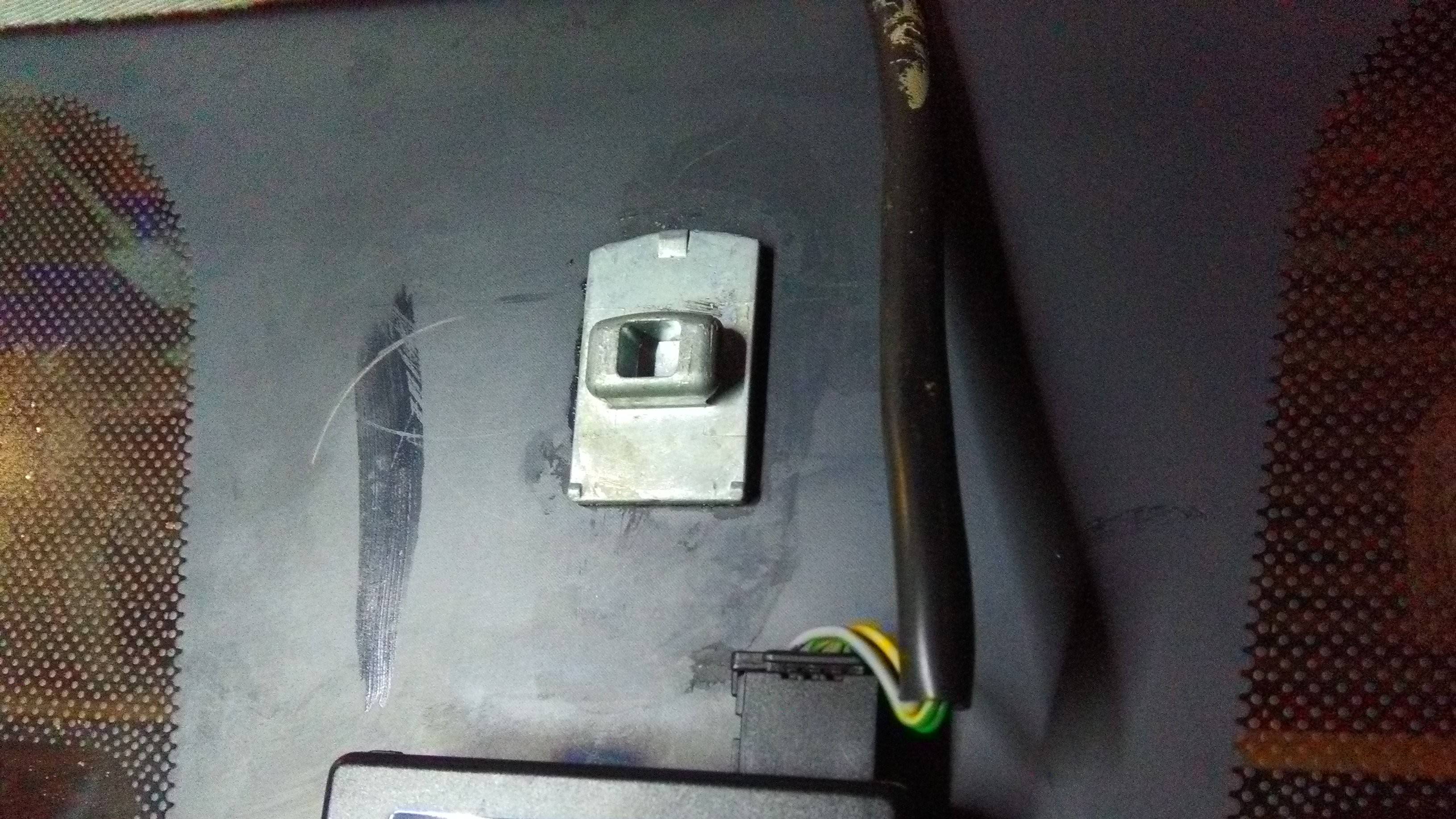

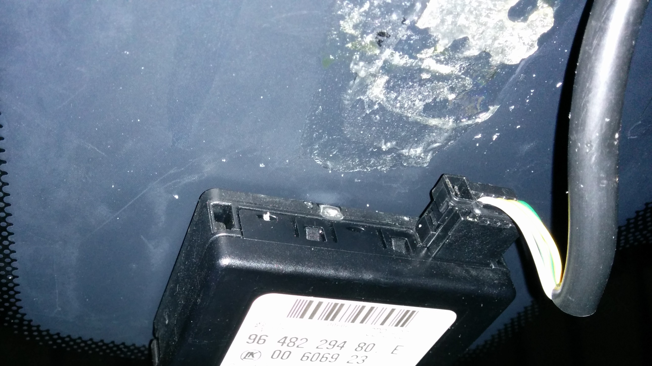

Rear view mirror was in the glovebox, and I thought it's ok to keep it there for a while, since MOT requires TWO mirrors to be on the car. However, there is a clause, that one of those two HAS to be the rear view argh!
Time was running out, but when you're glueing metal to glass, ensure not to rush Wink and hopefully not during winter, otherwise you need to keep windscreen warm for the best adhesion (I used hair dryer, but one more heat lamp from outside would've helped better)
Also ensure you clean the old glue bits properly, use a mono blade and acetone

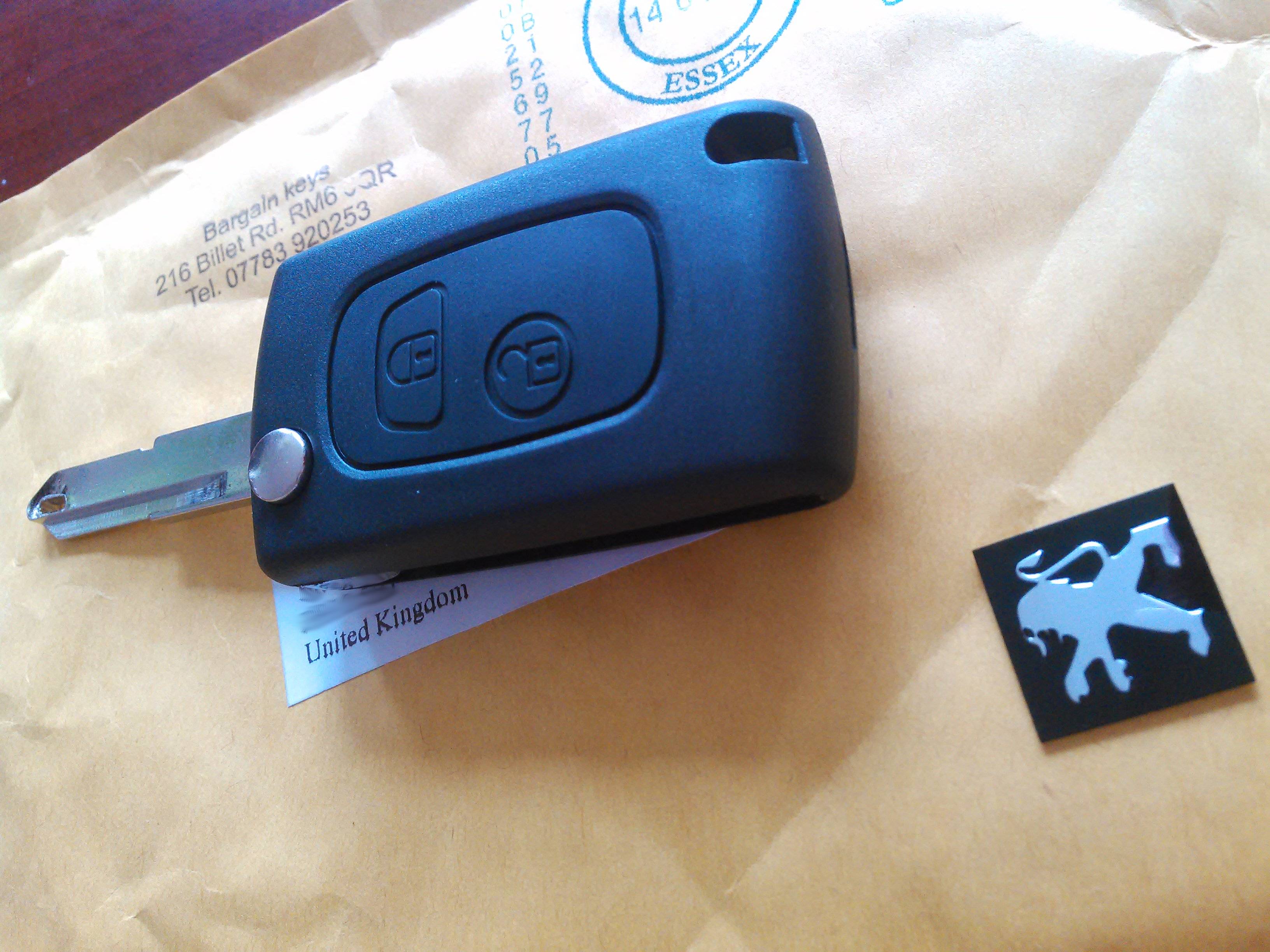

So MOT passed with flying colours (on emissions Very Happy ) made me a proud GTi 180 owner and daily rider. Since we've been mainly working on the unit, I'd done only a minor mod: MrWhite's keyfob conversion (received not as embossy pictured on ebay, oh well), holds to-date!
But look at that appalling logo! Ugh! Thinking of transplanting one from the original key, will need to nicely carve/mould the plastic out though

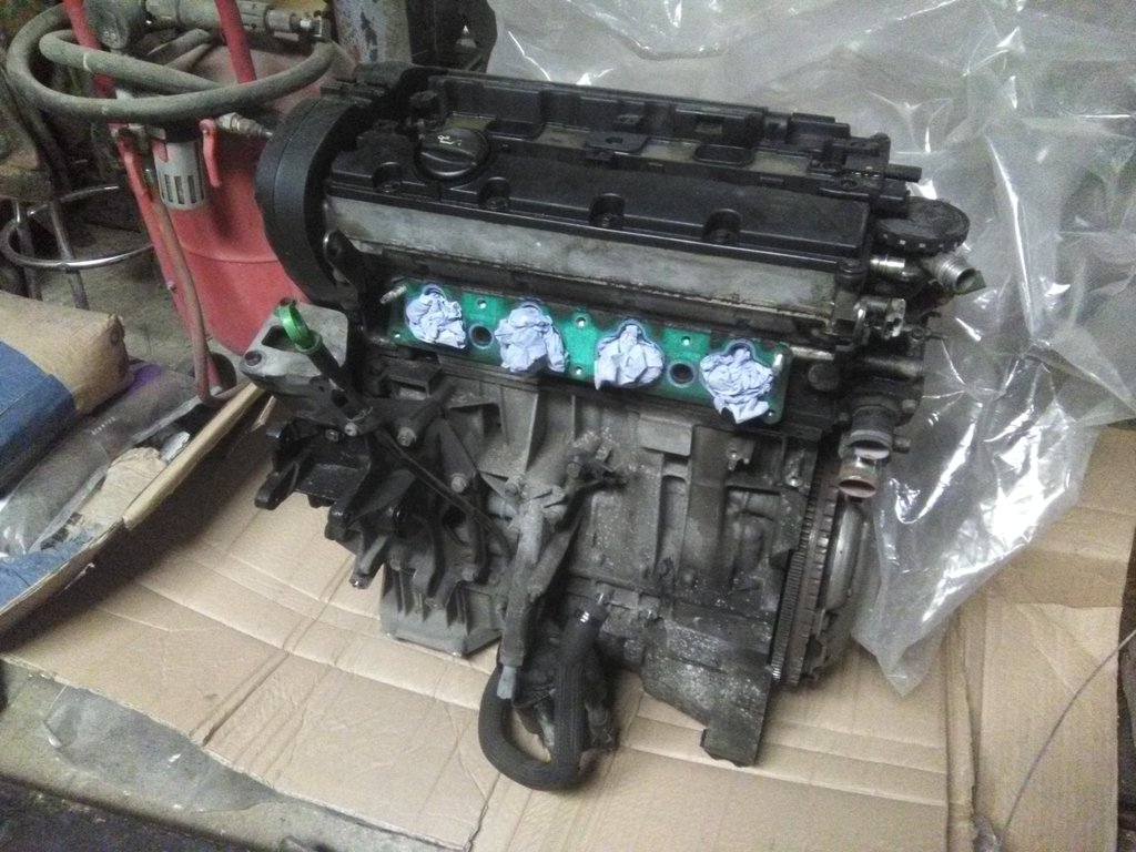

Brought another EW10J4S from Pezhdi (cheers buddy!), clocked in at 79k miles, will be a good candidate for replacement and generic study of these beastie lumps Smile

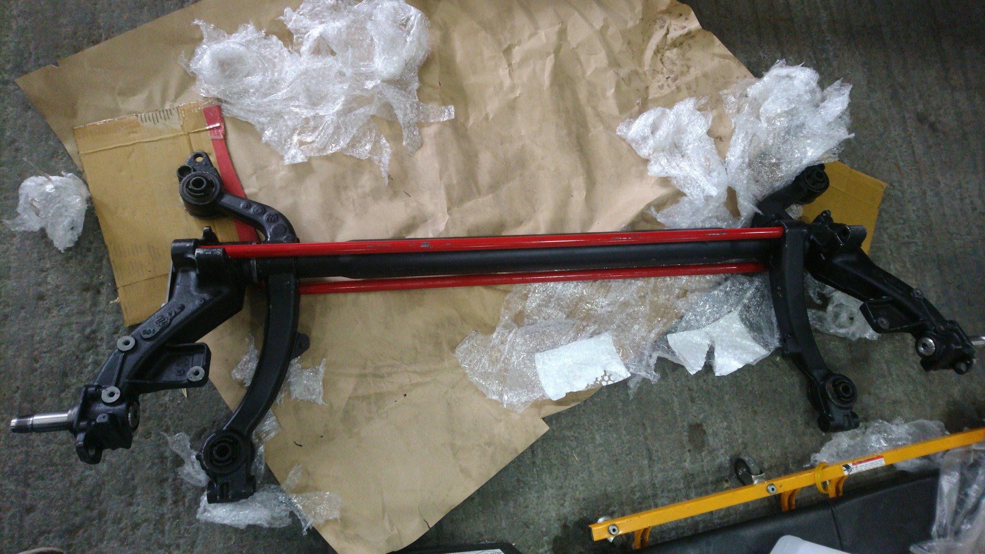

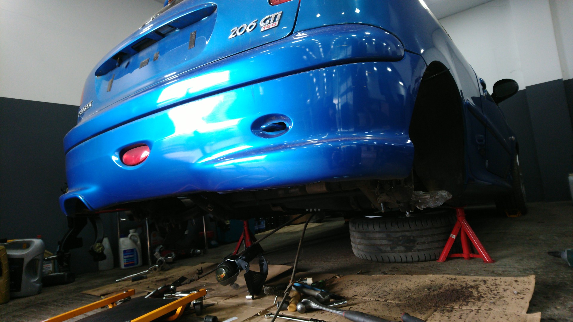

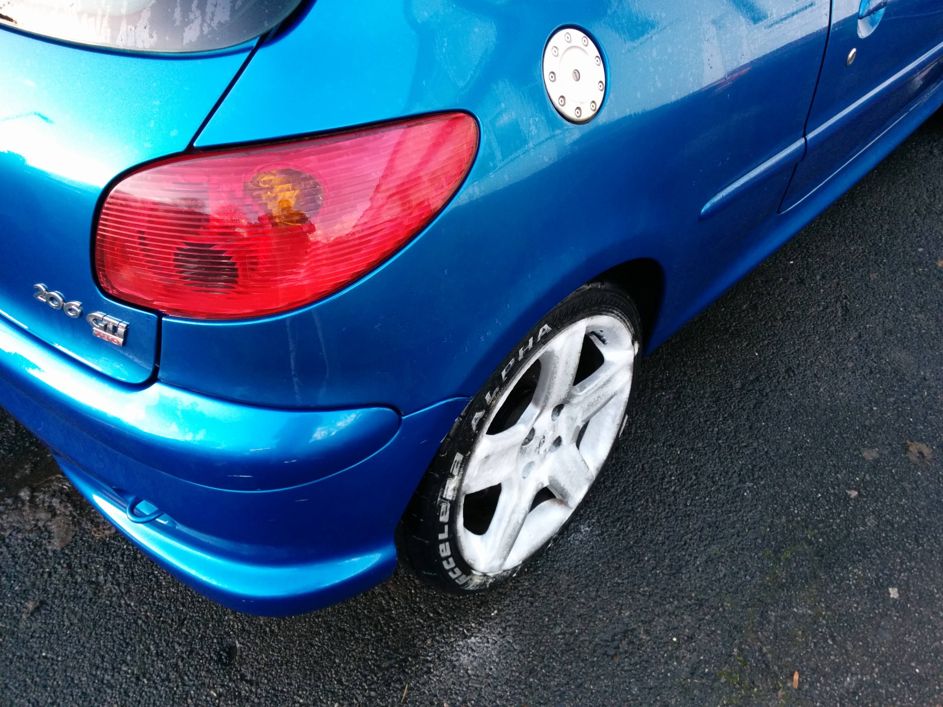

Noticed excessive camber on O/S/R wheel (actually, I should thank them muddy roads around the unit -- made me hear the dirt-stuck tyre scraping the inside arches), and decided to immediately stop driving the poor car.
Good job I was given this Jag as a freebie, quickly put it on the road, happy for now (2400mm and 3000mm lengthy building materials fit into it perfectly -- brings the completion of our unit quicker Smile )

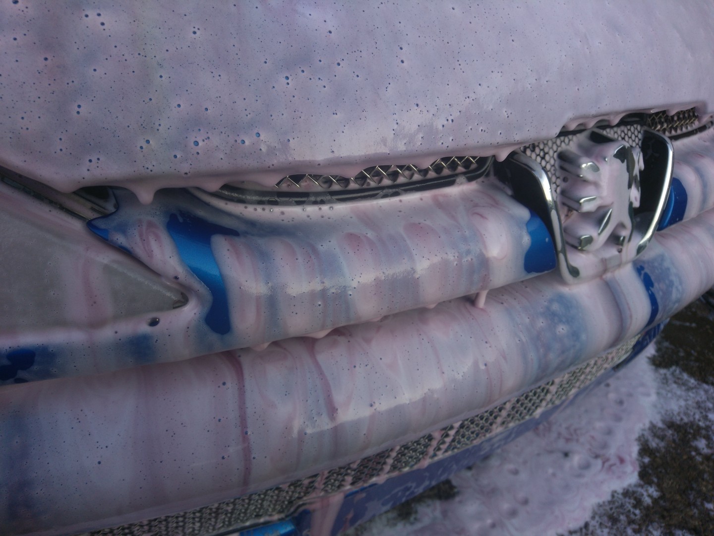

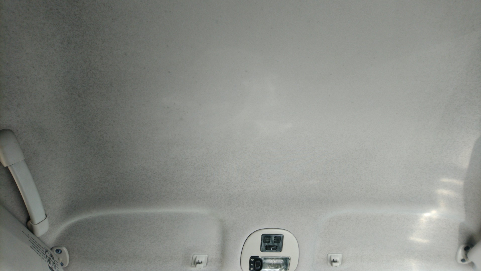

Whoa it's been two-and-a-half years and I've finally gotten round to bringing the GTi 180 back to life again. Things done over past two months:

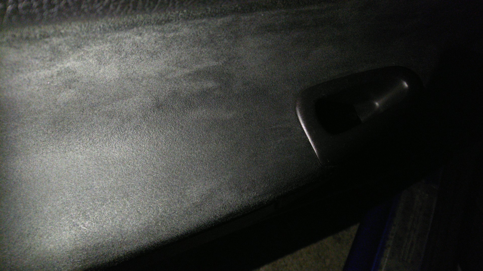

Race Glaze Alcantara Cleaner, smells bit like ammonia killing that mould
IronX and snow foam make a French flag on that Aegean Blue lol
Replaced door seal I got from PezHdi when he was breaking a 180 in Aden Red years ago.
Had hopes this would be less weathered and prevent water ingress in the everyone's-known weak spot

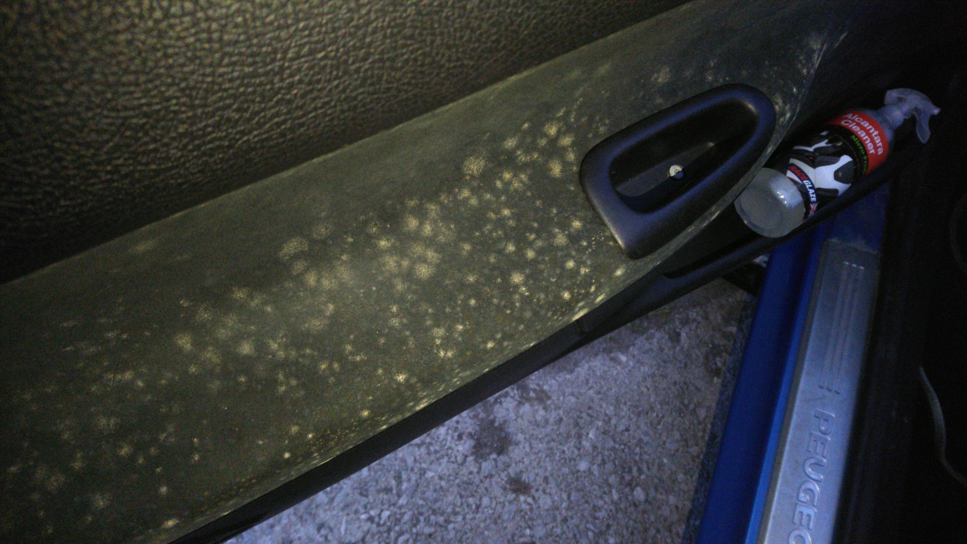

What distilled vinegar and a watered shoecare brush does to mould befores and afters (beware not to soak the head lining too much or it will shrivel!)

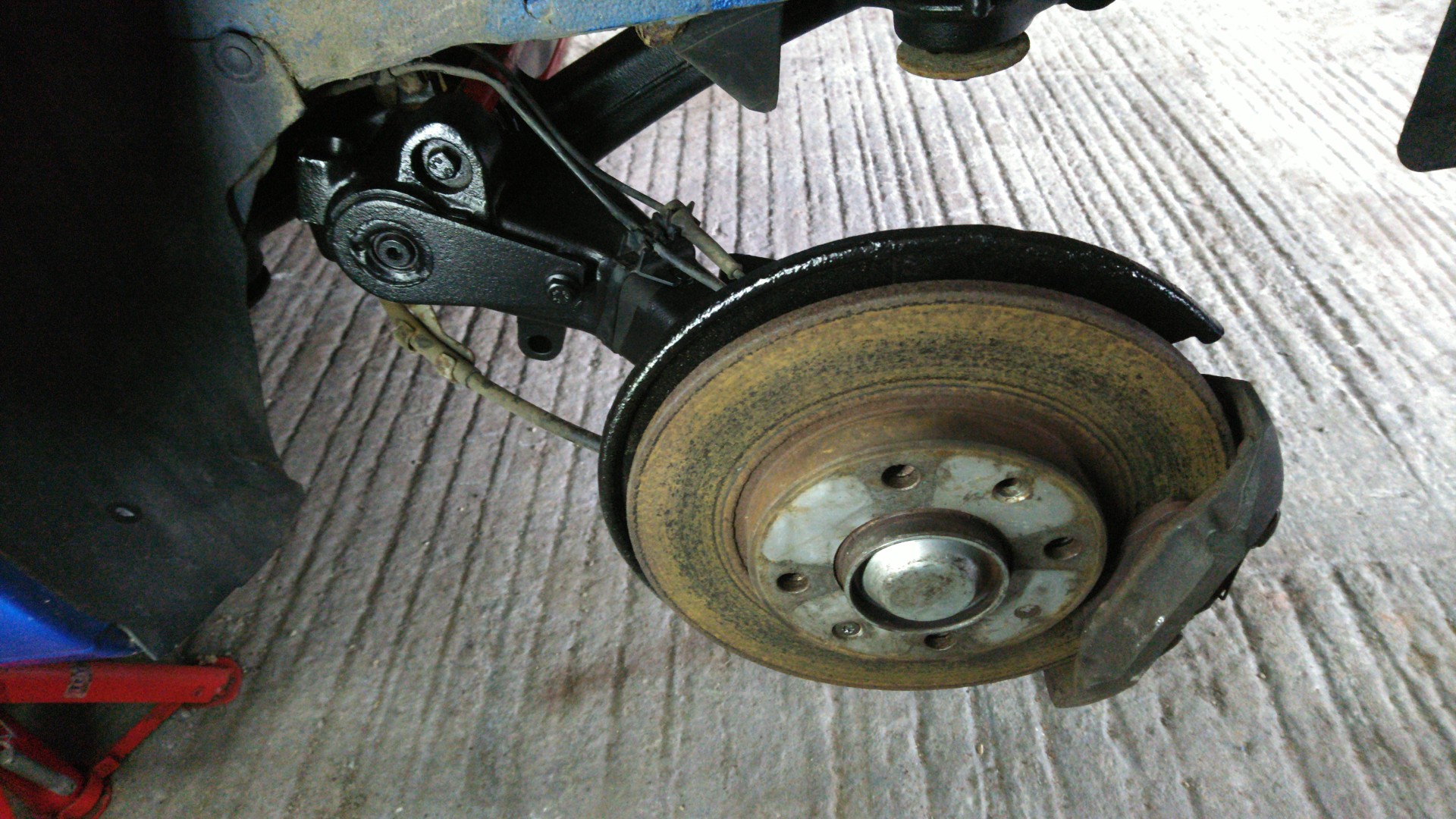

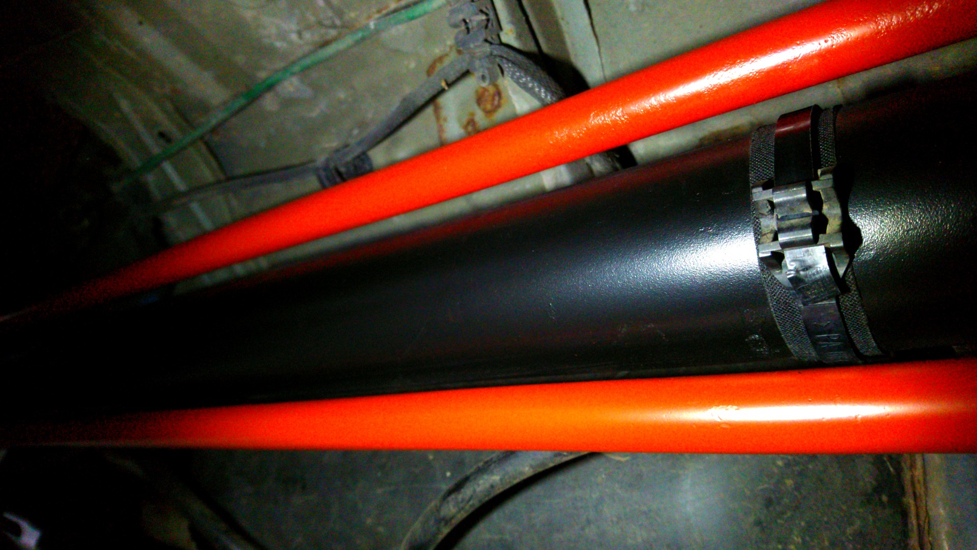

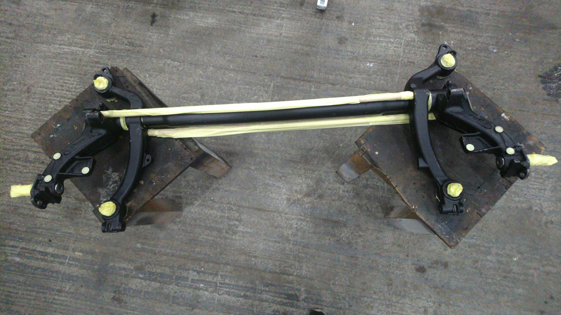

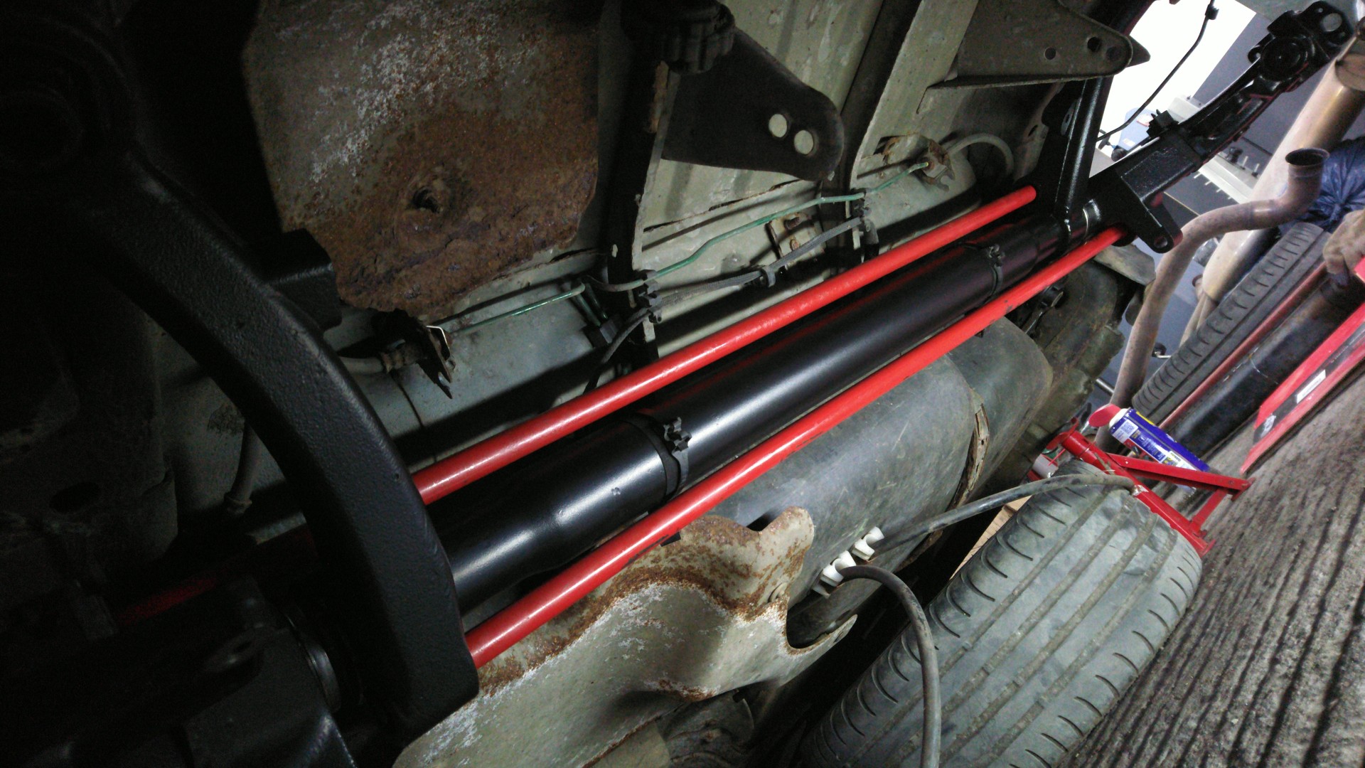

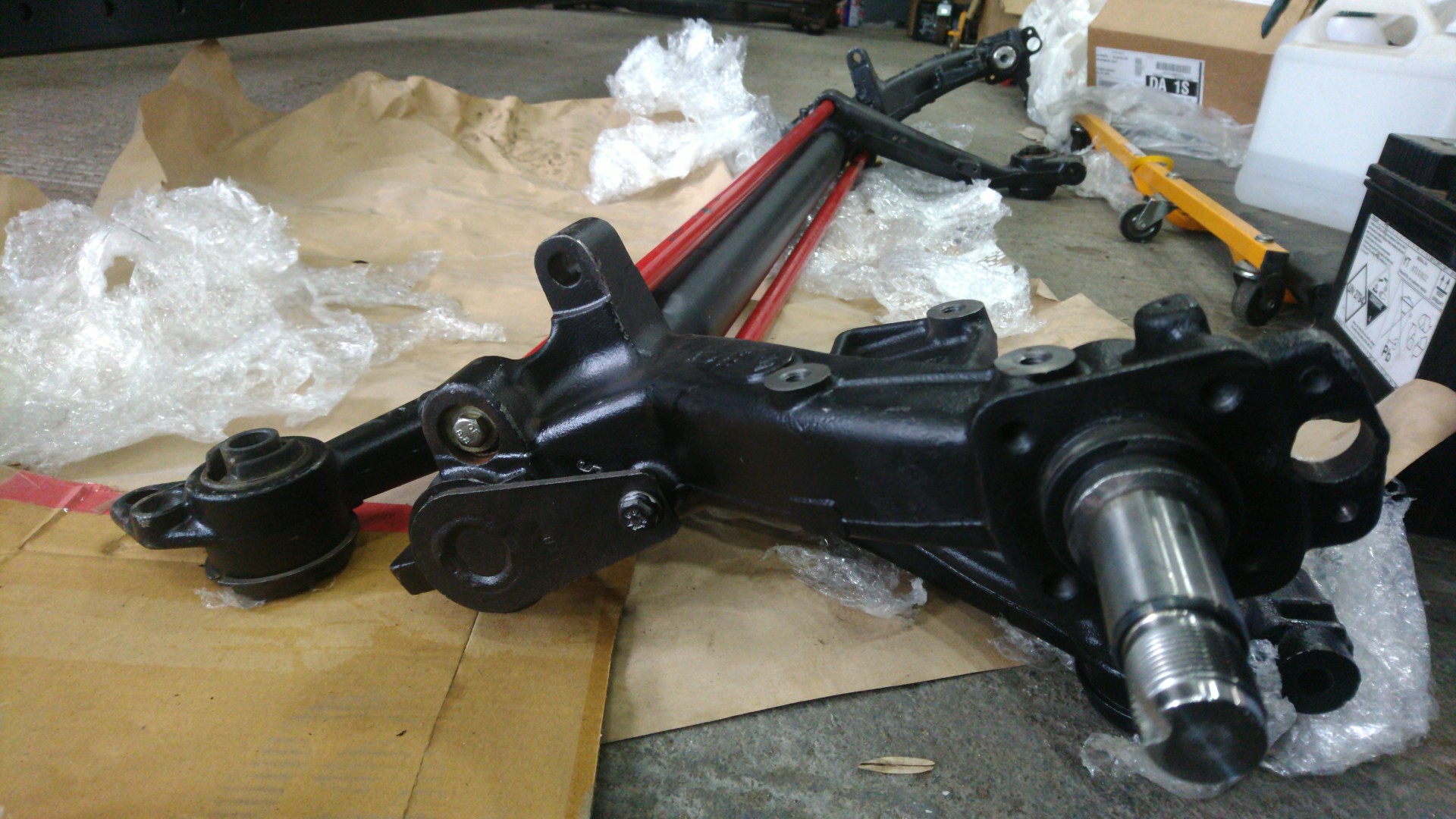

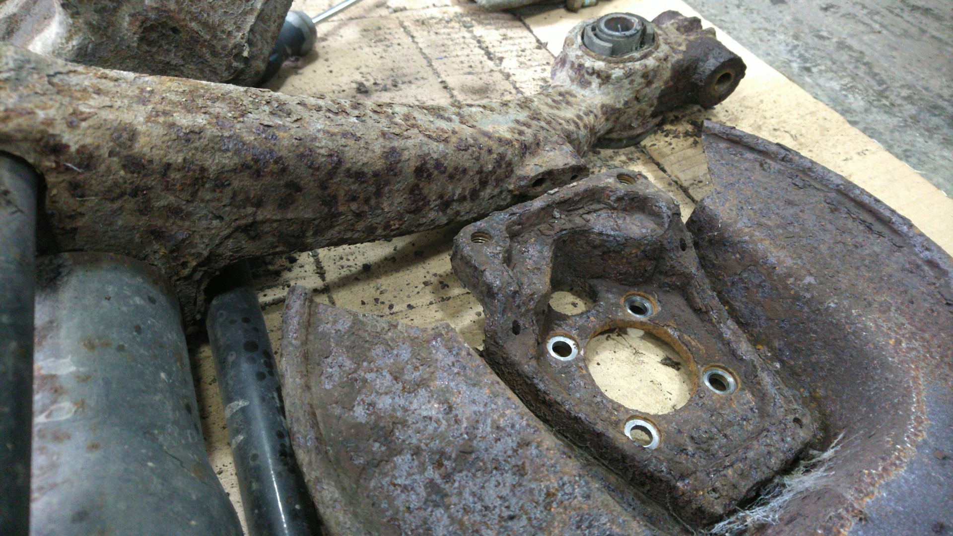

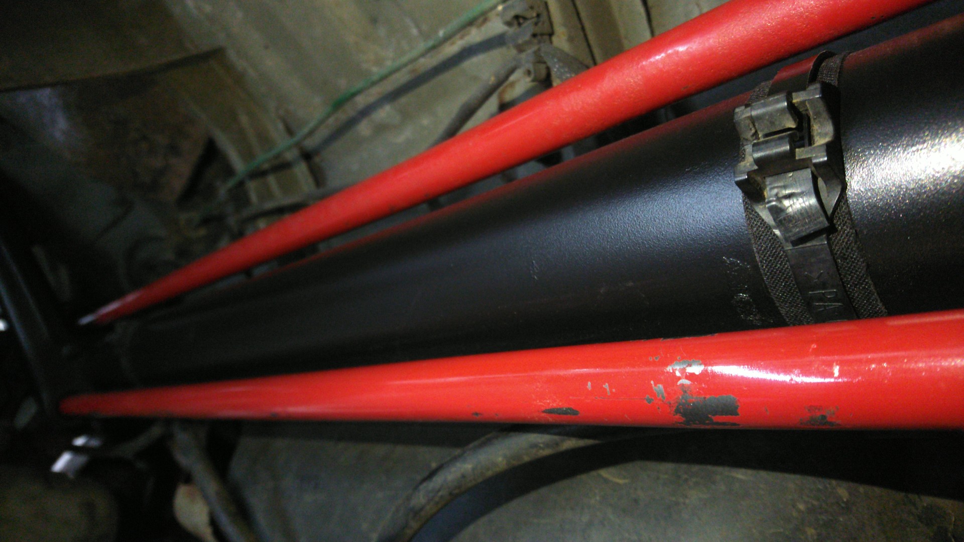

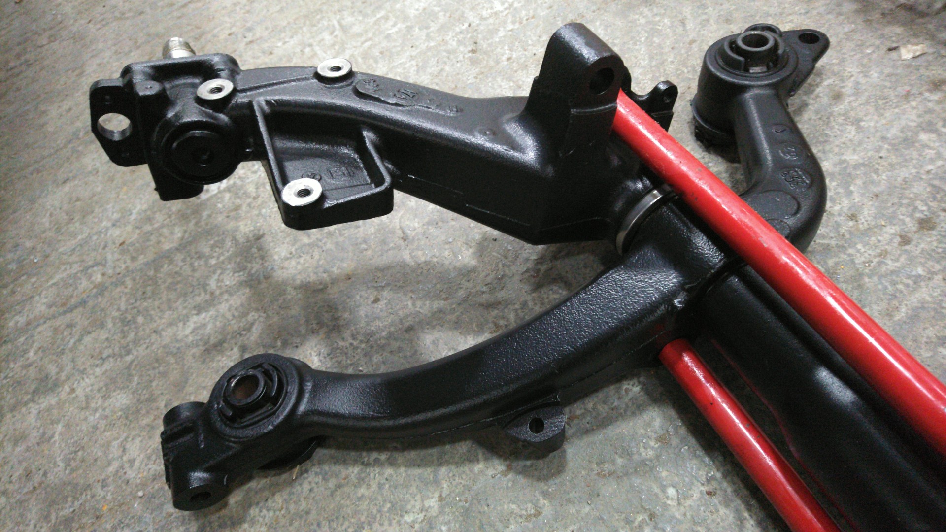

Finally the replacement for the culprit that I stopped driving Blue Jay back in 2016 altogether

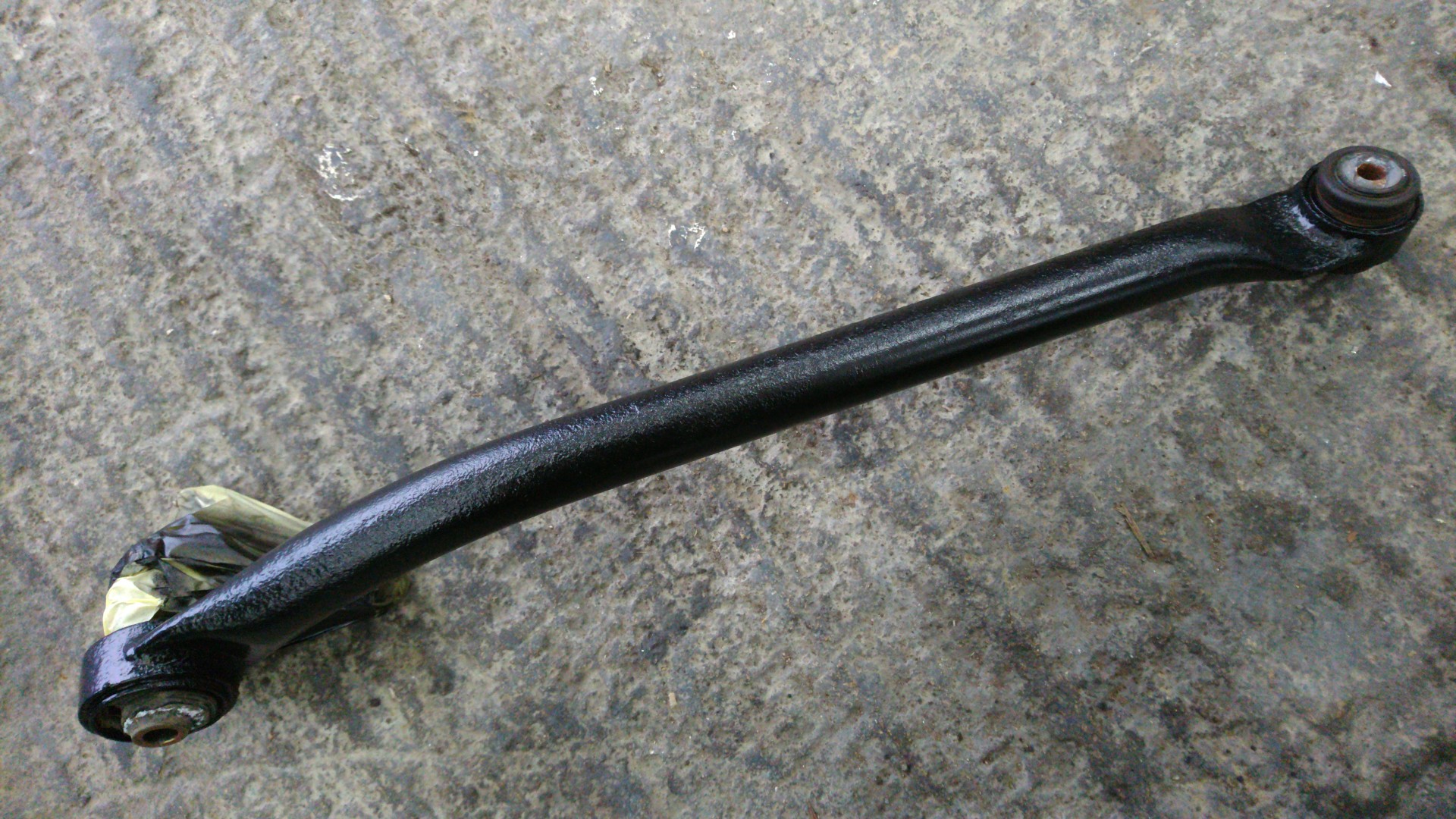

Axles from IMAxle arrive with a thin film of what they call "paint", which starts converting itself to surface rust already on the workshop floor (happened to HDi recon axle)
Following the path of experimenting that I always take, decided to prep the paint (clean, degrease with IPA, then finally with cling cloth) and coat it in Hammerite Metal Paint (in satin black, sadly they didn't have matte, which would've resembled an axle made of plastic -- is what they are anyway!)
After mostly 4 coats everywhere, while some areas left only in 3 to see which will wax and which will wane
WIP
The oldie was worse for wear
Experiments with sway bars, since Hammerite boasts to be "straight-to-rust"
Back on track (queue people with adenoids to tell IMaxle off for painting 20mm torsion bars in red Razz but I like it gives more sporty look and left it that way)
Gone stealth with the brake disk protectors, same rust-overpaint experiment as with the sway bars
Brake disks would need changing ideally, but these+pads still got some meat in them, will scrub up until I reach the MOT station (hm maybe worth driving with handbrake on for a bit)
Also as well, managed to replace the rear brake caliper (the one with the Snap-off-it's-French bleeding nipple), let the replacement one trickle the brake fluid through after fitting, and now the brake pedal is no longer spongy! Didn't even have to bleed the system yet.
Got camber? Old knackered axle vs new recon axle

As per the first post, exhaust "custom" coupler had been too big, pictures speak for themselves
Missed a bit above, had a minute leak [sic], then went generous with the fibre paste
the inner coat hadn't cured for a week due to no contact with oxygen, and from the heat would swell like a balloon what a laugh! Made strategic incisions -- rock solid now and no more leaks
System had been "aligned" to see the Scorpion logo showing on the exhaust tips, at the expense of fouling the heat shield
All sorted now

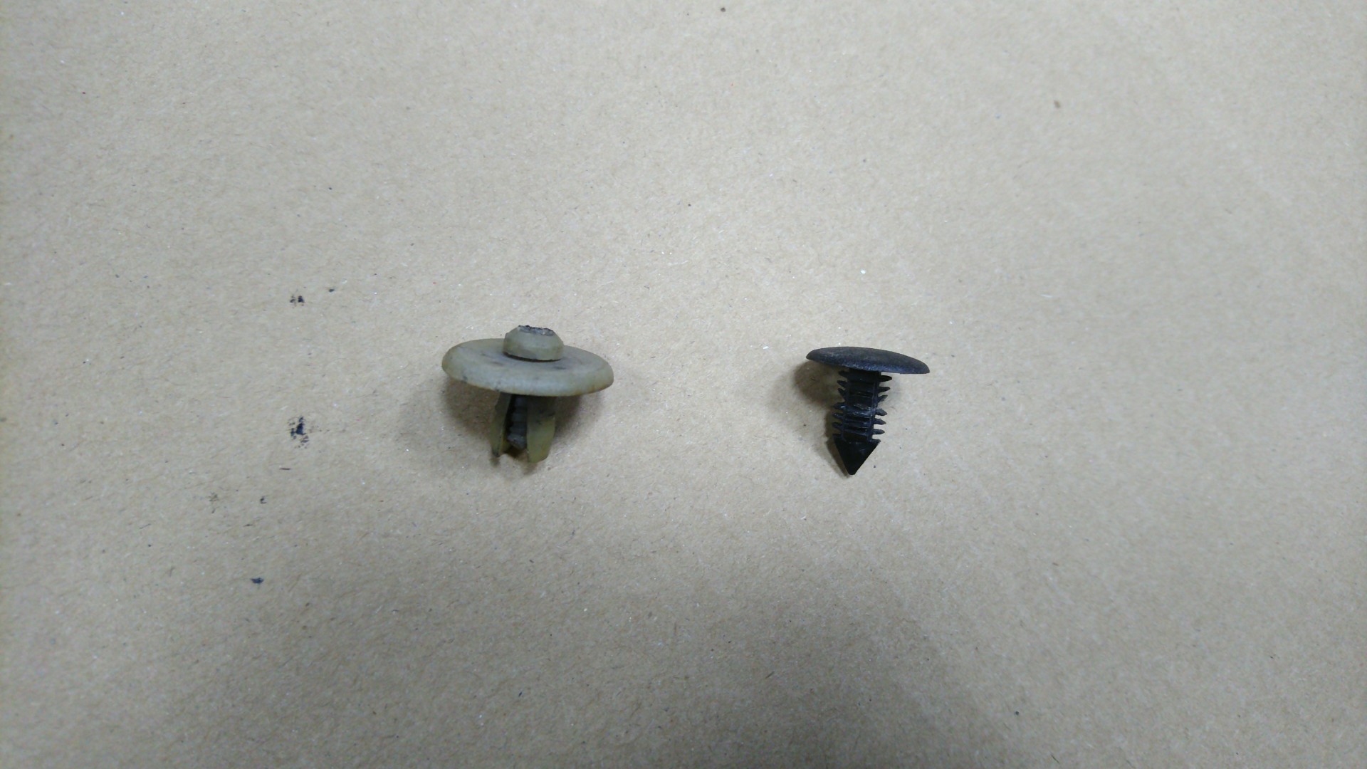

The shield's become loose also because some hard plastic rivnuts had been replaced by these black bungs

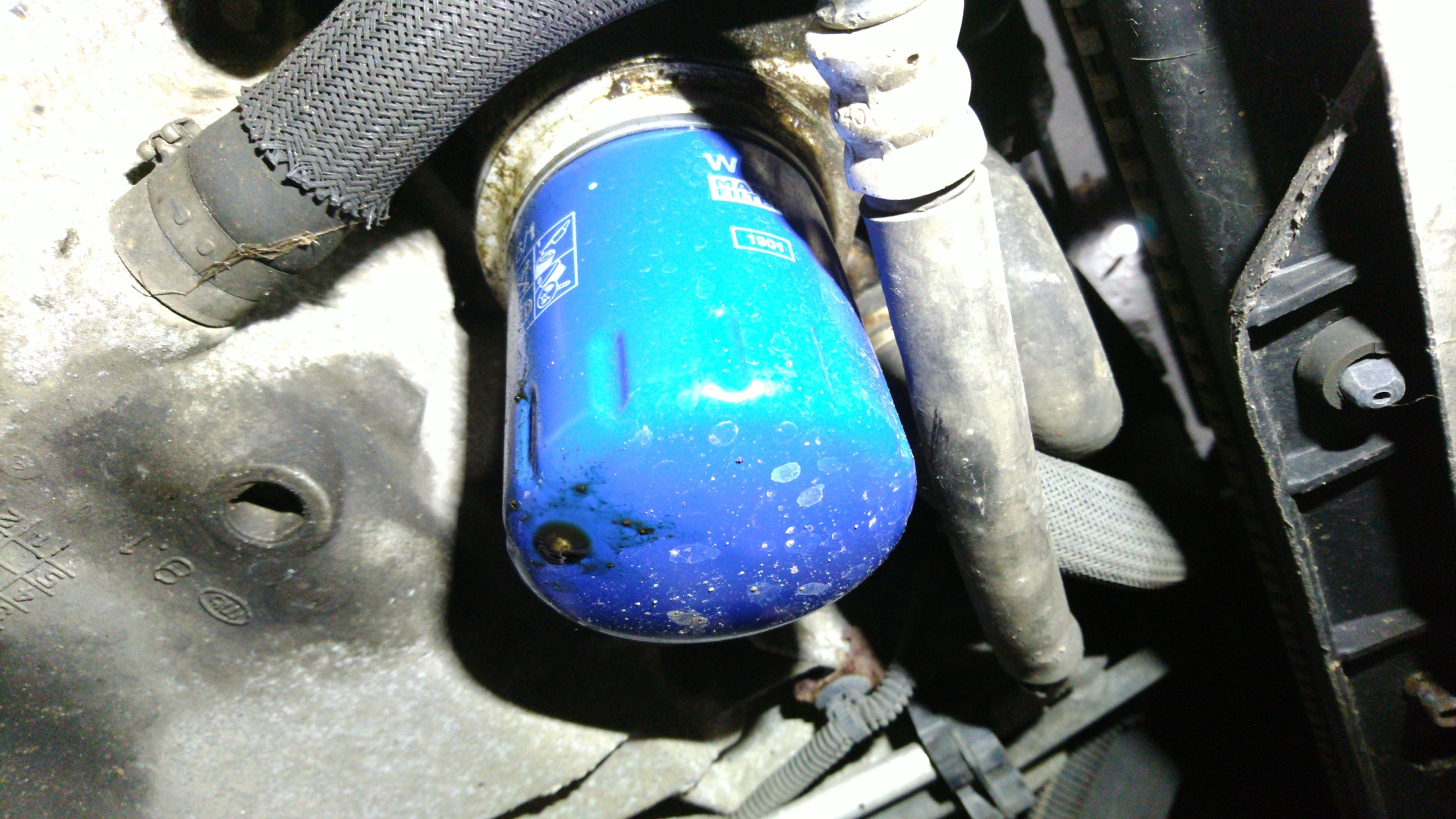

A drop of oil on the filter kicked off the hunt for its source
Washed everywhere around the area, replaced oil and filter, and finally identified the leak: the top of the oil cooler housing. The seal had been mangled, most likely due to over-tightening the oil filter
oil cooler seal looks suspiciously like a simple filter's one, only with rounded edges Smile
Befores and afters when you look through the intake manifold down at the cooler (it was gunked up!)
Had the torsion bars temporarily greased up to prevent the exposed bare metal from rusting (that's how the axle came in), the time came to coat them properly, found some red oxide spray kicking about
Final assembly:

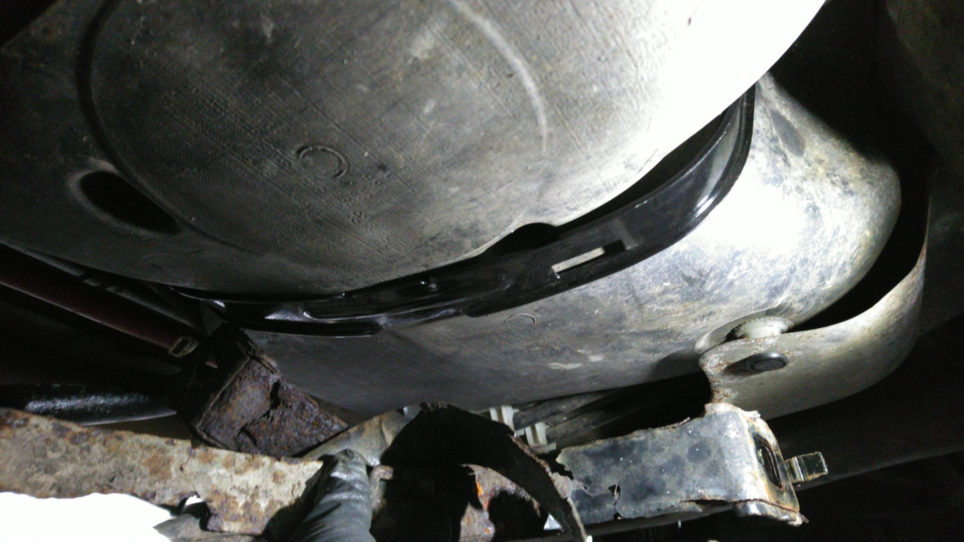

And not forgetting the fuel tank strap that had been held by the fuel tank

While eliminating more rattles, replaced the lower arms with MOOGs from ECP. The most noisy even had its metal bushing part missing.....
Once I was at it, replaced the old rear engine mount, however I couldn't wait for parts, so just grabbed one Lemforder I had readied for the HDi, let's hope the rubber params are close! Smile

Big debate on whether the stock front ARB does you any favours when you're on static suspension (read adjustable shocks'n'springs, mostly tailored for track, not potholes Wink ).
I reckon the ARB has to match the stiffness of the strut, and factory's 21mm is nowhere near that.
I had done away with ARB on the HDi, including the bushes and brackets, and it flew through MOT no probs.
This time I left the bushes to prevent exposed subframe parts from rusting, and it'd flagged up during the test. So I had to put the whole shebang back, threw in some polys that were kicking about unused in a drawer, and more MOOG drop links, a brand that ECP seems to be pushing.
No change in cornering, I wonder what it does during the potholes Smile
