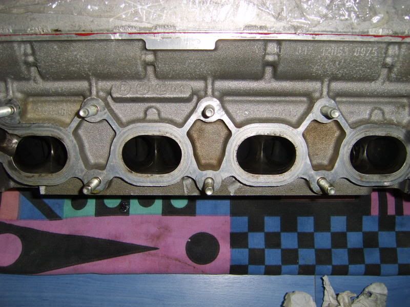

Jamie wrote:
Ah I see what you mean now... *facepalm*
Apparently the EGR valve acts like a 5th branch from an exhaust mani when unplugged and not blanked off properly?
Ity just bleeds air off one exhaust port and feeds it back through the head into the inlet.
It's in this picture just at the left hand edge.
Jamie
PostPosted: Wed May 05, 2010 3:54 pm Up
Posts: 3327
Location: Ring y0
It's a much worse design on the EW rather than the TU then from what I can muster together. The 106 GTi has a pump to feed clean air into the cylinders.

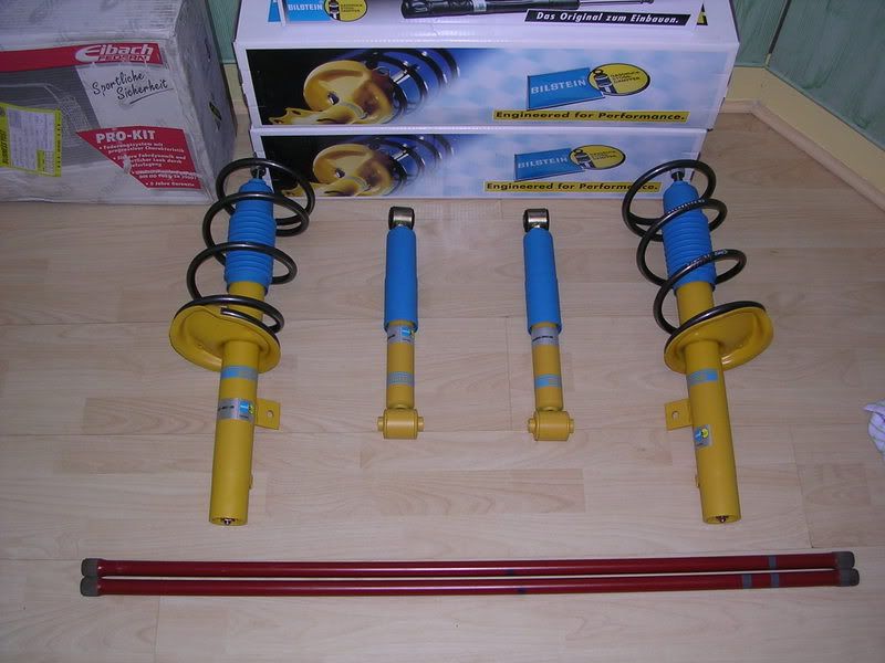

Edward wrote:
Suspension got fitted...
Eibach Pro Kit springs, Bilstein Sport dampers, Peugeot Sport 21mm torsion bars (gravel rally spec).
Do you know the reference number for those torsion bars? I can't seem to find them on the Peugeot Sport website...thanks
ZianDesigns - Website designs
PostPosted: Fri May 07, 2010 8:48 am Up
Look under 206 XS at Train Arriere
CC17010-21
CC17011-21
€194.65x2=€389.30 + approx €50 for postage (They charged that for my GP A wishbones) = €439.30
Which according to the Financial Times is about £378.59.
Bargain!
