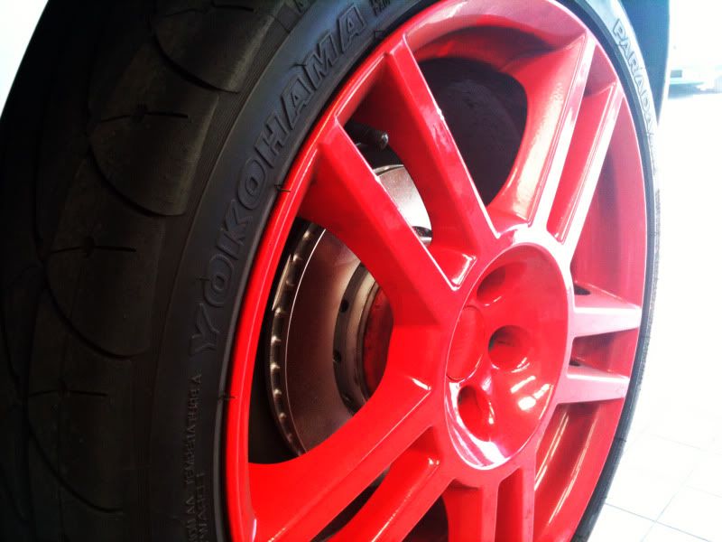

We also figured that the wheel bolts undoing themselves at speed was due to the Powercoating preventing proper contact between the Wheels and Bolt Seats, we removed this and I've spent today out on a "spirited" drive and everything's tight Very Happy

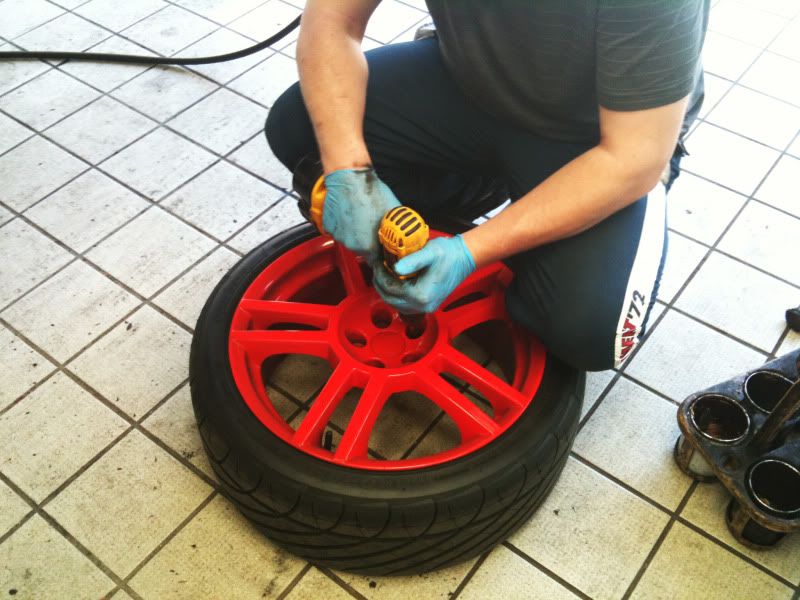

Techie sorting out my wheel loosening issue. Removing powdercoating from the Bolt Seats

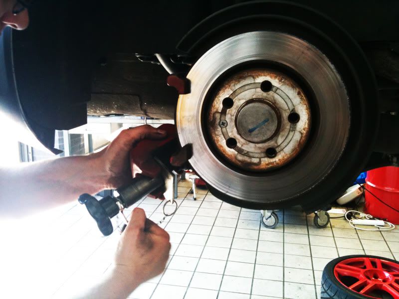

Caliper Piston being wound back in
Old Discs to come off

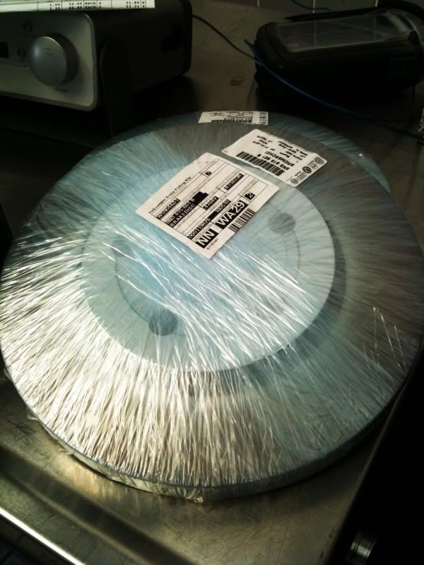

New Rear Disc

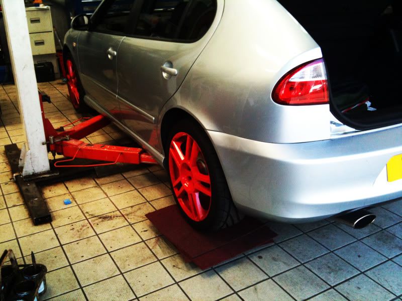

Getting the Car back onto the ground and off the ramps is always a challenge Laughing
Also lowered the front a little more Very Happy Cheers for doing the work Techie, much appreciated Very Happy
