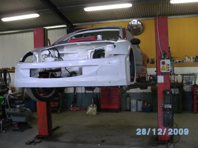

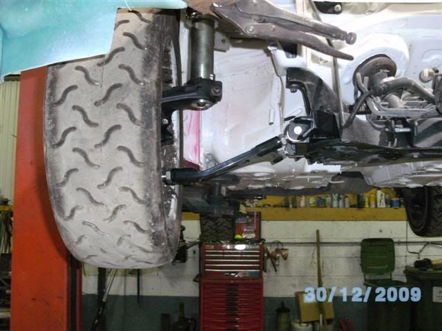

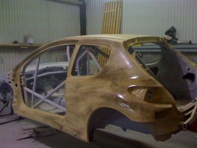

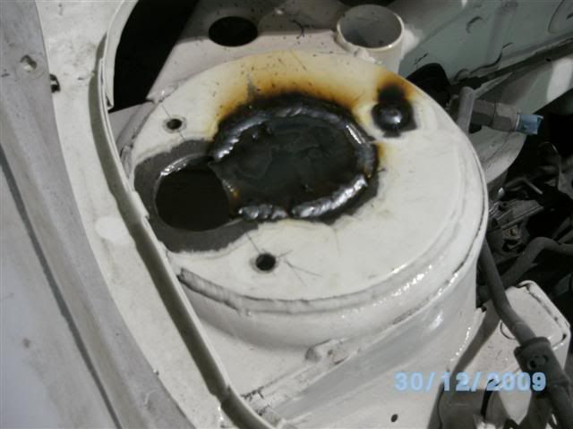

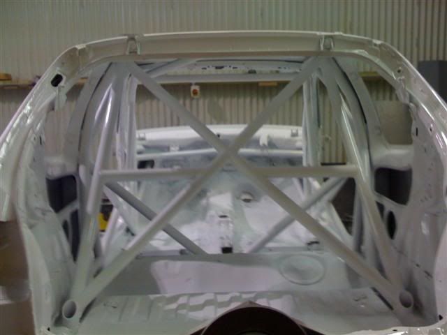

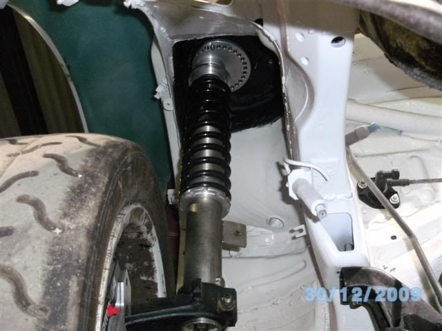

Hi back again some may have seen build on old post ill just try to give a breakdown of progress so far and a few pics

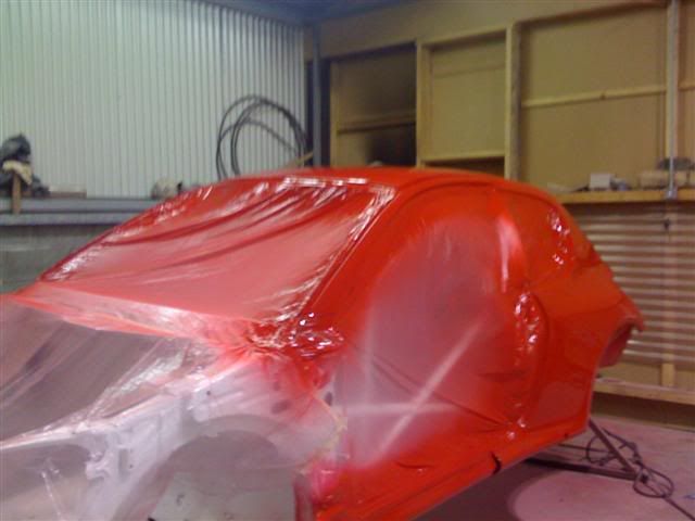

its my 1999 206 gti full tarmac setup wide track rallycar
Done to Date
Shell stripped, seam welded, painted,roll cage fitted ,wrc rear arches fitted, front track widened,rear track widening in progress
plans
finish track widening
Fit wrc kit
engine build with mtech ecu, tb's, kent cams, steel rods, high comp pistons etc
will post more details of full spec as i go along
thanks for looking any comments welcome

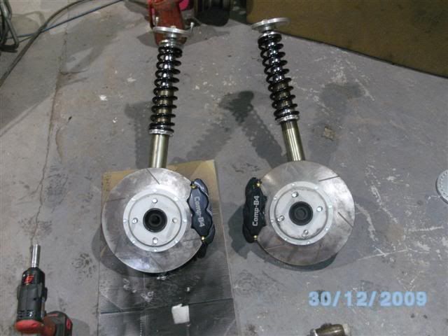

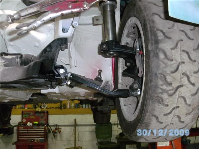

i have new wheel stub pins made and a spacer unit to move calliper bracket out so instead of wheel spacer to move wheel rim i have moved the whole wheel bearing & calliper etc out
i have it all fitted today and will upload pics when camera charged

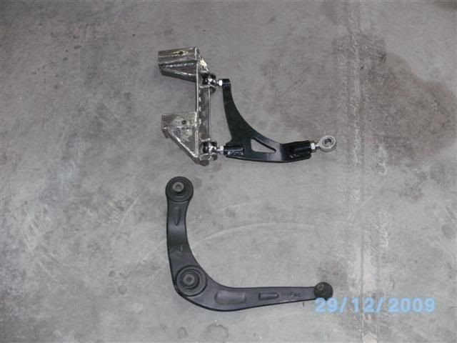

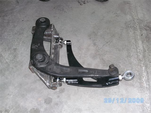

205 front arms, interesting, certainly not what I would have done but I guess it works!

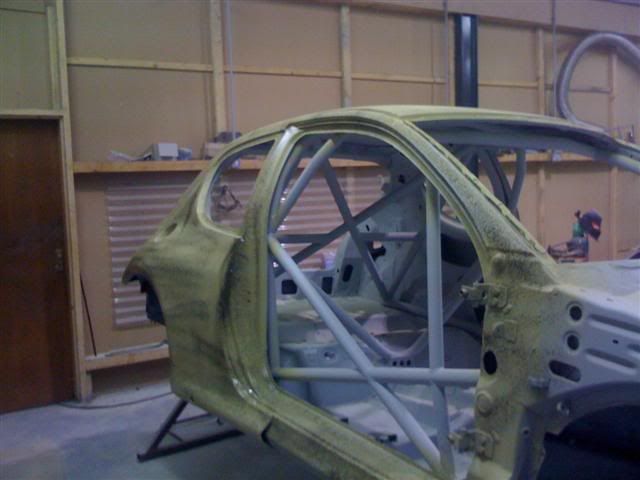

WOW!! I would love to be able to do a project like this! Where did you get the roll cage from and how much??
i was going to modify the subframe and use orignal wishbones but as the 205 arms are rose jointed already it was a simpler option and give good steering geometery adjustment
out of curiosity what way would you have done it?

Would have made the wishbones from scratch to fit the original subframe personally... might have been more expensive but would have been worth it from my point of view.
Still looking a good build get some more piccies and info up.
Thanks its a bit of a slow project at it nearly 18mths and its just a rolling shell
started off as just a gpa build but when i fitted the wrc kit the wheels were lost under arches and wasnt keen on widening it using spacers so widening the track was the best option
its a custom cages kit not 100% sure on price i think it was £800

Hi who is the cage by and how much all in? Is it a safety devices cage? OMP? If its a full on rally car is it an FIA approved cage? Or is this project just for fun really Smile
Interested to know alot more Very Happy Massive respect for the build so far ..
