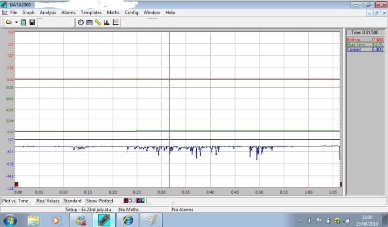

Did some data logging earlier. I reviewed some of the data and on occasions the coolant temperature suddenly dips. The car was run for ten minutes then switched off for 10 mins. The car was then driven for another 10 mins then sat for 10 mins. Then I drove the car and it did the cutting out problem where the engine dies and the rev counter dips to zero.
Analysing the data from the Omex it shows the coolant temperature dropping to very low levels. The lowest was 6 degrees, half a second later the temp was 90 degrees. After the engine was driven so far there's no way the temperature was that low, A similar thing happened a few times and can be seen on the blue lower line on the picture. All the dips are where the low temperatures are recorded. I can see how this could cause a cut out but when the engine is still turning I don't see why the rev counter dips.

It must be adjusting the fuelling to compensate for the 'lower' temperate do you think?
In which case the problem would not seem to be the cutting out, but either a faulty sensor, or some sort of surge somewhere causing a spike and interfering with ECU readings?

From looking at all the other sensor outputs though it just seems like it's the coolant sensor that's spitting out strange numbers. Unless there is some other logical reason for the sesnor to be showing low numbers it must point to the sensor being faulty. I never liked the look of it anyway.

It might be interesting to see the frequency of the temperature drop offs when the car is running normally - i.e. before it has got to the cut out stage.

Maybe the wires from the coolant sensor picks up interference along the way to the Omex?

They could be...who knows...I'm just going to have the delve into the loom and what's there.

There's been quite a bit of emailling Omex this week. I must say their customer service is very impressive.
They asked for a copy of the data logging and the map calibration (thankfully it wasn't locked) and they agree the coolant temperature fluctuating isn't right.
Best thing is they even did some mapping adjustments to it to help it run better. They've lowered the default air inlet temp setting which was fixed at 25 degrees and lowered it to 20 degrees. This will sort itself when an inlet air temp sensor is fitted.
They also adjusted the ignition timing at idle and changed the scatter spark idle control slightly so hopefully that may help with the idle problem. They have also reduced the ignition timing at closed throttle at around 3000rpm to see if ignition timing is holding the engine speed up.

I see no reason you cant use it for both. I would try using it for just the ECU, get it working and then see if it will run in parallel with your guage.
alternatively get an OEM sensor fitted in the casting and run them seperately, Got a feeling it may sort out your issues.
