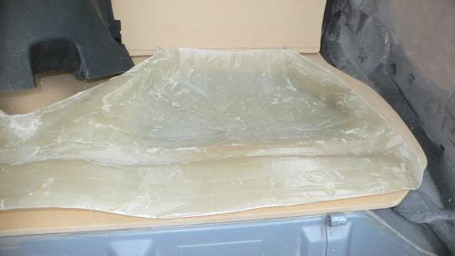

Update 11/07
Since having the car back from the bodyshop and having sorting a couple of money issues, I have began to sound deaden the entire car. I decided to go for a product called FatMat Extreme, for two reasons, first of being it rates well against Dyanmat and its also somewhat cheaper. So far Ive got the entire floor done, but I now need to get some more.

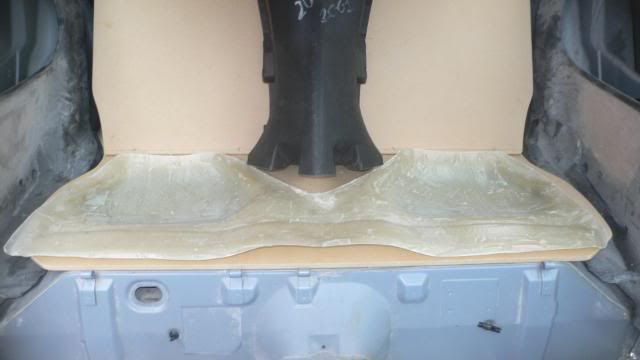

I have also began to build my cc rear bench into the car (not an easy job) After a couple of failed starts I have now come up with something that has worked well. Still a long way to go though.

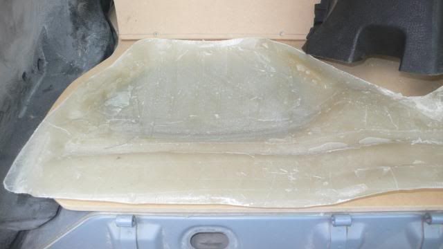

Created a fibreglass mould of the underside of the seat, to provide a level of support when your sit on the bench. I made the fibreglass reletivley thick to provide a great amount of strength.
I still Need to mount this secruly to the false floor.

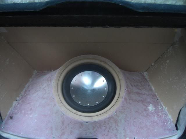

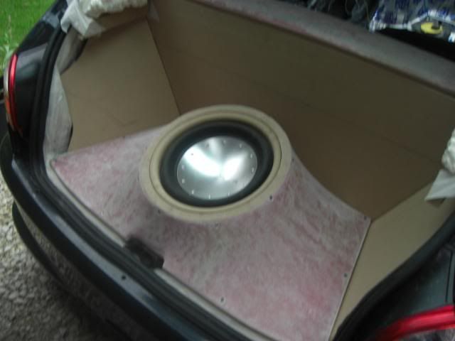

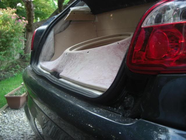

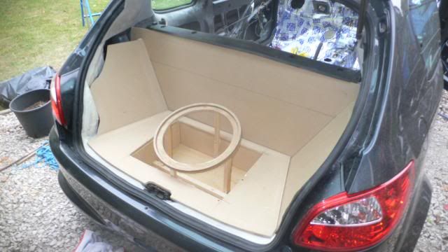

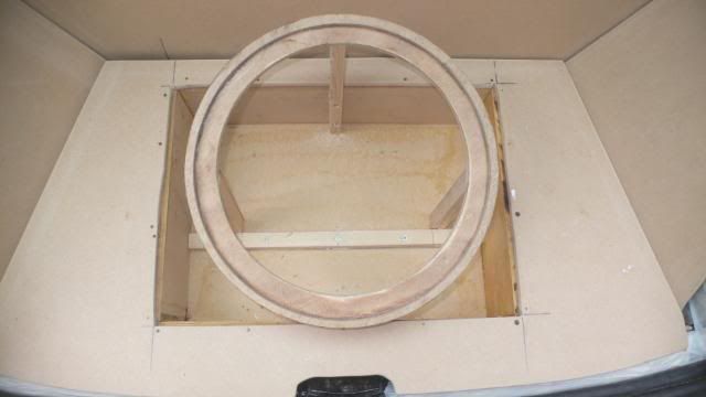

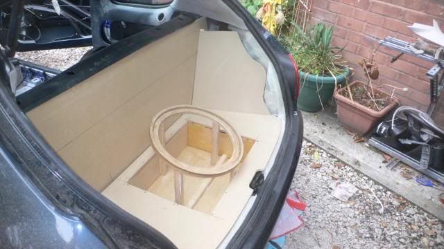

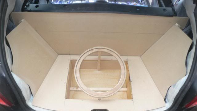

And finally I have began to build my boot install. Very simple desgin, only one sub on show. there is plenty of room behind the install walls to allow me to house my air tank & compressor, Additional battery, Computer and anything else that I need to house. The next stage is to fiberglass the edges of the mdf to cover all the bodywork (note I have taped up the metal work to allow me to apply the fiberglass) I also need to stratch a sheet over the sub enclose to give it its shape.

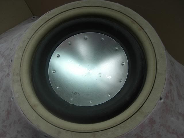

Also note that the speaker ring in the phots is one I use for mock up, I will be making one to house the sub that I will be using.

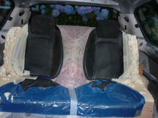

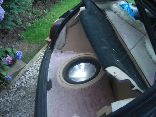

Update 08/08

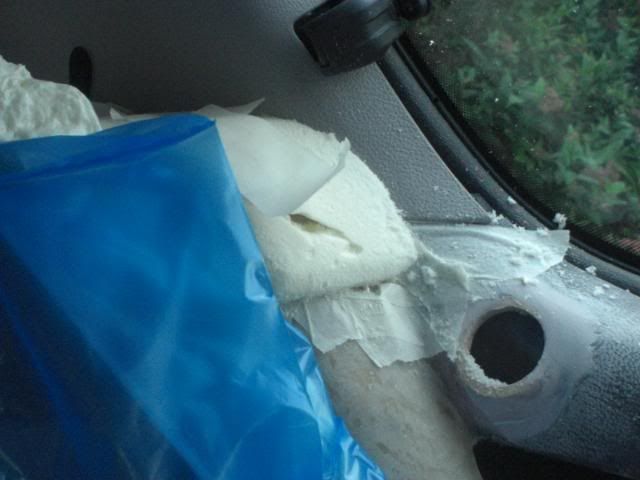

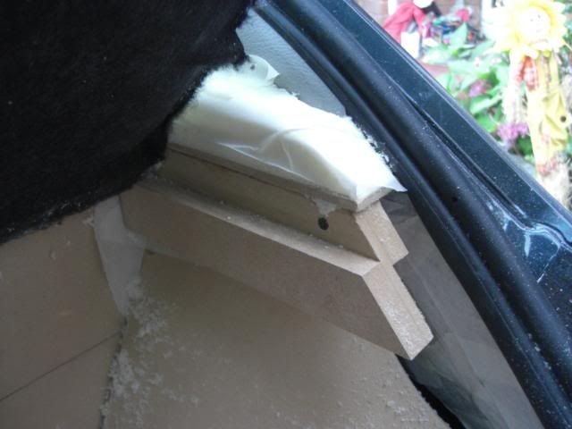

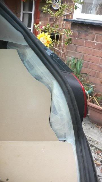

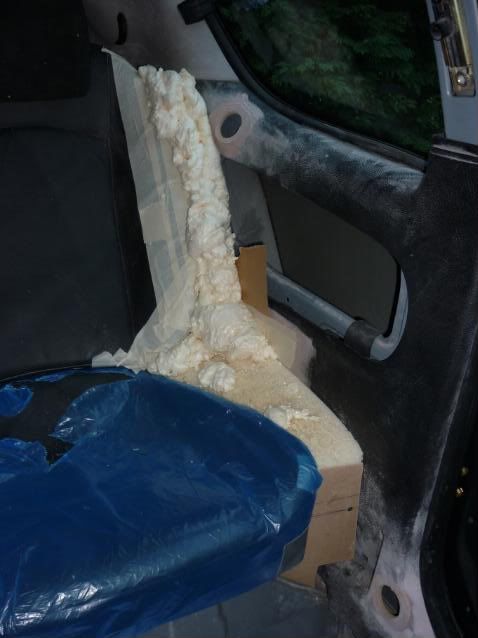

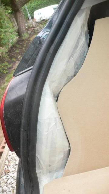

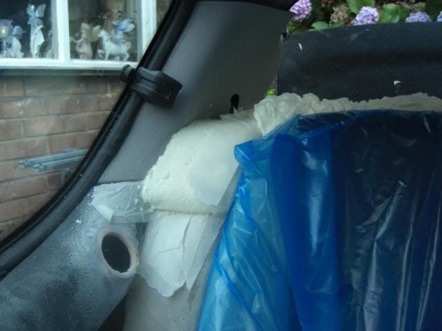

Well I have been busy working away getting the interior built. Since my last update I Have been working on the rear seat mouldings, which are coming together well. Nothing has had any filler appliied yet as I want to get all the fibreglass done then it will allow me to make any alterations I need to make.
Some pics of the foam work coming together.

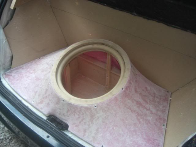

I have now applied the fibreglass but I havent got a pic of it as yet. I have also Fibreglassed the sub box.

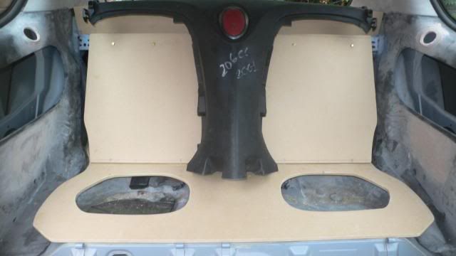

Currently working on the final peice of the rear seat mouldings
Pic with parcel shelf in.
Comments Welcome as always!!
