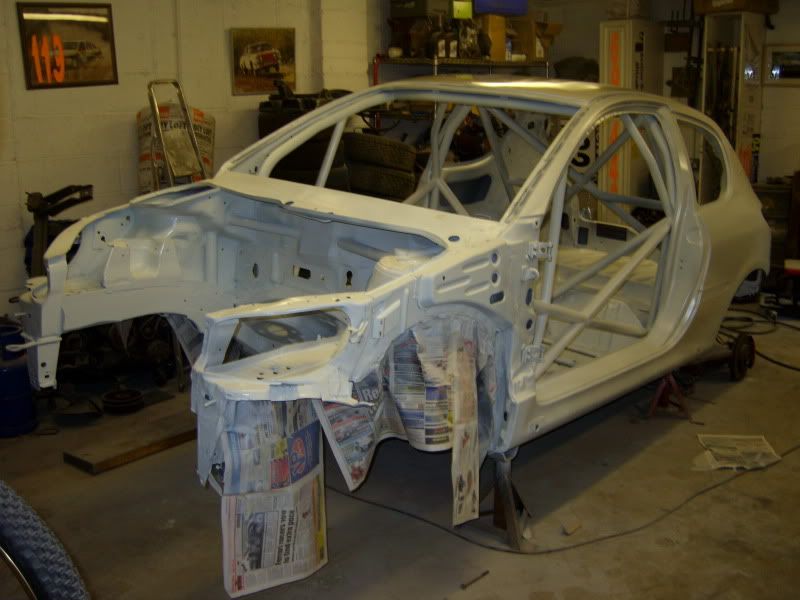

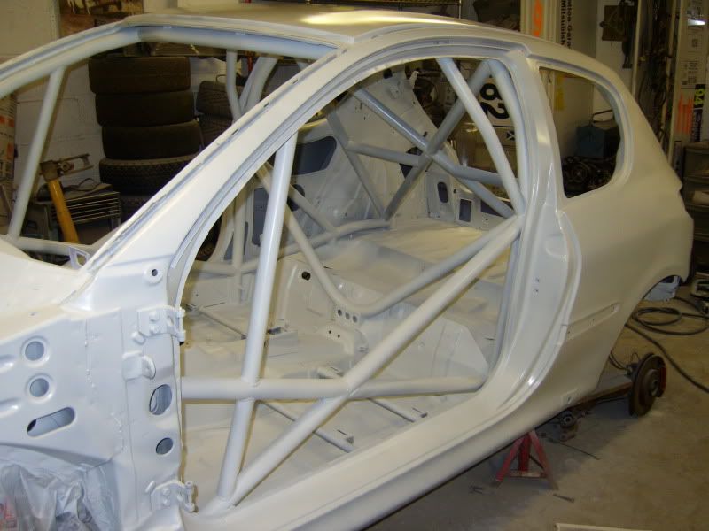

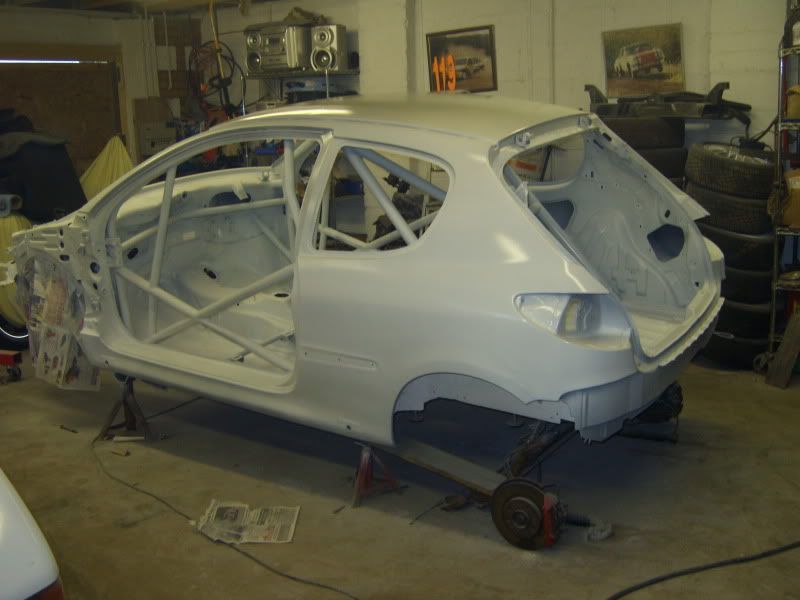

imjeeves
PostPosted: Sat Jul 17, 2010 8:48 pm Up
Posts: 405
Location: Glasgow / Welling

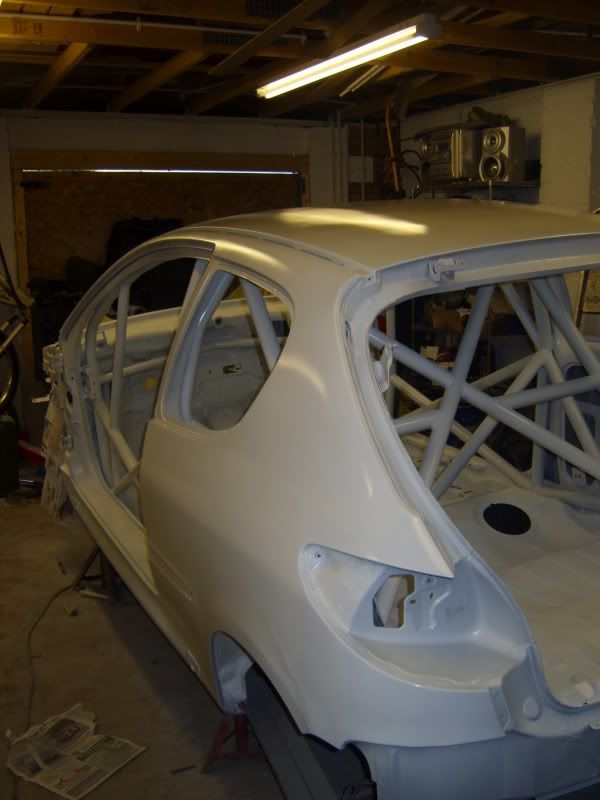

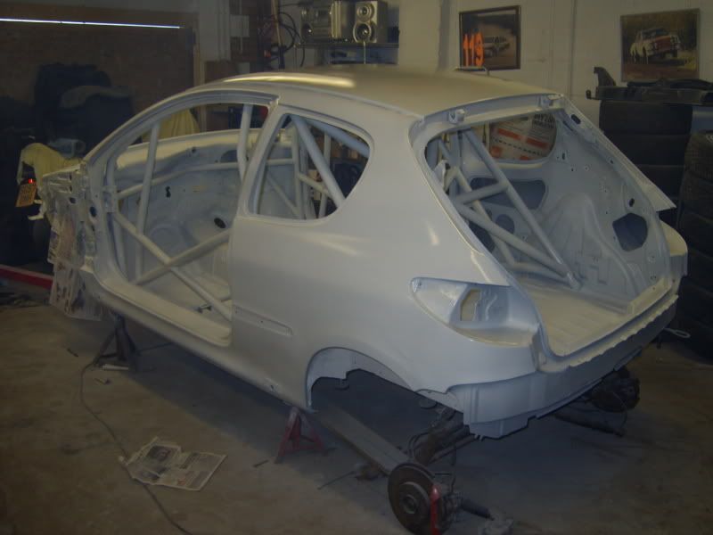

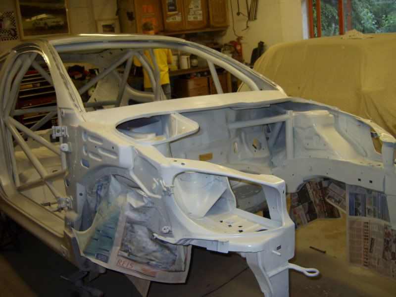

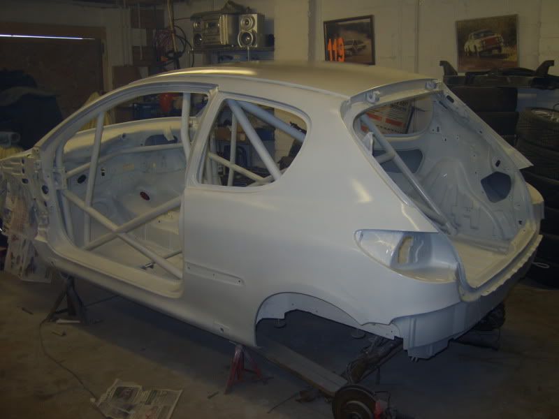

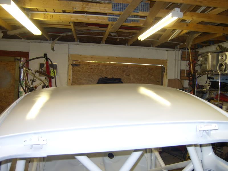

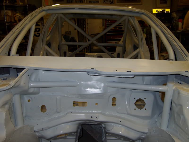

I decided to use emerald as my local tuner knows them best plus I have had good help when using them before.
Finished the paining tonight so here are the pics. Just need one final layer and then a good polish before i can start putting all the new bits in Smile
macj
PostPosted: Sun Jul 18, 2010 8:30 am Up
Posts: 3085
Looking good.... how long do think the build will take?
