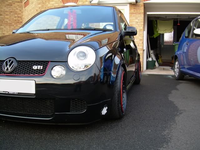

Ross
PostPosted: Thu Aug 19, 2010 12:06 pm Up
Posts: 932
A guy on Club Lupo ran 165/50/15's on an 8J rim...
www.tyrestretch.com/zp...=&q=85
Extreme to say the least, I think he was a bit scared of them himself so never really pushed it hard round corners. They never came off though. And for the record he now runs wider tyres.
I don't condone anything that extreme, but the point is, he ran them successfully so it shows how far you can potentially go I guess.
