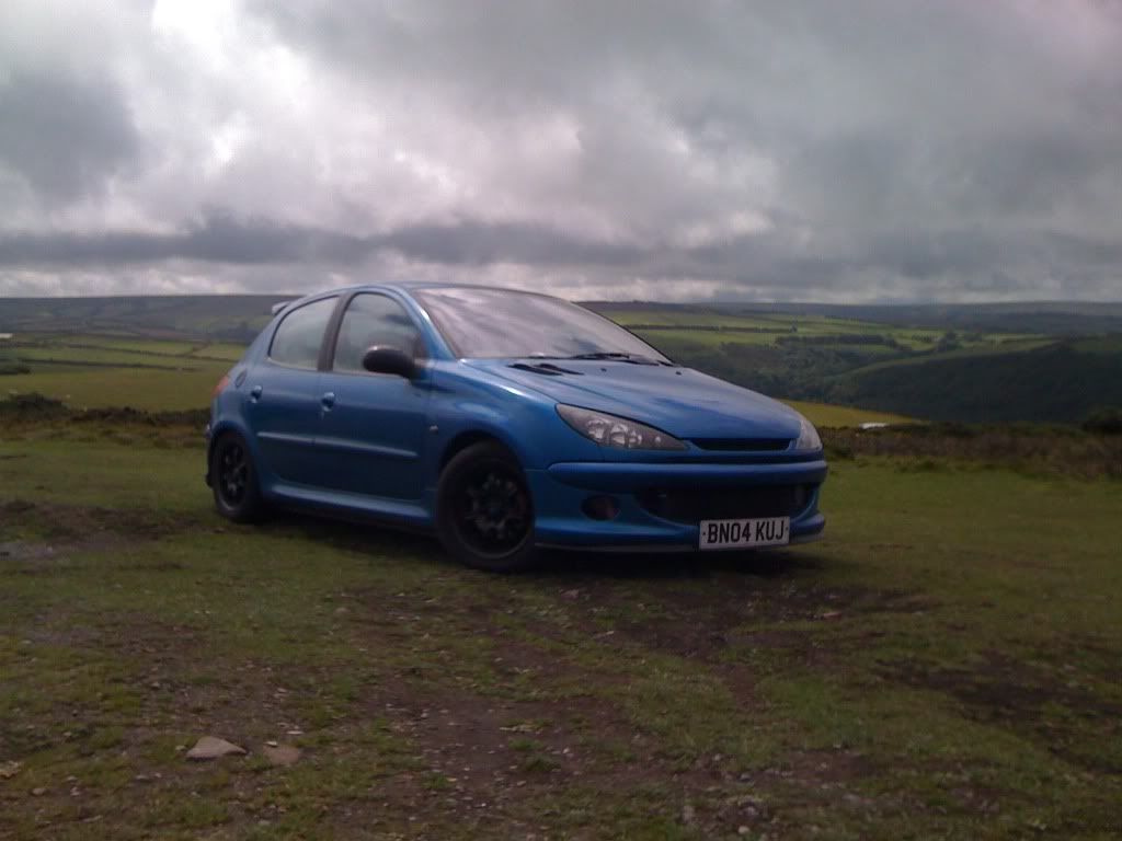

PostPosted: Mon Sep 13, 2010 3:28 pm Up
from what i can remeber i lowered this 60-70mm iirc Laughing

PostPosted: Mon Sep 13, 2010 3:45 pm Up
Posts: 2207
loved your 206 ben..... sorry its not still around on here Sad
