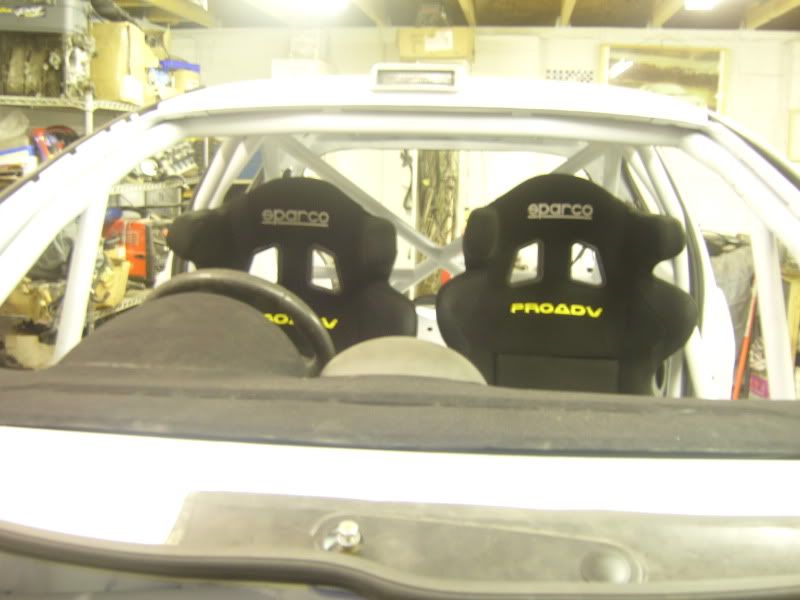

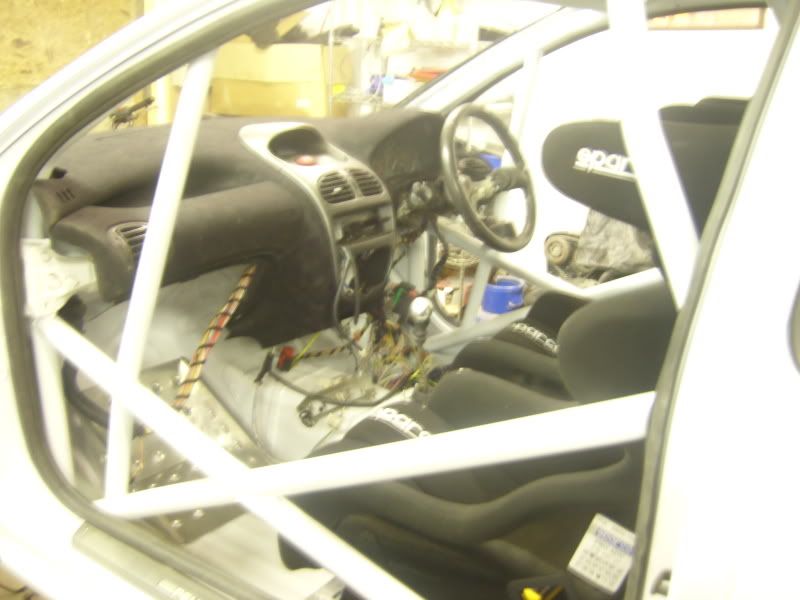

Wee update since its been a while.
Got my new seats and finished the wiring loom just needs fitted now.
Rear beam with peugeot sport solid mounts fitted.
Front suspension fitted with Peugeot sport suspension, grp a bottom arms, brembo 2 pot calipers.
Engines to go in this weekend hopefully and then its trying to get the throttle bodies set up.
