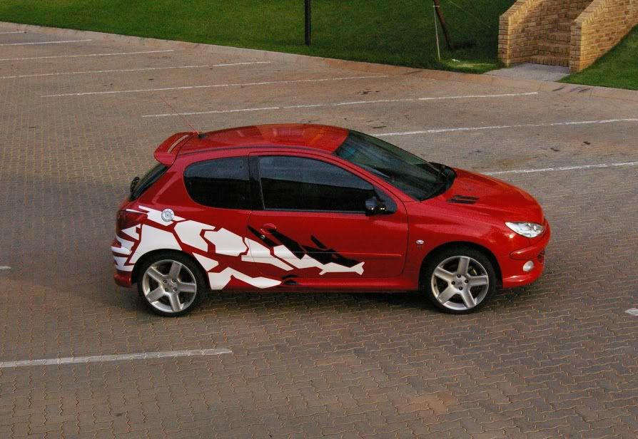

Anyways, my car is basically a standard Red 2006 GTi180 with a few little alterations..
And just a by the by, I LOOOOVE LED's..

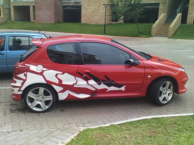

So anyway, here is my car.. I stole the Vinyl idea from NFS UG2, it was one of the level 2 flag designs, I cut and applied the vinyl myself as well..
So far besides the freeflow exhaust system I've only done visual alterations..

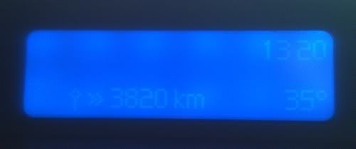

First off was changing the MFD to blue SMD LED's, unfortunately because of the kind of LCD that is used on the 2006 models it doesn't look as good as it did on my 04 model..
*04 model LCD*
*06 model LCD*
I've done the aircon display in blue and white as well, just dont have pics of it..

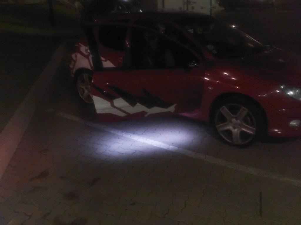

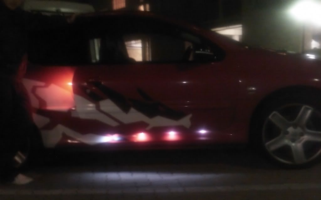

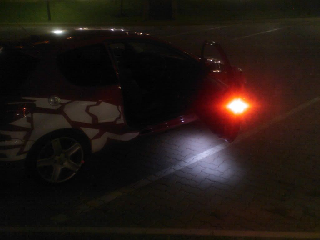

Next was the under door lights, unfortunately I haven't gotten a chance to do both doors because I ran out of LED's and only recently got a chance to buy more.

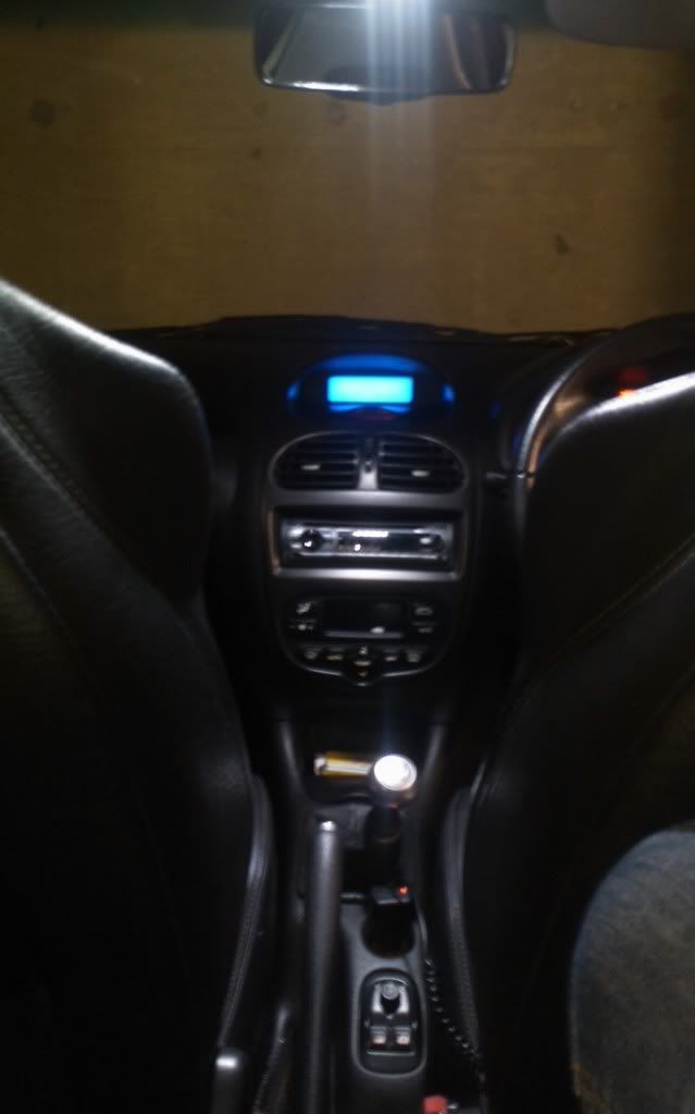

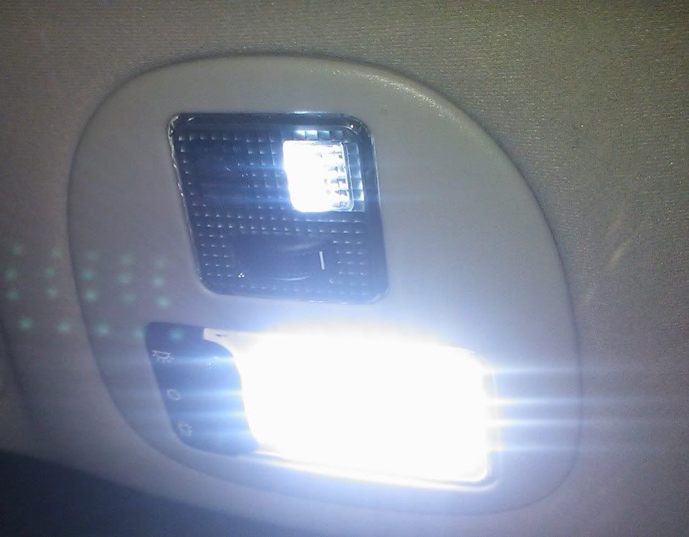

Theeen I changed the inside light and reading light.
I replaced the inside light with 20 LED's.. It's like daylight in the car now..

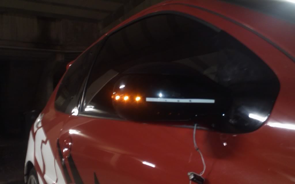

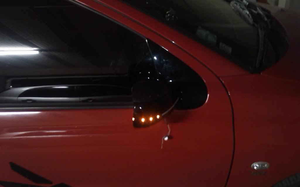

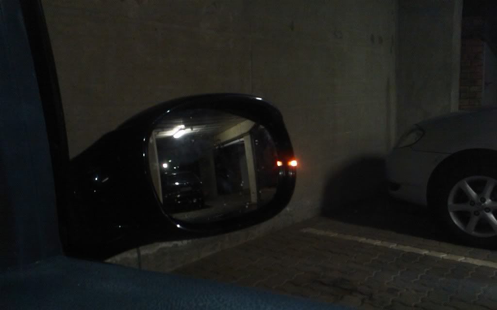

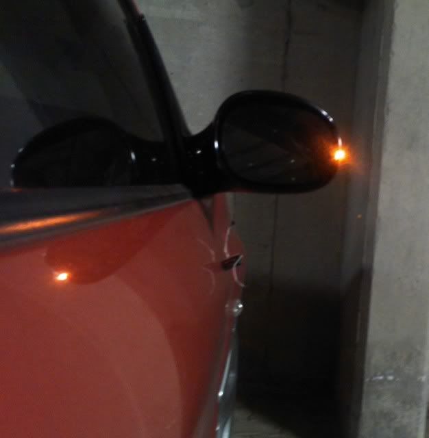

And now recently I'm working on my side mirror indicator.
The plan is to have 8 LED's that run in sequence across the mirror when indicating, I unfortuanately only had 4 LED's to use last night so I only have those in..
Will get the last of the components probably this weekend..
They dont look very bright because they running off of a little battery just to test.

Wow you do love your LED's!
Looking very nice mate. Would love to see how-to for the mirror LED's, I think that is great idea.

Looks nice i like some of the LED's not keen on the graphics though :/
Meh, it's not for everyone, it makes my car unique..

I like the under door lights. might have to do that. where did you wire them in?
-Kitsune-
PostPosted: Thu Oct 28, 2010 11:13 am Up
Posts: 111
Location: Johannesburg, South Africa
Wired straight to the live at the fuse box.. Got a reed switch on the door to detect when it's closed..

what LED's did you use for the under-door lighting dude? and where did you get them? I'm liking them alot Very Happy

PostPosted: Thu Oct 28, 2010 11:57 am Up
I was going to do puddle lights, bought all the stuff about a year ago and put all the wires in place, just can't be arsed to fit the lights Laughing
I don't like the interior light one bit, looks pretty ugly.
I'm liking the wing mirrors tho Smile Are you gunna have to use a PCB to get them to go in sequence?

@SAB Go here: [url=stores.ebay.com/HKJE-Led-Lamp-Center]HKJE LED[/url]
They're the 5mm super flux LED's, 25000mcd, dont get the 5 die LED's they have a green tinge to them and only double the brightness..
@Lee Yip! But it's a really simple transistor based circuit and you can add 2 LED's onto the string at a time..
Luckily there's enough space inside the mirror housing to put the PCB.
The pic of the inside light is with the cover off, lol it's in my boot, I took it off and haven't gotten a chance to put it back.. It looks OEM when the light is off and the cover is on..
Just not sure, I'm somehow going to have to get a constant feed from the indicators?

PostPosted: Thu Oct 28, 2010 2:58 pm Up
Can't you just piggy back the feed from the side repeater in the wing? Then if it needs like a constant +12v just take one from the fuse box
EDIT: infact, cant you get the +12v from the motor in the folding mirrors?

The problem is that the "Running LED's" need a constant DC supply otherwise it will just start off then turn off again with the repeater.. So I am going to have to think of something else..
I know there should be a simple solution just cant think of one right now..
Do you know if the indicators are driven by a relay still or if it's done in the BSI?

PostPosted: Thu Oct 28, 2010 3:19 pm Up
So you want them constantly on, and then flash with the indicators? Like side markers
Its a relay within the circuit in the BSI as far as i know.

Basically, I need it to be constantly on while the indicator is on, so it needs to be connected to the circuit before the switching relay..
Excuse me if I make absolutely no sense, really tired..
"in the BSI" Hmm, that was what I was afraid of.. I'm scared of that little box..
